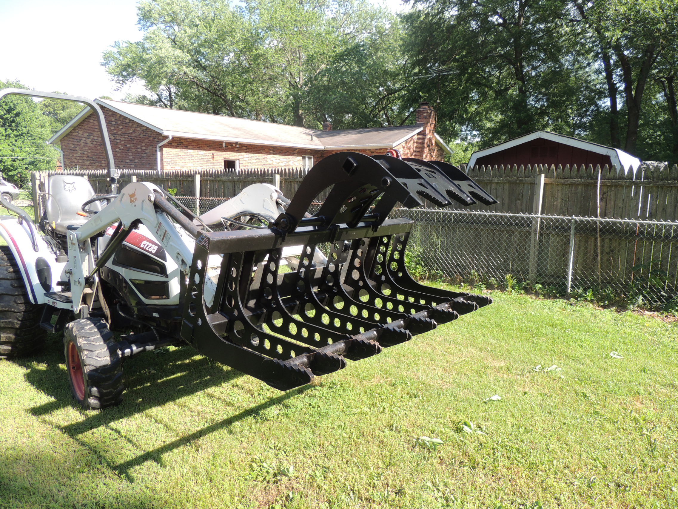

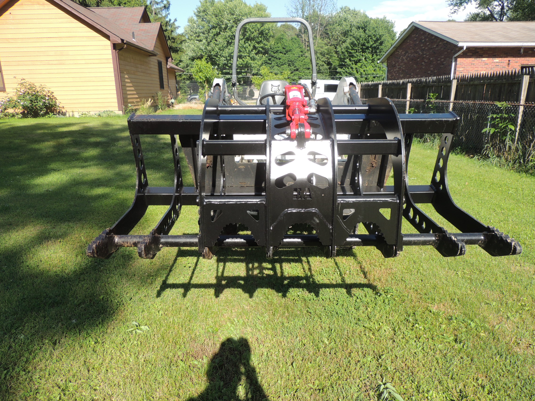

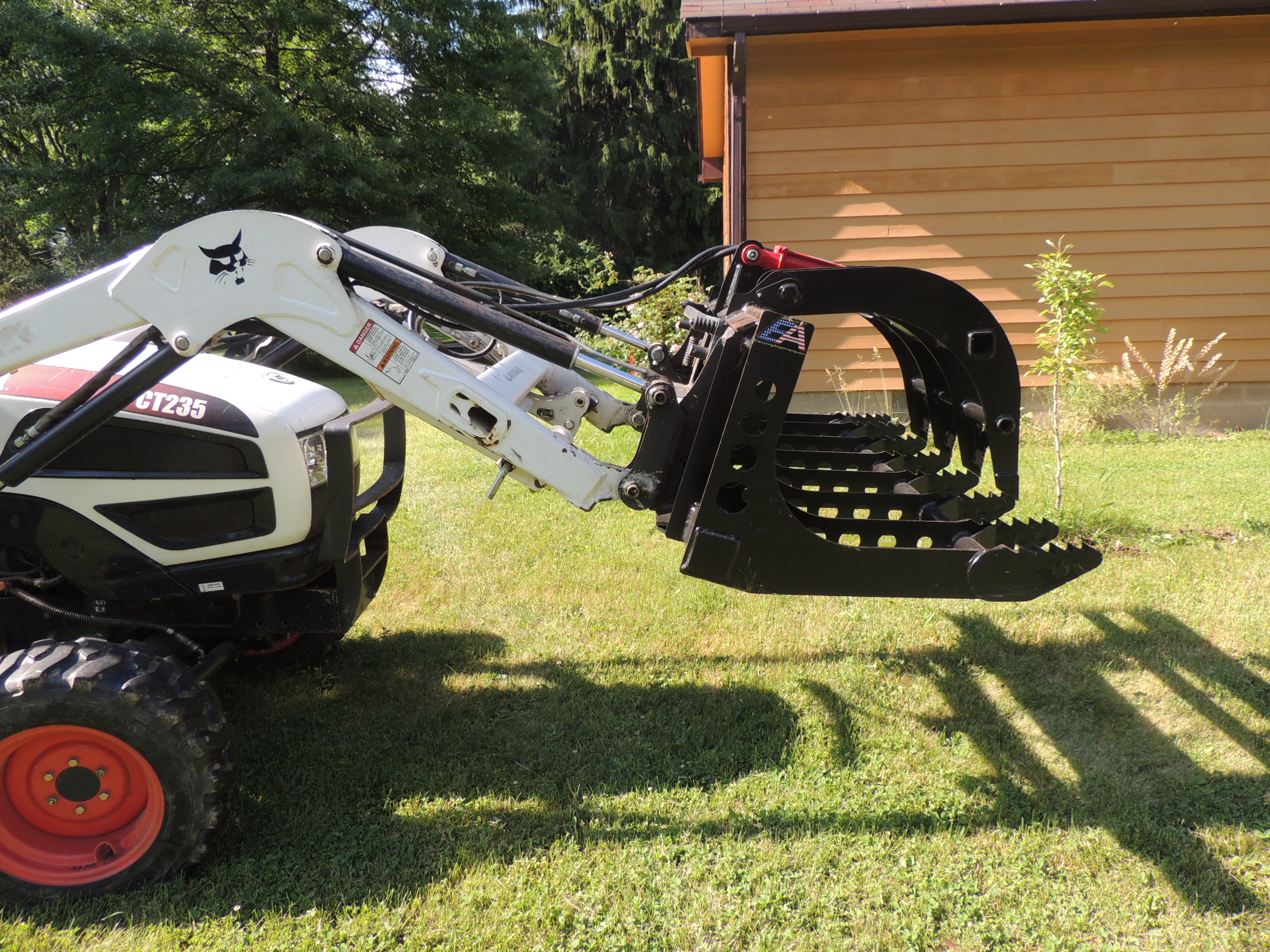

Well I finally got this job done. I picked up my new EA Grapple today. Installed it in about 10 minutes and went to work. Man this thing is a beast! Pulling up multi-flora roses like nothing to it. Piles of brush - no problem. I want to thank everyone who helped me along the way. When I started I wasn't even sure what a rear remote was. I got a lot of help from Brian at Fit-Rite Hydraulics and many members of TBN. Here are some pics of the new Grapple.Grapple #1.JPGGrapple #2.JPGGrapple #3.JPG

Wont work on a hay bale....well maybe destroy:thumbsup: it :D:laughing:
Looks like a great install.
