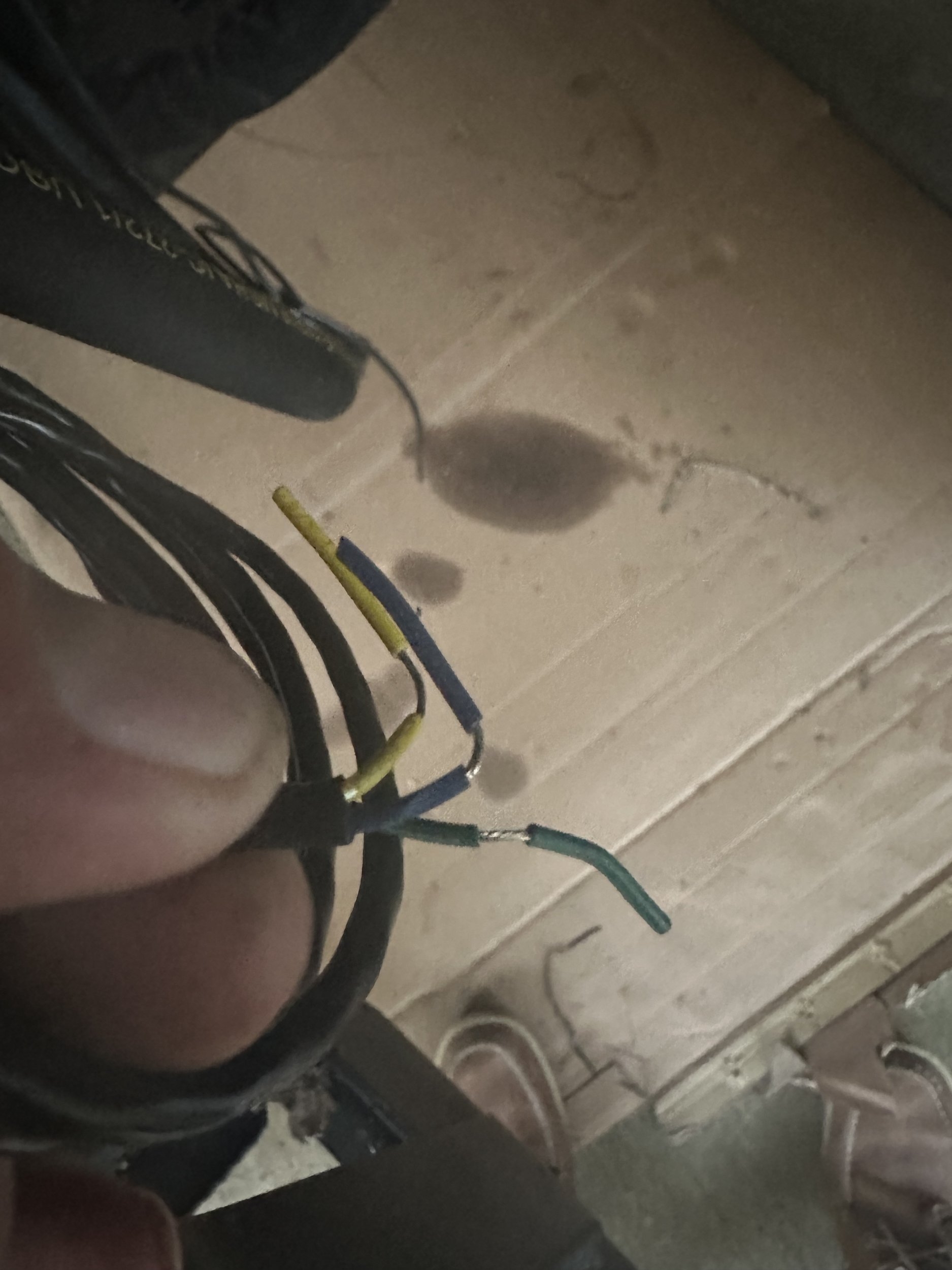

I have a 2023 Mahindra 6075 and purchased a WL Long third function kit but keeping Mahindra joystick 2 button controls.
Where can I access the pre-ran wiring for the 2 buttons on the joystick?

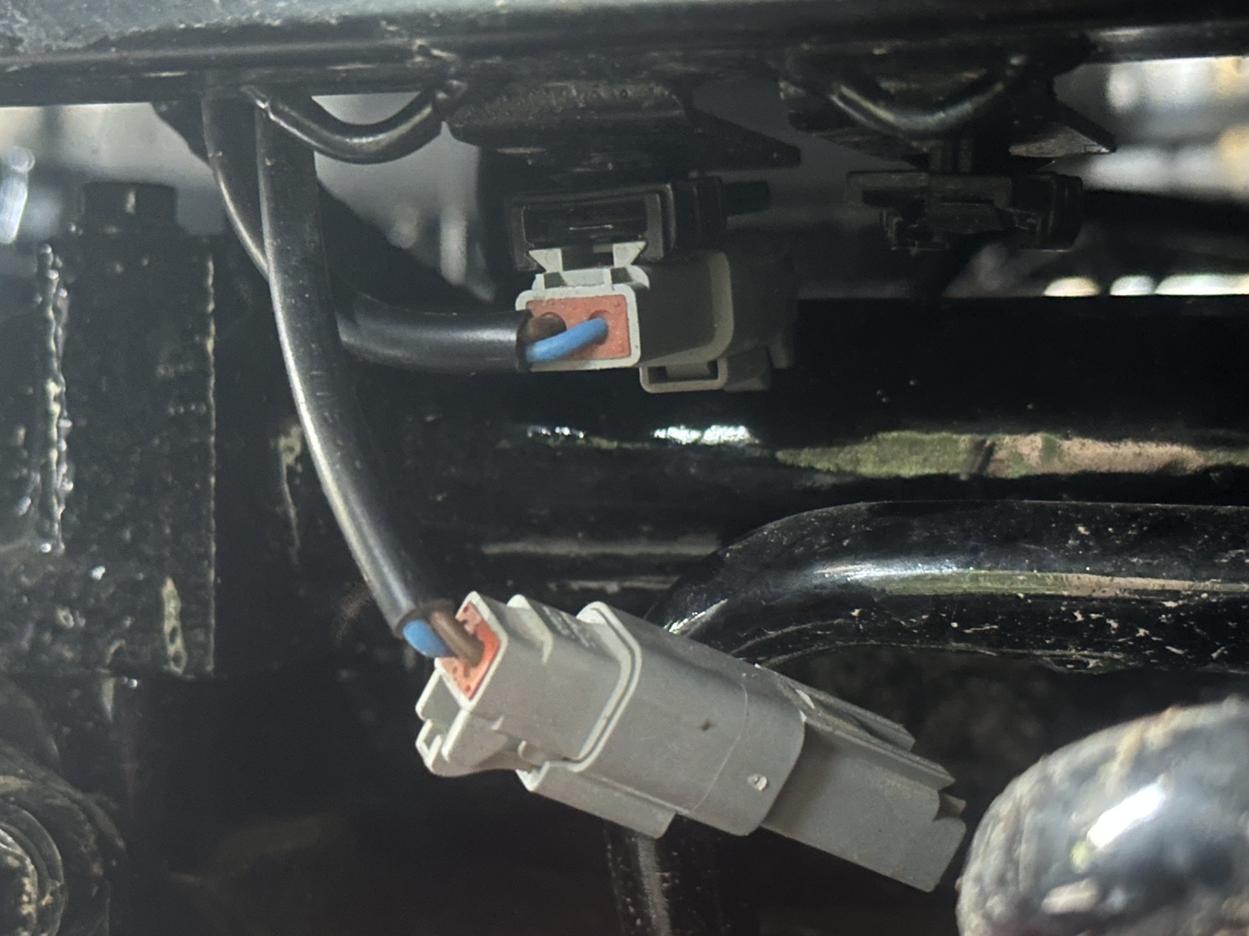

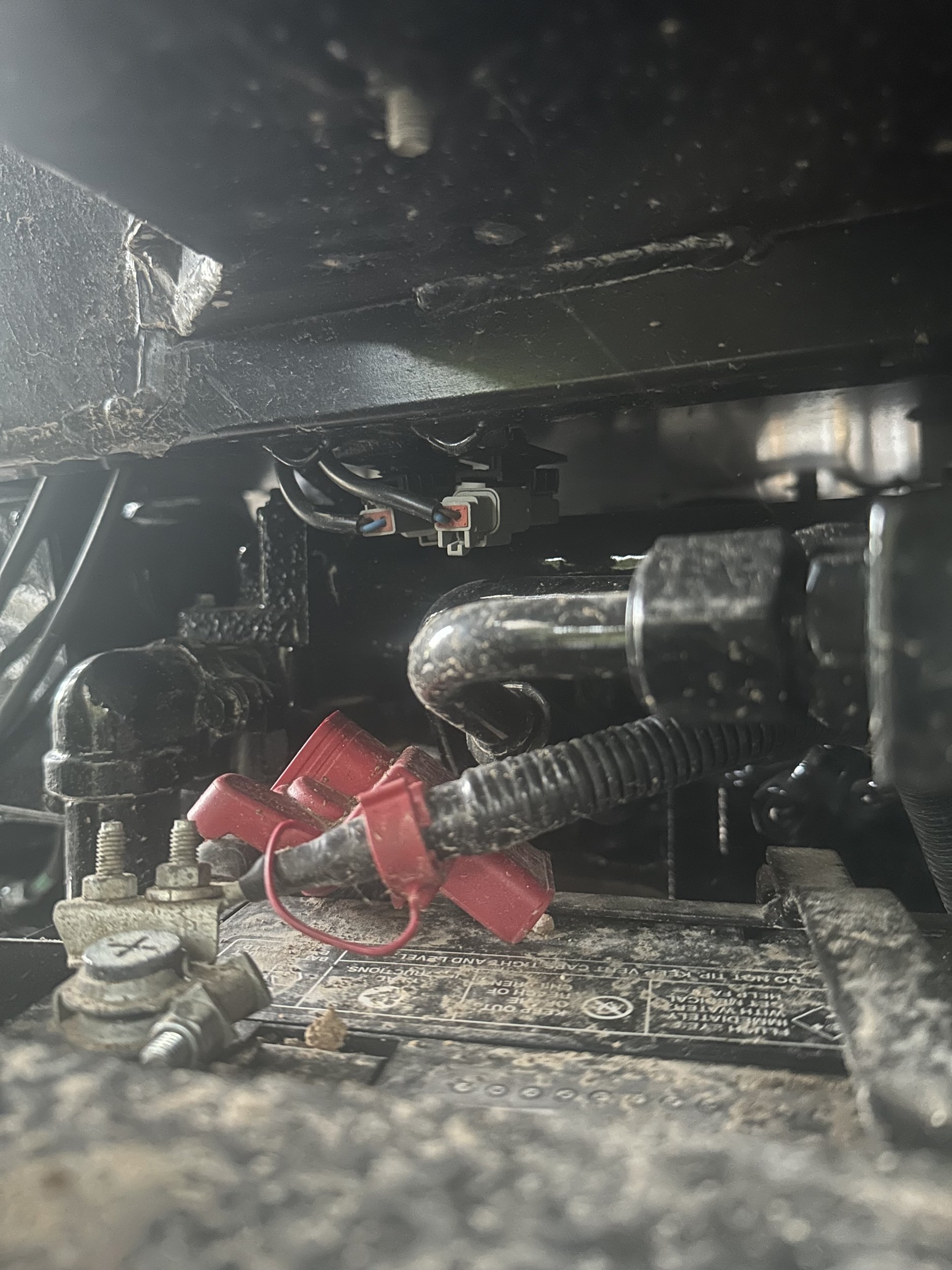

There are 2 unused deutsch connectors with each connector having one blue and one brown wire located under the cab and above the battery.
Are these the wires that should be used to connect to my WL Long solenoid kit?
If yes, how should they be connected?
The WL Long kit has 3 wires that are to be connected to the joystick switches, one blue, one green, and one yellow.
Can anyone advise, help me?
Thanks

put a continuity tester between one of the wires and ground, then push the buttons, that will tell you what you want to know.
edit between the 2 wires in each set not ground and the wires

if they are the wires from the buttons on the joystick, this will confirm it as well as identify which is the up and which is the down.
or do you want me to elaborate on the procedure?
I'm assuming that the OP has some DIY experience, I could be wrong.
anyway not trying to be a smart @$$
as to how to connect the wires, each set is most likely the terminals of a NO switch so when the buttons are pushed the circuit closes (the continuity tester will confirm this) one wire out of each set should be connected together to the common wire from the WL kit (there should be a wiring diagram in the kit) the 2 remaining wires go to the open and close wires from the kit.
if the OP will post a photo of the wiring diagram from the WL kit i will attempt to help.
