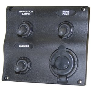

Ooohhhh.... now this is downright sexy. Switches and a 12-volt port in the same box.
http://www.amazon.com/Seasense-Marine-Way-Switch-Panel/dp/B002VHWLP2/ref=cm_cr_pr_product_top
If the lights are 55 watts each, and I put two of them on a single switch (two forward, two back, at most), that's about 10 amps. Given that the switches are rated for 20 amps (with 15 amp fuses), I should not need to bother using a relay, right?
The aux lighting lead that is at the back of the tractor appears to be quite a small gauge of wire. I'm guessing it's only intended for the backup light. This box could, in theory, pull 15 amps X 4 = 60 amps. Realistically, my alternator would give out before that happened. It looks like 12 gauge can go 10 feet at 50 amps/12 volts, so it seems like the right thing to do would be to pull a 12 gauge line directly off the battery's positive terminal and run it back to the switch box. That should handle as much amp draw as I'm likely to pull, given the current alternator (pun intended).
Although the switch box is fused, it is probably good practice to put a fuse right at the battery terminal--or is that not necessary? I have seen other examples where that has been done, but at the same time, the tractor's own electronics all run to the fuse box under the dash. Their wiring between the battery and the fuse box is just as exposed as mine would be. What's the difference?

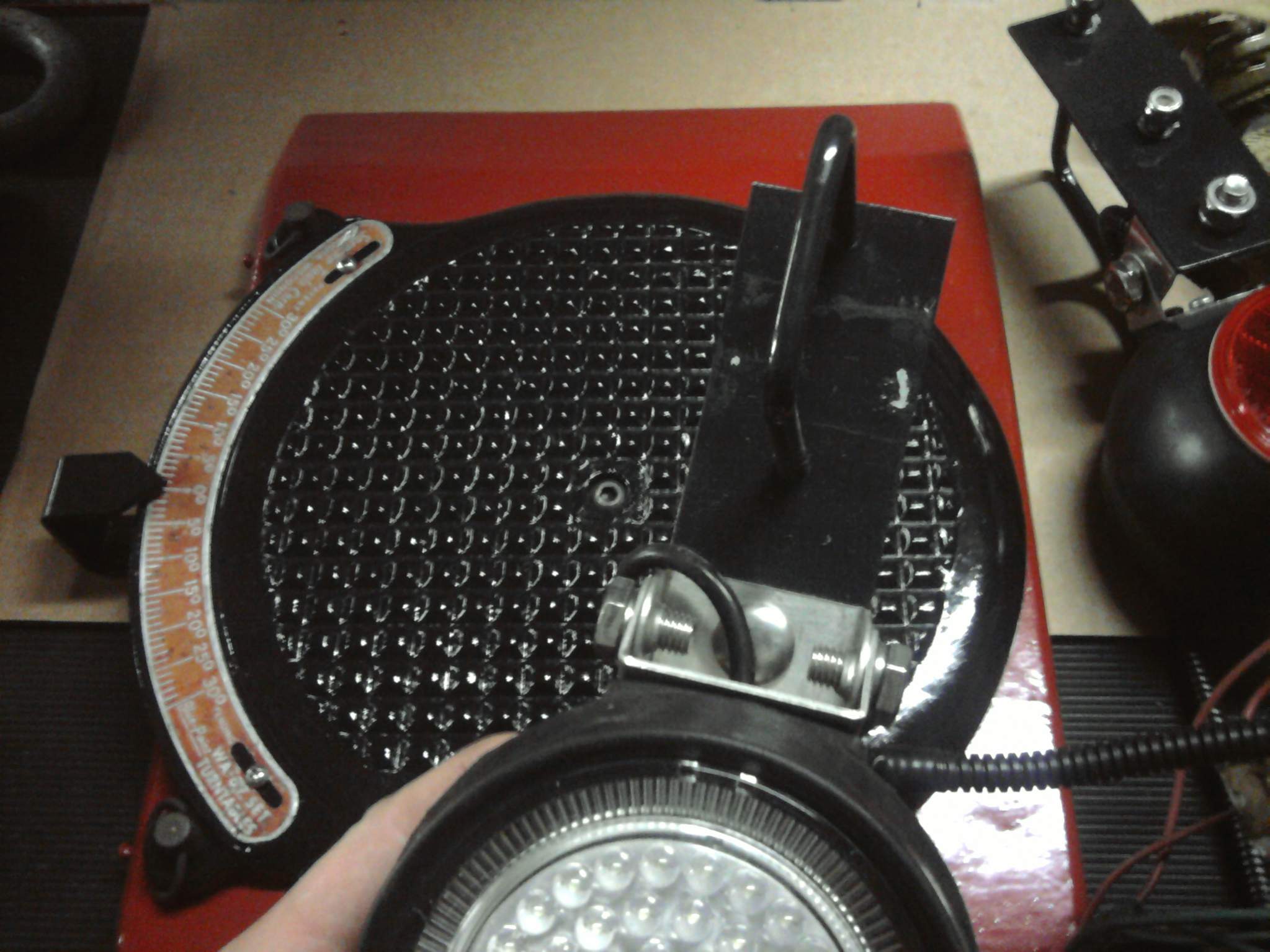

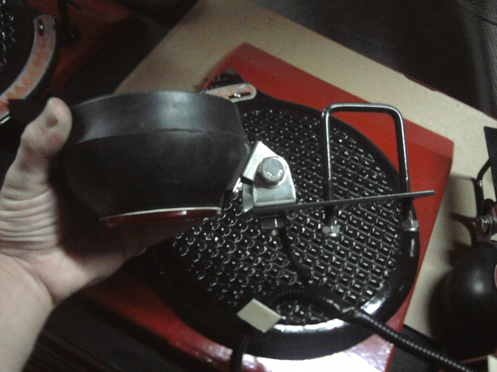

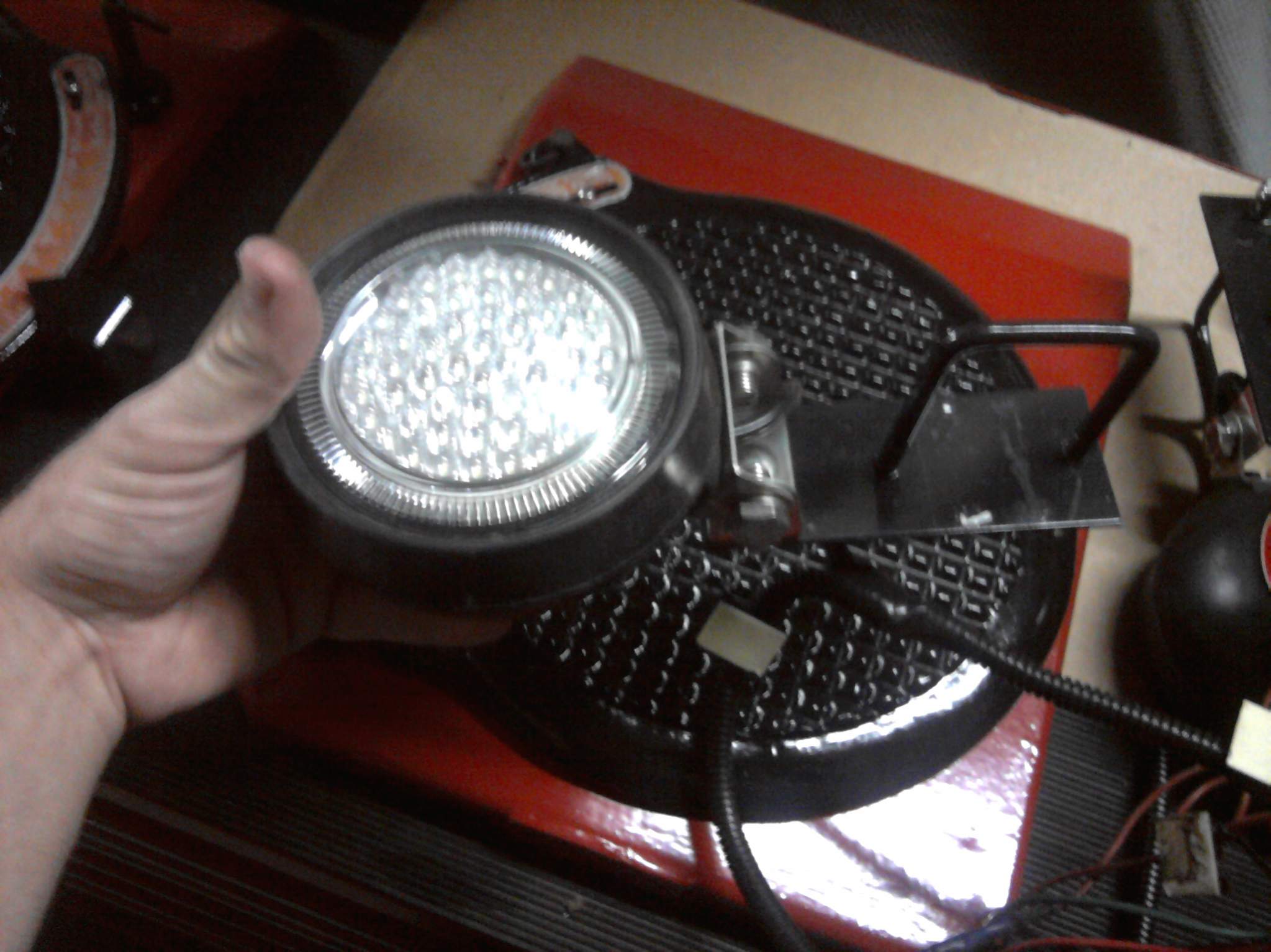

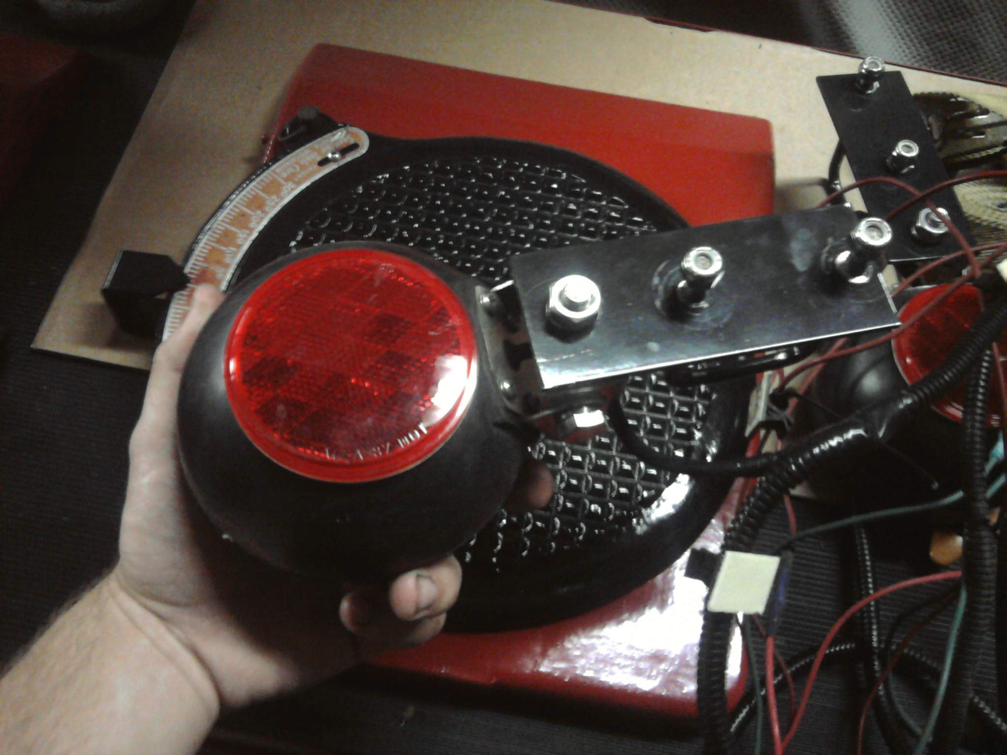

   / CT225 alternator capacity #13
There is a plug in the dash below iginition switch pop it out and you can get a universal headlight switch from the auto parts store that will go right in it with no drilling. I mounted a couple of these on my rops. Both of these light draws around 1 amp if I remember correctly. I got some u bolts from the hardware store. I had a piece of aluminum a drilled holes init to fit the u bolt and a whole for the light.

No the plug is below the ignition switch on the right side. The hole your are talking about is for a sst tractor shifter handle. Those lights where good enough for a tractor at 5 or 10mph. I'll take a picture of my bracket I had on my ct235.

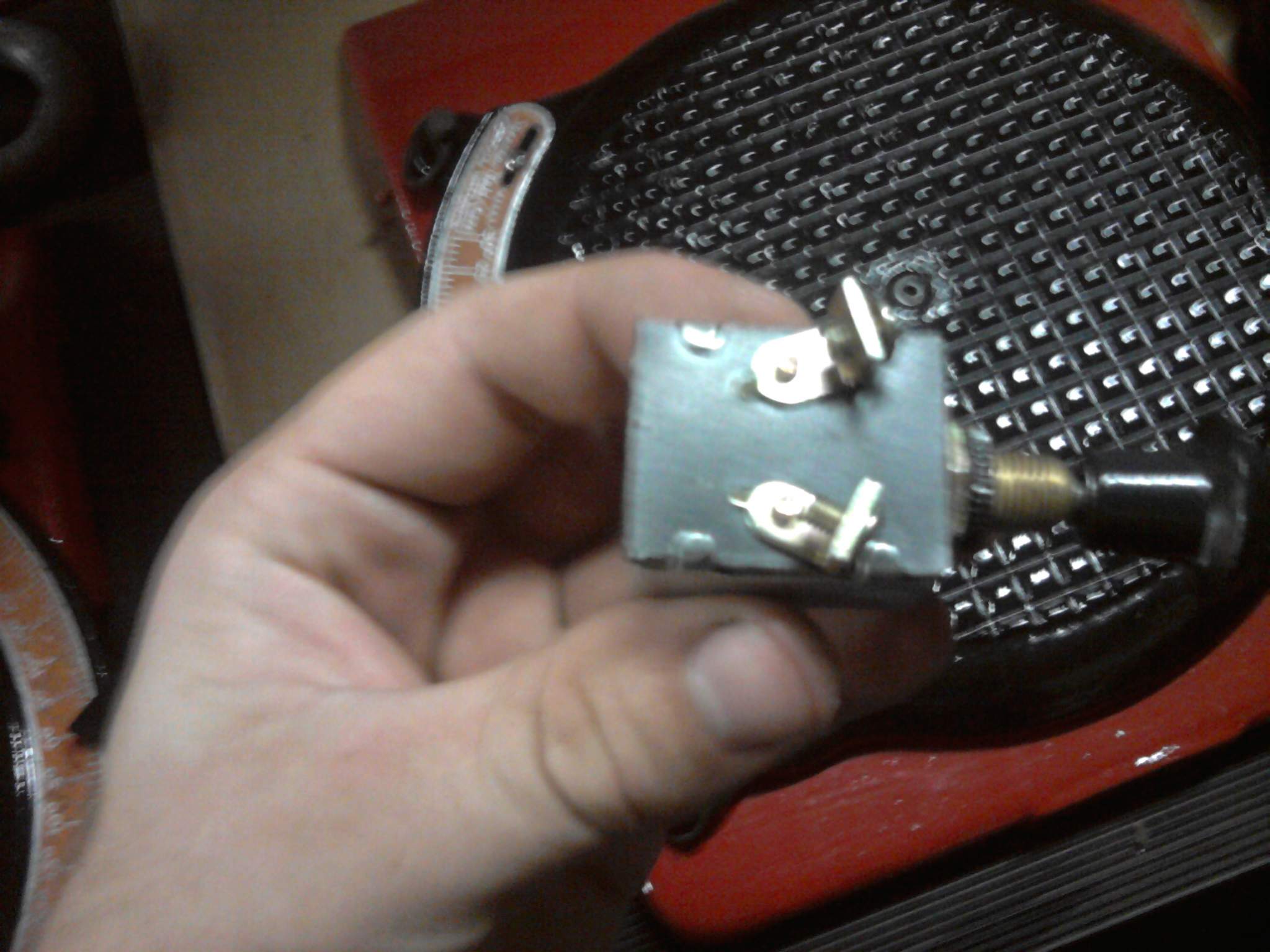

Here are some pics of the bracket and switch. I think this is the switch I used. Be sure however you hook it up it is fused. If you don't go with leds you will need a relay. For a fuse you can use a fuse tap or get a switch with a built in fuse.
Tell me more about the relay, please? I have found plenty of switches that are rated for 10-15 amps or more. If the circuit pulls less than that, do I still need a relay?
   / CT225 alternator capacity #19
If you are not going with leds you will need a realy. You buy a harness kit with a wire, switch and relay.
