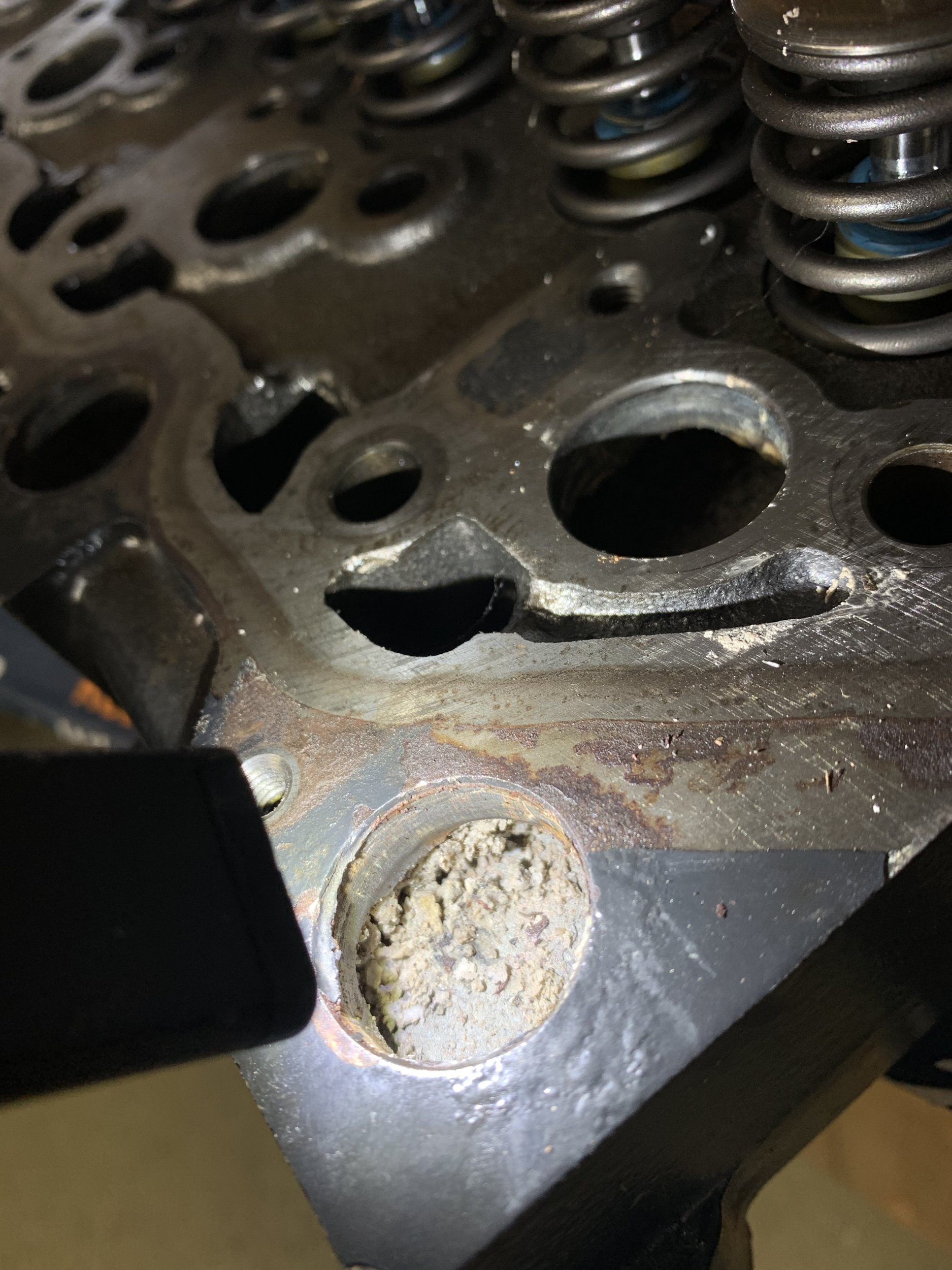

I was able to find the head gasket ($65) and the head bolts ($130) at a Koti dealer about an hour from my house. I was also found that a bobcat dealer near the Kioti dealer had the core plug in stick for $4.
I am on the fence about reusing the head botls and gasket. They have about 10 minutes of run time on them and I very well could get it all back together and discover the block is cracked. On the other hand, I could snap off an already yielded bolt in the head and curse myself about being cheap when I am grabbing the drill and easy-outs.....

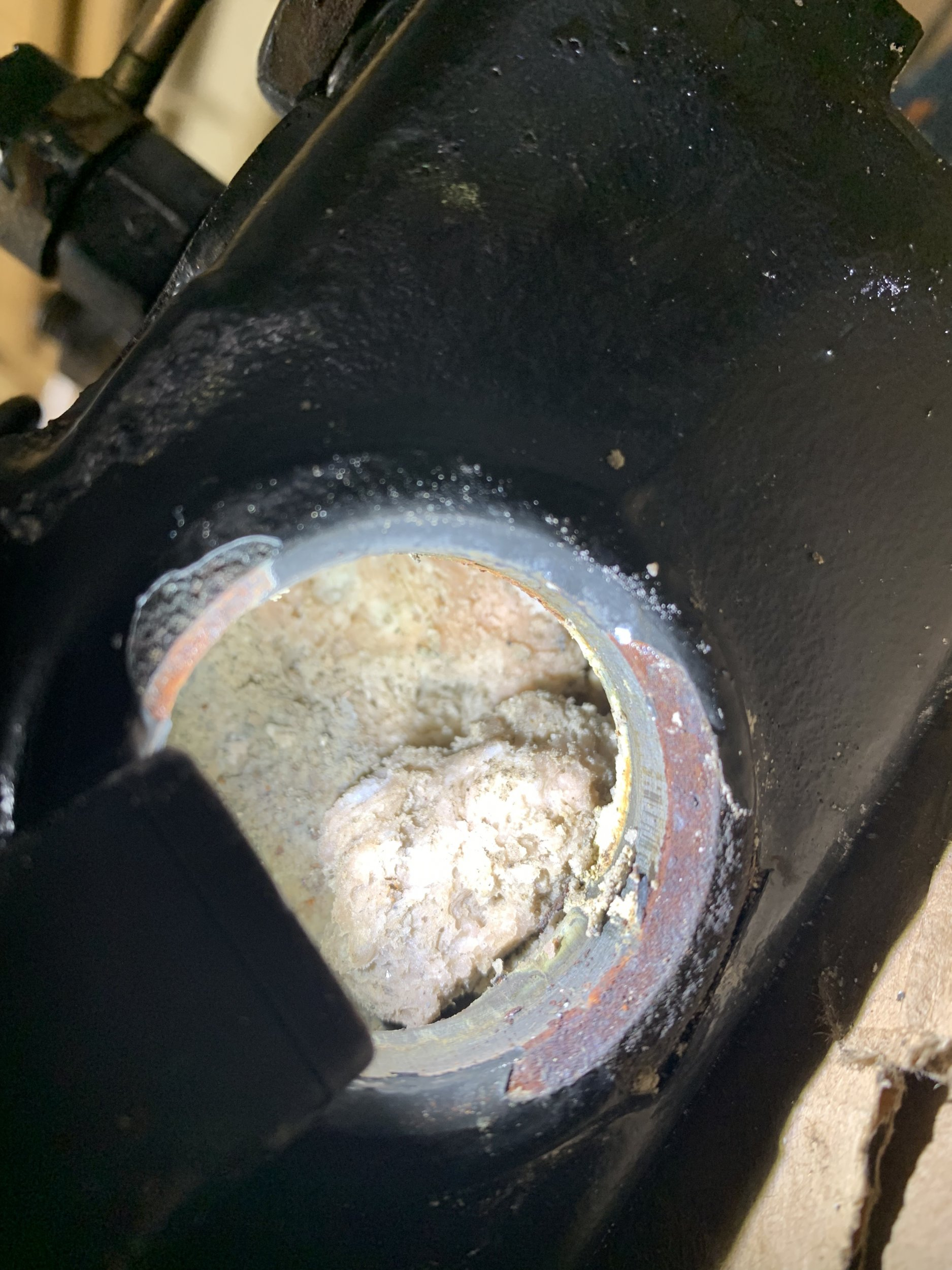

I question if the head actually froze, it seems odd that it went from frozen solid enough that it pushed the core plug out to completely thawed a few hours later. I know when I installed the plug, it made me uneasy how little the resistance was. I suppose the radiator would be the first thing to freeze and crack, I will know once I get it back together. I hope not, I had over 700 in the radiator recore alone! It some strange way, I would rather find out this last problem was my fault!
If mine I would assume the freeze plug is metric given the manufacture of the unit. I would use a caliper and measure the hole in the head. (If you do not have a caliper, Harbor Freight sells a digital caliper for 20-25 dollars.) I would also insure the freeze plug was metric and not American Standard they are different. I would measure the freeze plug and make sure it was 4-5 thousands larger than the hole on the head. Heat and cool down contraction will make a too small freeze plug pop out.
Some freeze plug specs calls for a .008 thousand size difference between block and head hole size. See if a Unit manufacturing dealer service department can provide the thousandth size difference the hole in the head and the freeze plug.
If that fails buy the freeze plug from a Dealer using the factory provided part number for the rear freeze plug. Also don't assume the front and rear freeze plugs for the head are the same size.

I did buy an OEM plug from the Bobcat dealer, when I held it up to the old one, they were close. I decided to goop it up a little heavier with the RTV and tap it in. I figured if it whet in too easy again, I would pull it out. I work in a machine shop, so I would bring it in and have one of the lathe operators turn me a custom plug. Alas, when I put the plug in it felt normal.

Freeze plugs are made to install without coating with RTV or any other sealer. They are force fit. Purchase the correct freeze plug for your cylinder head. Put it the freezer and leave overnight. Clean but do not enlarge the freeze plug hole in the head. Prior to placing the freeze plug in the freezer locate a deep well socket that will just fit inside the freeze plug.
Remove the freeze plug from the freezer and immediately insert the socket that fits inside the freeze plug and use a hammer tap the frozen freeze plug into the inlet for it until the edge of the freeze plug is aligned with the hole in the cylinder head.
