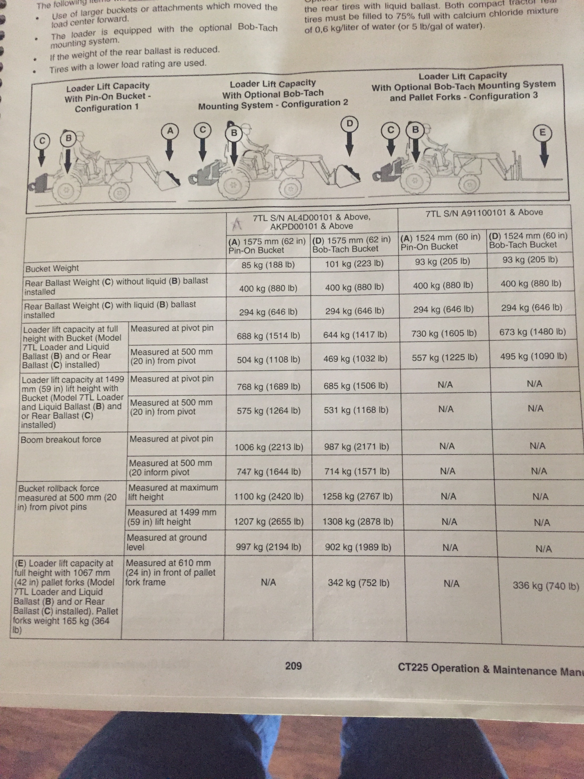

   / CT225 LIFT POWER #18
Here's a picture of the loader specs.
I was just thinking there are two different style loaders for these tractors and they're both called 7TL's. The older ones are more of a curve shaped boom the newer ones have more of a sharp angle. The curved ones were made by rhino and the ones with the sharper angle are made by bobcat and are a little stronger according to the spec sheet.
   / CT225 LIFT POWER
#19
That could be a why there's a difference.
I need to check my serial number thank you.
That helps!
