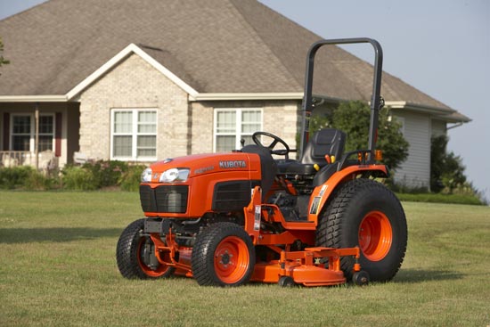

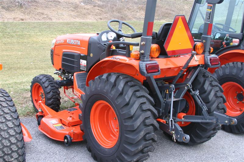

Both mowers I'm referring to are mid mount, 66" for the Bobcat & 72" for the Kubota. Kubota calls there deck mounting method "floating" but then says cutting height is ajusted buy guage wheels. This is confusing to me because I've seen both (see thumbnails) on Kubota tractors but neither the web site or my dealer could tell me much about it.

the older kubota b-series were a 'traditional' MMM - when cutting, they rode on their own ground engaging guide wheels. the new (2009? 2008?) b-series use a floating deck supported by the tractor. there are anti-scalp wheels on them, but the weight of the deck does not rest on them in 'normal' operation. the BX's have been using the 'floating' design from the beginning so far as i understand it.
