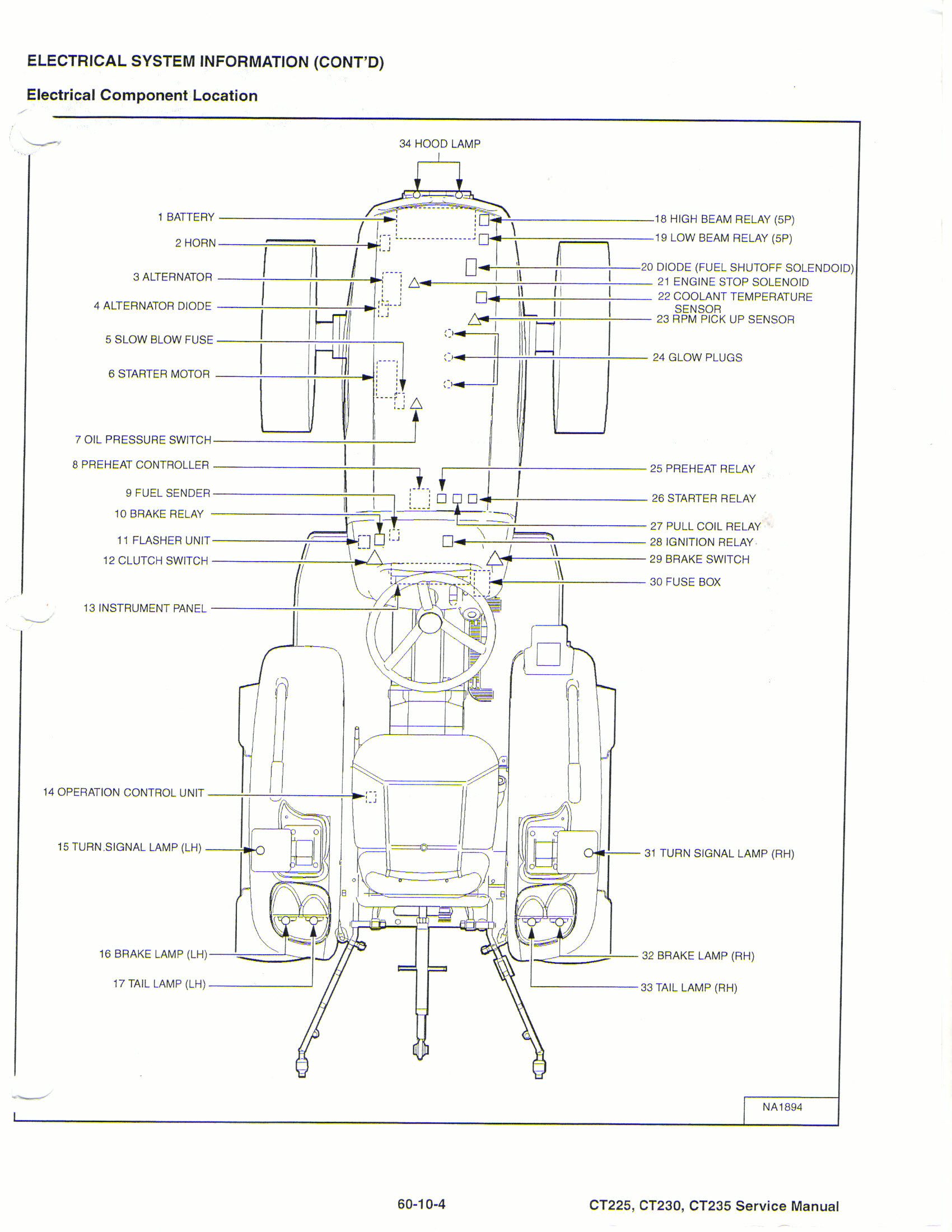

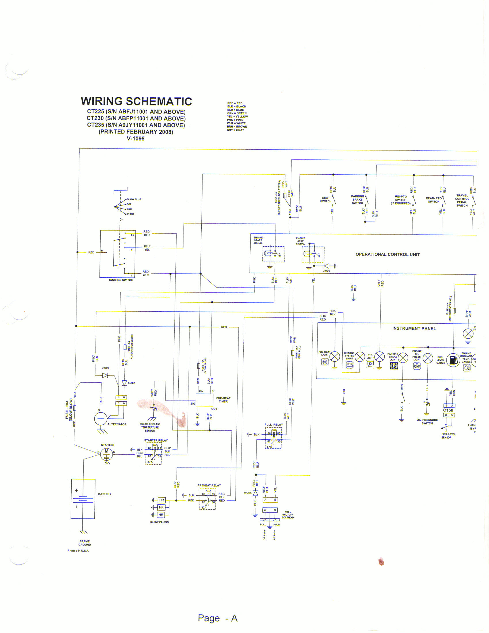

Hi, bushhogging about dark last night & all sudden tractor died of course out in far end field. Fuel & not overheated. Called it day. No noise when turn key to run or try start. Horn works, glow plug comes on, battery charge good. Was hoping not fuel injector as when died it was like ran out fuel. This morning Checking fuses found the 5 amp fuse 7 for operational control unit/switched power relay was blown. Put in new fuse & it started but promptly blew the fuse again. Guess need to trace the wires around find where issue is. Any pointers as don't have workshop manual or is here a wiring diagram online somewhere? First check was wires going to the round unit that is attached four bolts with wires going through it (not sure what called--proper name appreciated) on top left side (sitting on tractor) that has a plug harness which mice worked on in past but I can find no damage to wires themselves right now & insulation on wires seems intact. Is there a usual location for problems as it seems this could be major time consumer tracking around with this issue? Hoping easy find as don't have time to be tracing every wire on this thing especially since in bundle sheathing. Seems looking for short damaged wire vs a connector issue--is that correct assumption? Give me mechanical issue any day over electrical gremlins!
Any input appreciated even a work around to get it back up where easier work on! Thanks

Thank you! Got neighbor to steer the tractor while I towed it up to house where easier/more convenient to work on. Will check on that seat wiring in am if not raining. It is very likely the cause as I tend to have lots of stuff get stored around the seat. Will post back if find that to be the resolution. Keeping fingers crossed its that simple!

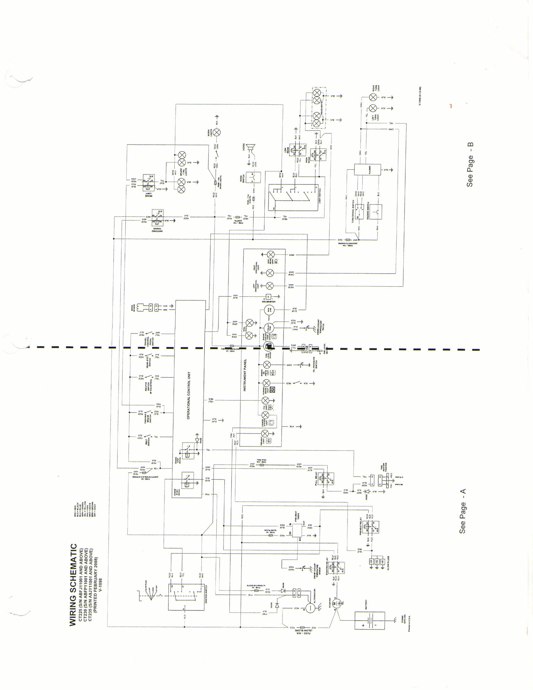

Update. Yip, wire connector going through grommet to the light on the back from harness under seat. The grommet had slipped & allowed wire to chafe against the metal. Taped wire up good & wrapped that whole end with so much tape hardly fit through the grommet. Looking at that set wires looks like I had to tape up a problem in the past. Didn't blow a fuse then or think would have remembered. Probably was trying find places when it was no start but ended up being the under hydropedal sensor. So guess memory failed me.
So if your fuse blows check the wiring of that harness under the seat.
Thanks again!
