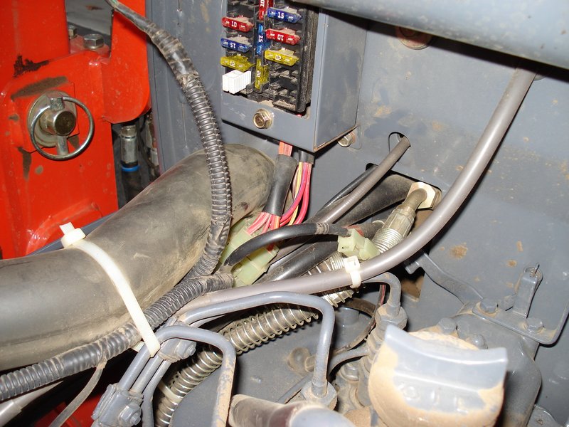

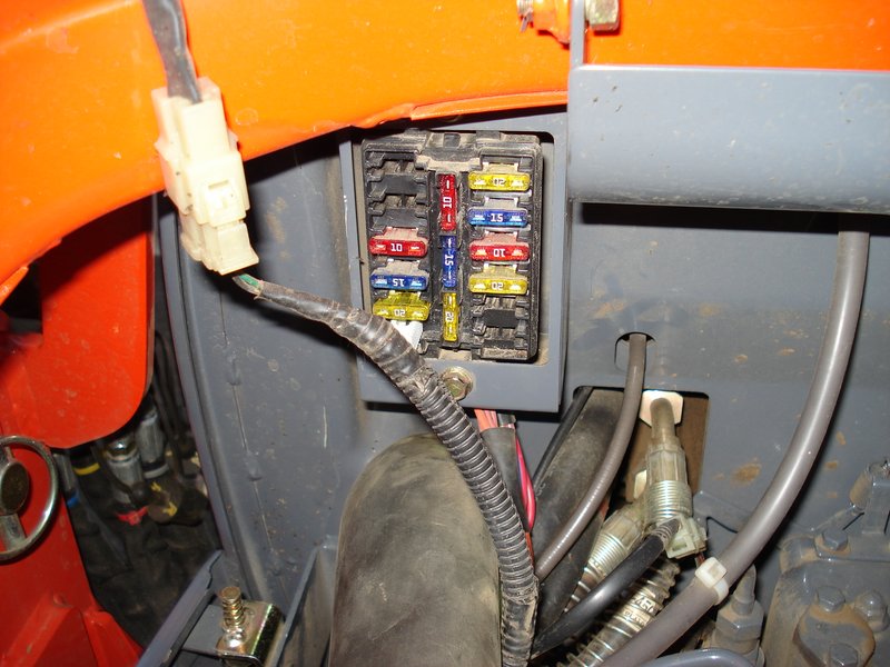

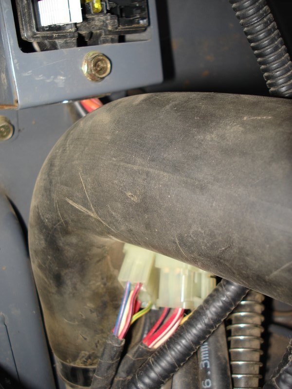

So I know I'm close... I took some pictures w/ the fuse block off. I'm wondering if the two plugs that come out of the fuse block are routed properly -- i.e. they go on the inside of the air intake hose. It seems they would be under a lot less strain if they were routed on the outside (closer to the hood) of the air intake hose and just tied back to make sure the hood doesn't come down and take them out.
First picture shows fuse block w/ cover off and wires out the bottom going to the right of the air hose.
2nd picture you can see the two plugs going under the air hose.
3rd picture you can see the other sides of the plugs. The wire furthest to the left in the picture is the blue w/ pink stripe who is the power going into the flasher unit.
I'm tempted to take the air hose off to make it easier to get at everything and unplug both connections and spray 'em contact cleaner, then re-connect with the hose still off and then try putting all the wires on the other side of the hose to see if things are not so tight.

Found it!
Short story: corroded pin in one of the harness plugs. Wallace had a great tip on where all the plugs connect so the tractor can be split in half. Sand paper, wiped clean, gobbed some dielectric grease on and snapped together and all tractor functions work.
Details for inquiring minds:
I pulled the intake hose off (see pictures above) and those two connectors are a lot easier to get at. Disconnected negative battery terminal and unplugged both. They were a little dusty, but the copper contacts were in brand new shape.
Pulled fuse and buzzed w/ meter from power side of fuse to blue wire w/ red strip on plug and it's good. This pretty much ruled out the fuse block and connector to harness by that air intake hose.
I had called Wallace since he's open on sundays and he wasn't too busy and we had a great chat. Every Kioti dealer should be required to go through training by Rick and Kioti should pay rick lots of $$$ to train new dealers. Either that or figure out how to clone Rick ;)
Anyway -- Rick noted that at the bottom right (when sitting on tractor) under the lower panel below the dash that's not too bad to take off there are like 4 or 5 plugs that all can come apart so the tractor can be split in half. He suggested checking those out.
Well I re-connected the negative terminal and pulled the hazards -- nothing. Then I started jiggling each of those connectors and a bunch flasher clicking -- pushed just right on it and flashers came to life.
Called Rick back to tell him he nailed it and he mentioned if you disconnect these plugs, if any pins are corroded, they could snap off or fall apart. I figured I only have the one pin that was a problem and I really wanted to know what was going on.
Turns out I had to unplug like 6 things to get at the plug that has the blue wire w/ red stripe involved. Every plug I pulled apart was squeeky clean on the inside until... The last plug with the most pins and the blue wire sure enough had some blue-ish crud on the flasher wire pin, but also some black and bluish crud on one of the bigger pins in there -- basically it looks like maybe some water or other corrosive thing got in and gravity kept it towards a cluster of pins in one area w/ the blue stuff forming and some black on the pins and all around one area. The flasher pin was the first to exhibit problems, but if I didn't go in there, then sure enough a few other pins down the road would start to have issues once the corrosion set in enough on those.
So I took some fine sand paper and cleaned the pins to get some shiny copper showing again, then wiped out everything to get rid of the blue and
black gunk. Q-tips worked well to get everything fairly clean under there.
Took junk vacuum cleaner I use for dirty stuff like this and sucked up all of the grit / dirt / dust (from mowing) and made sure no debris got into any of the other clean plugs. Also cleaned everywhere under that lower panel while I was at it. (decent build up of dust/dirt from mowing and perhaps it was made worse from a while back when the dash took a bath in HST oil from my clogged HST vent problem last year)
Laid in some di-electric grease on the cluprit connector on both sides so she would seal out any new crud.
Snapped together all of the various plugs -- I didn't use di-electric grease on the others because they were perfect (brand new condition) and I store my machine inside. I think the corrosion source for that one connector was way back from dealer assembly or from the 3 months it said on the lot in the weather. Also, my dealer power washes the tractor after service (which I don't) so that's another way water could have worked in (he stores the machines out back when in for service and they get dusty)
