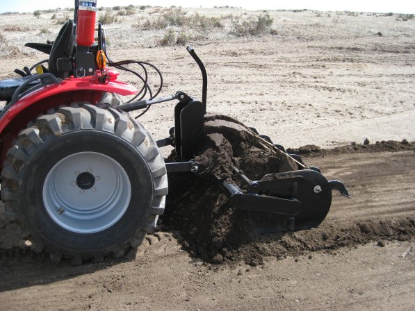

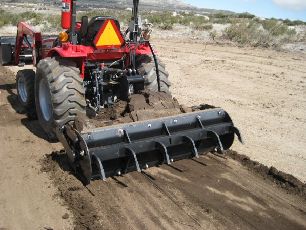

There are several people that seem to have good luck with the 6 foot box blades on this size of tractor. My feeling is that a tractor should be able to scrape and pull a full load as in the picture up hill. If not, then your blade is too big in my opinion. These pics are not up hill, but my tractors will do this up a pretty good grade. Red tractor has a 66" rollover BB and the blue tractor has an 81" rollover BB. Both are Gannon's.
