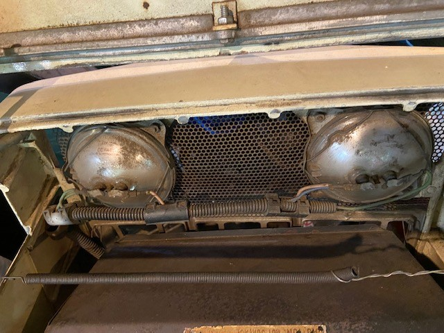

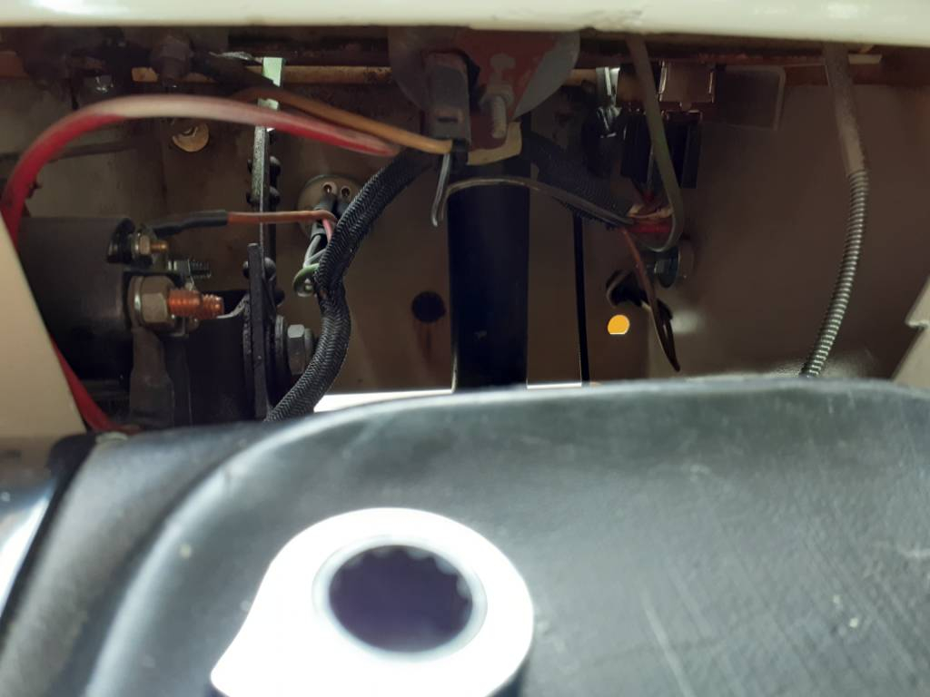

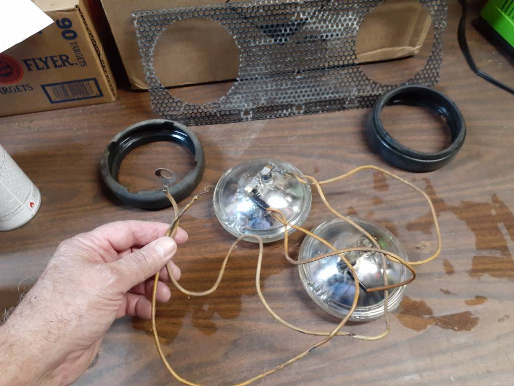

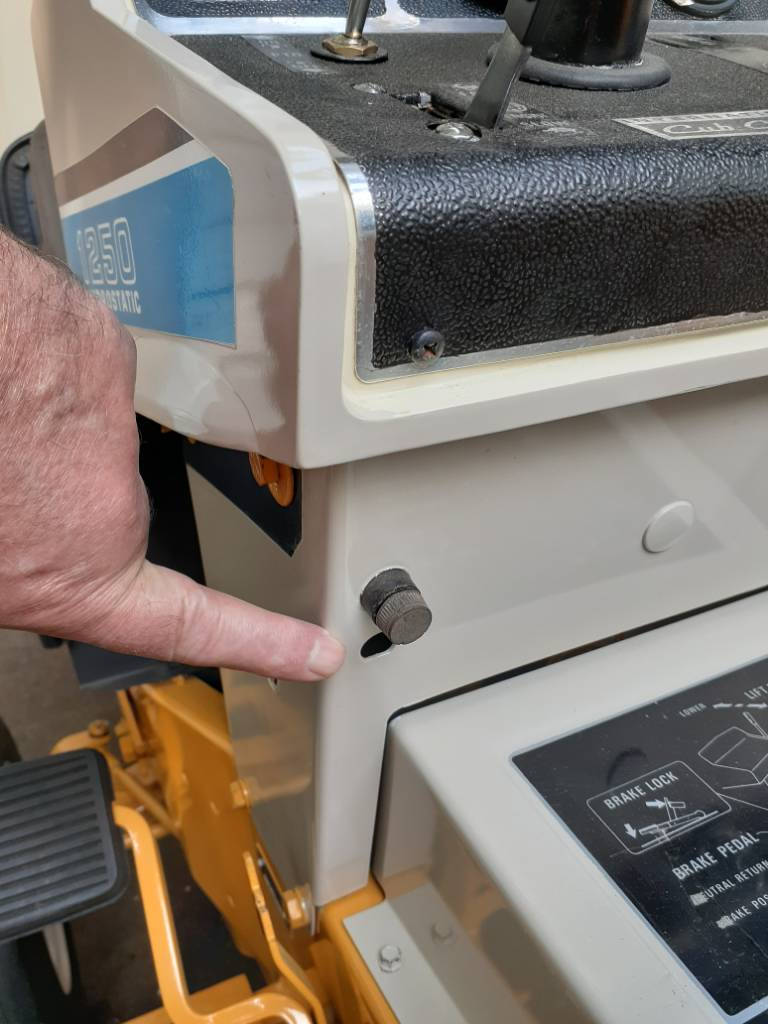

I just bought a 70s Cub Cadet 1250 that didn't have headlights so today I got a used set I ordered. I want to run wires like factory. I assume switch I need is a push-pull SPST and goes in hole I'm pointing to below fuse holder. Used bulbs are good, both GE made in USA (original?). Wire was disconnected but bulbs in parallel as shown, but the big ring terminal...is that grounded & if so where?
Other wire looks cut & stripped. Did that originally have a connector and go to switch?
Where does other switch terminal get power & connected where? Finally, how are wires run?

I doubt the switch was intended to go in the flat bottom hole you are point to, but the hole to the right that has a plug in it. Newer switches mounting is smaller diameter than the older switches generally.
As for where to ground, a cleaned spot on the frame if possible, if not any bolt on that provides a ground bear the headlights. Use a multimeter to ID.
My suggestion for power to the switch for the lights would be an ignition powered source (ACC on the ignition switch would be 1 possibility). I would also suggest an inline fuse in an accessible location on the power side to the lights.
