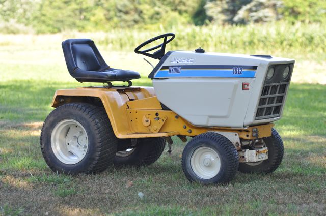

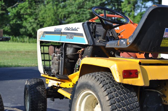

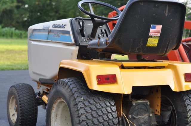

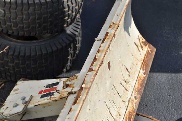

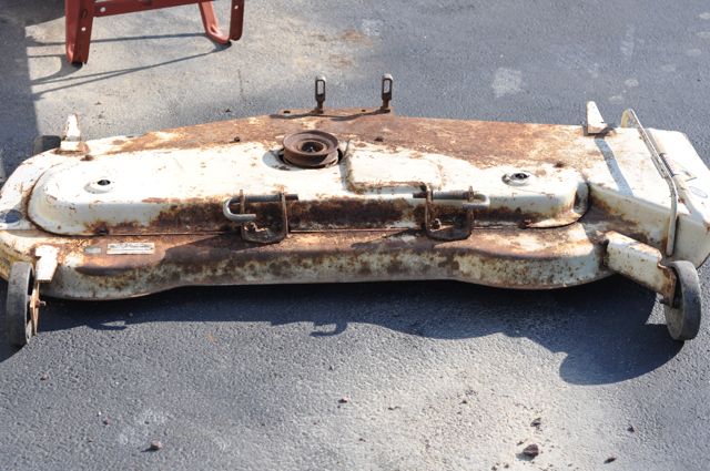

Thanks for the information . I will search for a cub cadet dealer , I might luck out out Home depot or Tractor supply if not I will have to wait till monday for the dealer to open back up . The deck is a little rough and I don't know yet if all the parts are there to attach the dozer blade , but the tractor runs strong .

Thanks for the pics it appears to be in decent condition - a couple of things:
There should be side sheilds on both sides of the engine (under the white side covers) that direct the cooling air over the fins on the head - w/o these it could overheat longer term.
The deck - I would grease the heck out of the spindles (if they turn freely) then do a wire brush/sander on the deck and prime/paint - it will look like new.

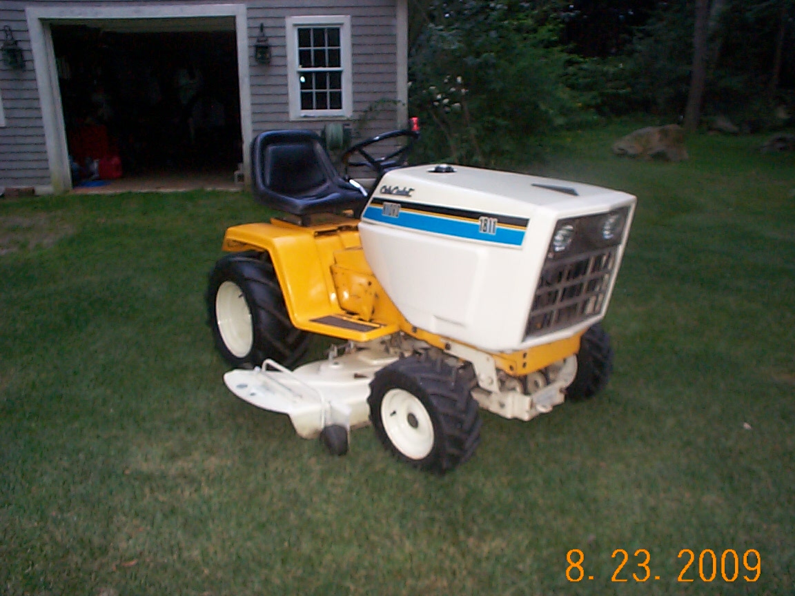

I did the same thing to my 1811 2 yrs ago - tho it was more of a touch up after 20 years than a complete respray.
When you get it done look forward to some pics! Heres several of my 1811.
Carl

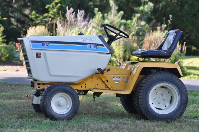

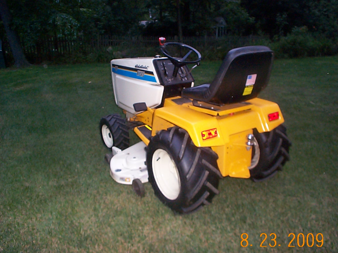

Wow looks like new Carl . I need to get a few more rattle cans , but here is today's progress

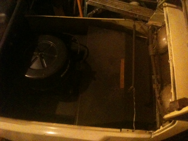

By the way Carl when you get a chance could you take a photo of the engine with the hood up . I have an engine shroud I can't find a place for I believe it goes up front . Also would like to see how the side panels attach by the headlights I have them bolted by the steering wheel but only wired by the headlights .

Here are two shots taken tonight of the right side engine cowling (under the white side panels) then the other one is the top of the engine and shrouding.
I didnt have the best light but I think you get the idea. Essentially the engine is surrounded by cooling shrouding including the exhaust / muffler which pushes all the air from the rear fan to the front of the unit. This is INSIDE the white side panels which are more for show.
Black metal shrouds are on both sides L&R - shrouding is attached by 3/8" head auto type fasteners thru clips on the shroud - these are a PIA to R&R.
On the top side to hold the front of the white panels in place is a spring (mine broke so i added a wire to one end) and it connects to the top holes on the white side panels.
Hope this helps.

Perfect thanks Carl .

Stopped at the Case dealer yesterday picked up up 2 gallons of Hy-tran and a hydro filter , made a huge difference with the sound of the tranny and the way the hydraulics sound . Cut the old filter apart it was black and had a coating of slime .
Bought some new decals and a few more rattle cans . Thanks for the help .

thanks for the help Carl . I think the mower deck is a lost cause the bearings are frozen and the mounting bracket is missing some parts , the blade is also a loss with out the mounting bracket .
Right now i plan on using is to pull my aerator , lawn sweeper , and for moving the chicken coup . Later on down the line I may invest the money to restore the deck , but right now I have a simplicty and a kubota to tackle grass mowing .
