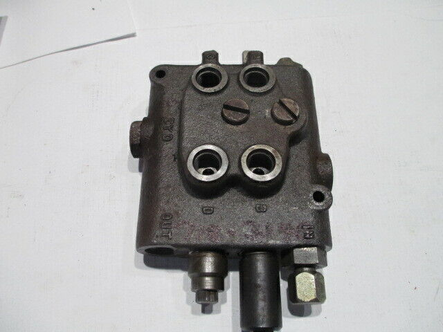

I have two issues:
I have a single lever control valve like the one in the above link. I can't find a rebuild kit for it (if it's even rebuildable) Most likely I will buy this one off fleabay. My current one leaks out the spool valves and at one end where the release spring cover is. The cover housing is also worn through and leaking fluid (where the spring is)
My other issue is the hose connections. I bought it and the loader didn't function properly. I believe the hoses are not hooked up correctly. I looked for a service manual online but had no luck getting a free download version. My valve has 7 port openings. It runs the loader and 3 pt hitch. In total I have 9 hoses coming off it and need to find the proper hook-up in regards to where the hoses attach to the valve.. I can post a picture if that helps. Does anyone have help for this set-up 0r have a hydraulic set-up like mine?

Here's the full 416/417 loader and parts list manual.
The 417 control valve described herein should have 2 hoses running to the bucket tilt cylinders, 2 hoses running to the bucket lift (boom) cylinders.
and 3 hoses back to the hydraulic block on the right side just foward of your feet. There's a pressure relief valve Tee-ed off the boom hoses right at the valve block so you don't try to lift too much. (416s have an integrated relief valve which has been problematic for many owners, who end up replacing the whole valve assembly with good one).
The configuration of the hydro block results in the P (pressure) port going first to the loader when the 'switch' on the block is set to 'S' (you set this to the other position - O - if you don't have any auxiliary hydro stuff connected; if the loader is disconnected you can either throw the switch or hook the P hose to the N hose with the quick-connects). If you're not moving the loader, the high-pressure fluid is routed back to the N (for power beyoNd) port. The T port is Tank, for fluid back into the tank at low pressure. The N port then feeds the 3pt lift control(s) mounted on the right fender.
