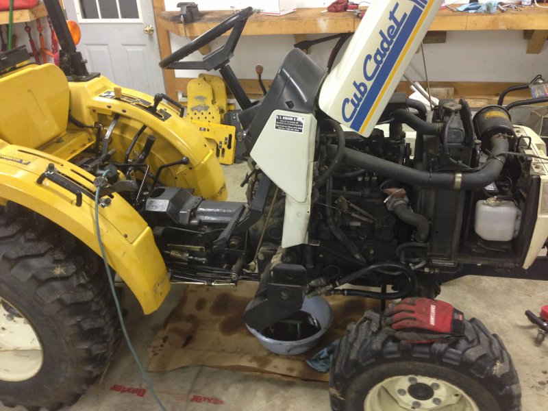

I just go through putting a gauge on the charge pump test port (supposed to be 60 - 85psi) and read 0 psi, needle did not even bounce. We could still get tractor to surge once or twice forward by pumping the main clutch.
I removed the Forward and Reverse high pressure valves on the sides of the hyrdo and inspected for a sticking valve but they looked fine.
I removed and inspected the short steel line that goes from the hydraulic filter to the charge pump. That is the only suction of the charge pump and one side is an O ring press fit, but it looked fine. I did replace and reinstall the o ring, still no pressure.
So next step is tractor split. Going to drain fluid and remove lines/linkages and prepare to split this weekend. Any and all feedback is appreciated!

A few pics of what I'm up to.

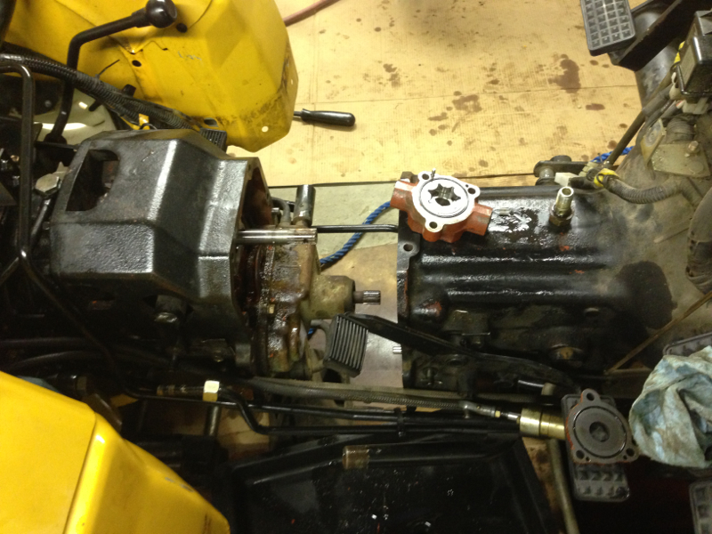

#13
Split the tractor and I obviously have a busted gear in the charge pump. New one is on order.

New charge pump arrived and I had it installed and put back together by myself in about 2hrs. Putting the sheet metal, seat, etc, took another hr or so. Obviously not too tough of a job. Chain fall and over head I-Beam came in handy.
This thing is back to NEW with the new charge pump. It was obviously worn out some several years back. I can climb up steep hill in H range, which I have not been able to do for a few years. Overall cost was just under $700 for all parts (pump, seals, fluid, filter), but I am very glad I did the repair. Makes me want to keep tractor for another 13 yrs.
