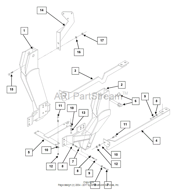

Here is a diagram of the loader mount of the Kioti KL1470 loader that would fit my tractor,a Cub Cadet 8454. KL1470.gif

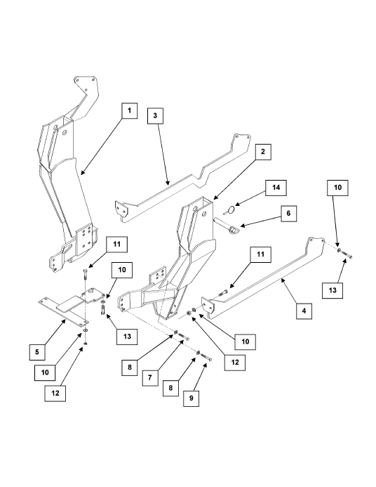

Cub Cadet 640 Loader 1.gifHere is a diagram of the loader mount I have that fits Cub Cadet 8354 and Kioti DK35.View attachment 508088

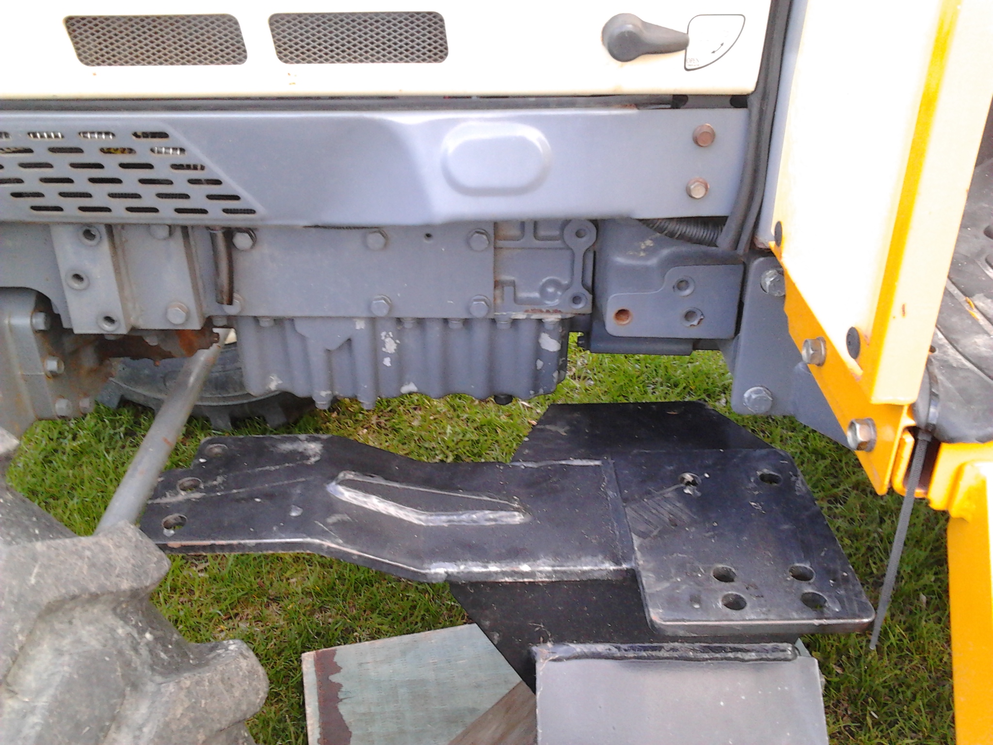

Here is a pic that should explain better about having to refab the front part of the loader mount.The rear part actually does line up with the four holes,two on top that you can not see and the two on the bottom.2017-05-02 18.33.38.jpgI seen have pics online where the Kioti DK45 instead of having the 7/8" thick bar with holes for the loader mount toward the front of the frame,that is vertical.Have bars of steel welded horizontal in the same area.

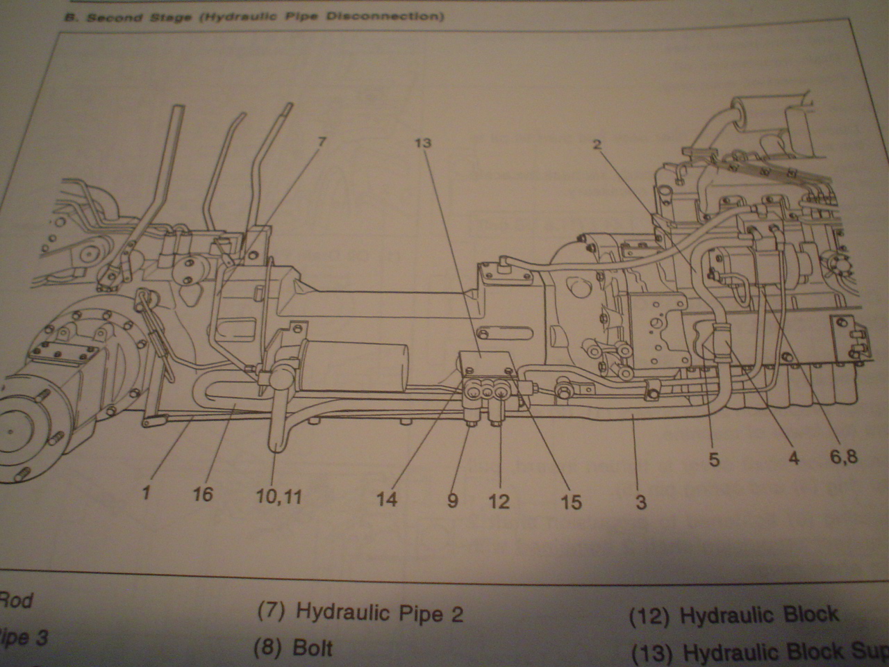

I found on a diagram of the Kioti DK35 that the loader mount holes for the loader mount are not on the bell housing.They are on a section of the rear of the engine.DSC06463.JPG
