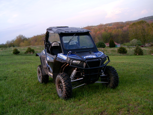

tstae may I ask did you get the upper doors and back window on your Challenger like in my pic. I did and find it very noisy inside the cab but fine in the Summer with them off.
   / Cub Cadet Challenger 750 #58
Yes I did....with them on the noise is x 2 or more.
#59
I wish I would of known about it before I bought them. Now I have to figure a way to silence the inside during the Winter months cause without ear phones she is loud lol. Now that the Winter is almost over will be taking top of door off.
