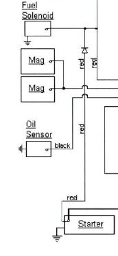

Good day all,
I got myself a Cub Cadet AGS2160 with a 16hp motor model 303447. The previous owner did not quite know electricity and ended up frying the majority of the electric circuit.
I'm at ease with that; I found the electrical diagram to rewire it but my issue is with the fuel solenoid. While starting, the fuel solenoid get it's electricity from the starter and there is a diode on that circuit to prevent the starter from drawing electricity (from that circuit) once the engine is running.
The diagram is really clear but, I have no specs on that diaode or the fuel solenoid current requirement. I know it's 12VDC fed but that's not enough to get the proper diode size/spec. Can anyone help?

Thanks Richard, It's not a problem finding a place to get the Diode but, I'd like to know how did you come up with 50 to 100 volts and 1 amps?
The battery voltage is 12V normally. Could go to 15 with a good charging alternator. So a 100V reverse voltage rating will be more than adequate to prevent the voltage from bleeding back into the fuel shut off coil.
The 1 amp forward current rating should be more sufficient to power the fuel solenoid during the engine crank cycle.
I looked the the diagram over again and there is no Diode.
This line is confusing me. You ask for a recommend diode so that the fuel solenoid could be power while the engine is cranking. There clearly is a diode in the wiring diagram you posted.

Thanks Richard, very clear.
It's Tomplum that was talking about a diode on the Kill circuit and I replied to him that I did not see one on that specific circuit ''Kill circuit''

That small picture of the wiring doesn't tell me what the purpose of the diode is in that circuit. As shown, it apparently prevents a backflow of current to the starter from some other source voltage - but I can't imagne what that might be.
Based on what is shown, I would wire it differently. Simply wire the fuel solenoid to a key switched terminal on the ignition switch.
Be sure to place a fuse in the switched line to the fuel solenoid. You can also add the diode if you wish. I can't see what it does so cannot say why or not. But rating one correctly is easy:
To calculate the amp rating of the fuse or the diode use your VOM to measure the resistance of the solenoid coil. Then by ohm's law the amperage drawn by that amount of resistance is the system voltage (12 volts ) divided by the solenoid coil resistance. Check for any other circuit in series and add those amperage draws as well. Then select a fuse and diode with at least twice that total calculated amp draw to allow for heating and voltage spikes.

Thanks Scotty, Your explanation is very clear. As to the electric diagram, I'll attach it to my reply but you figured it out correctly: it was to prevent the backflow of the current to the starter once the motor is running. Could not hook up the solenoid to the key switch as the current is cut off from all other position while starting.
