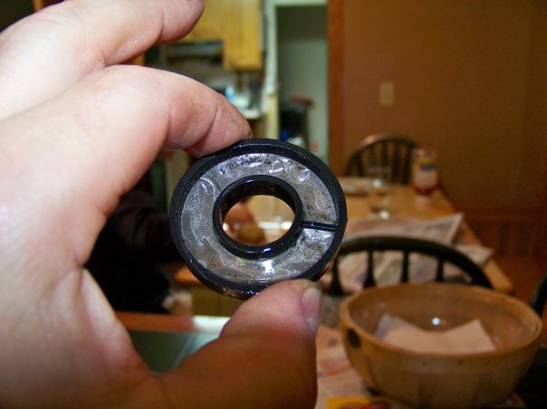

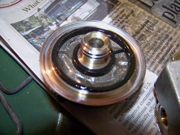

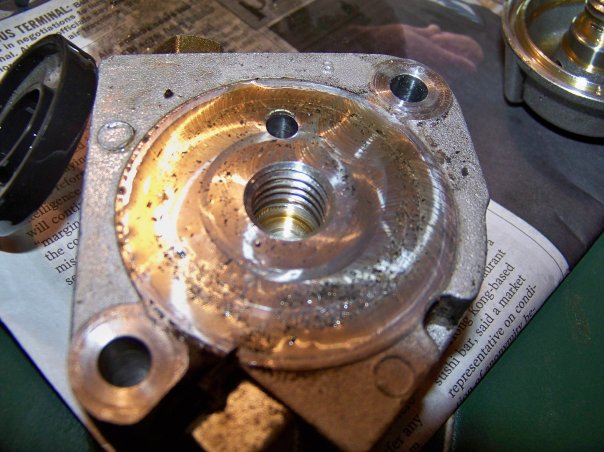

I go the charge pump off with just the seat off and took it apart. I am a big fan of silver flake paint on a car with some clear coat but I am guessing that metal flake in the hydraulics is less than helpful. I will attempt to upload some pictures. Comments on how bad this looks? I know nothing about Hydraulics and am OJT'ing as fast as I can. Cleaning it up and putting it back together? Is it worth a try or just buy the rebuild kit for 300 dollars that I can't wait to spend.

The silver flakes you see are probably from a gear that seems to be missing from your photos. You can buy a new charge pump from Savilles outdoor equipment in orchard park ny (on-line for $225.00) or you can buy the rebuild part for about $125.00--I would go for the new pump in case you did any more damage to it that you can't tell. There was one a used one on ebay last week for $100.00 You could check and see if it is still there.
   / Cub Cadet GT3200 lost all hydraulics #7
Something else to start thinking about.....How to flush all those metal flakes and bits and pieces from the system.
