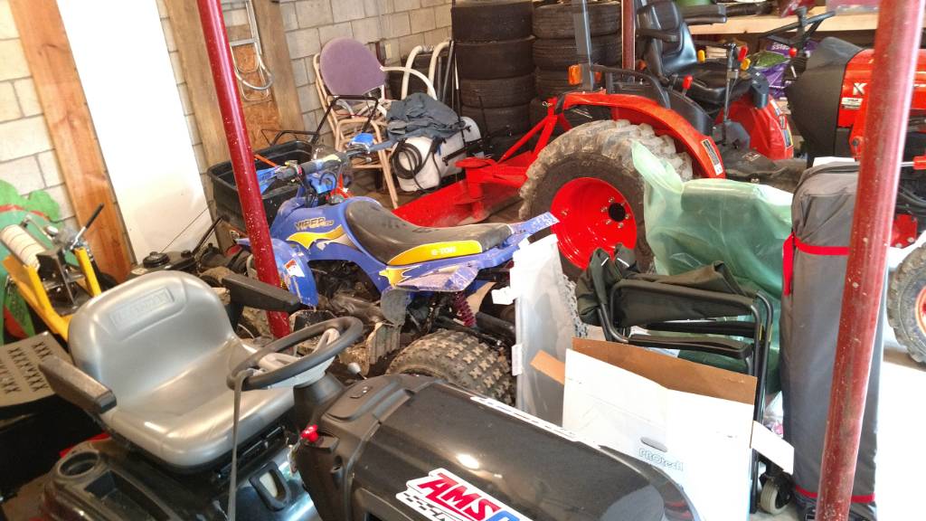

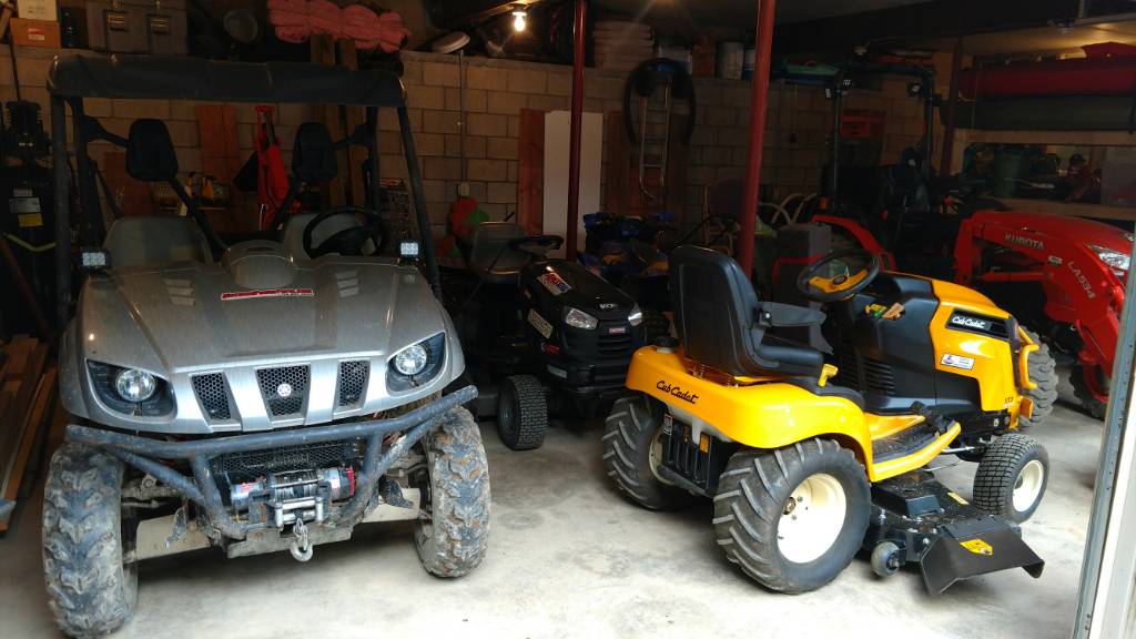

Got the XT3 GSX home yesterday, and did another garage reorganization today. I fit it in!
The transmission in this thing is not exactly what I expected. If I stop on a steep incline and attempt to move forward again, you hear the pressure relief valve releasing and it will not move. If you back up a foot and get it rolling, even just a bit, it will climb a steep incline. My Craftsman/Husqvarna with the G730 on the other hand can stop on my most steep of inclines and start moving again with authority. I'm starting to wonder, is this transmission a lesser part than a G730? It sure feels that way.
The deck mows extremely nice and flat, very few missed blades, even at fill HST speed. The Craftsman does cut smooth and flat as well, but leaves noticably more missed blades.
The Kohler Command engine with 42 hours on it will occasionally smoke upon being started. My 600 hour Kohler Courage has never even hinted at expelling smoke. I'm not liking that.
I'm honestly not sure that I'm in love with this. I may sell it back off and go get that Husqvarna TS354XD after all.

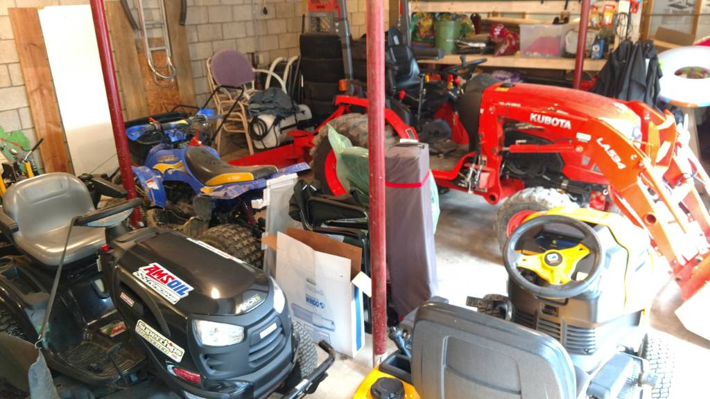

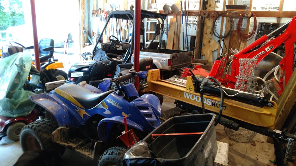

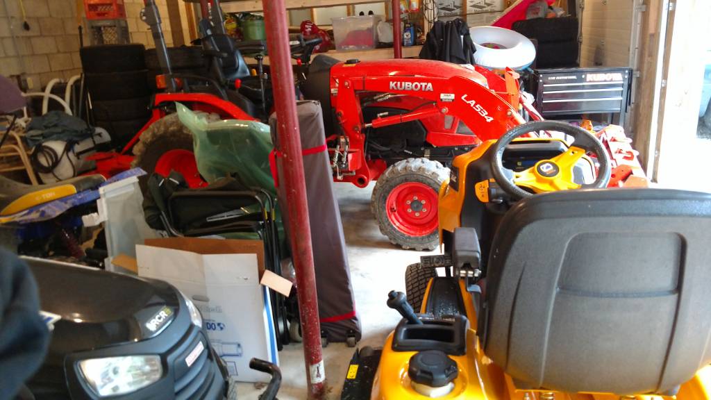

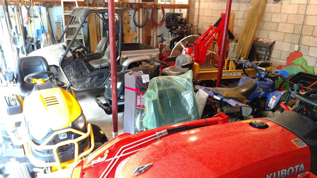

I've got more crap packed into this garage than I ever thought possible. I'm thinking about going 3 dimensional and start hanging things like the spreader and sprayer from the I-beams above.
Let's give this Cub Cadet a few weeks and determine if it's a keeper, or if it gets booted on down the road. IMG_20180606_190121751.jpegIMG_20180606_190716302_LL.jpegIMG_20180606_190736910_LL.jpegIMG_20180606_190801384.jpegIMG_20180606_190832319.jpegIMG_20180606_190840837_LL.jpegIMG_20180606_190904692_LL.jpeg

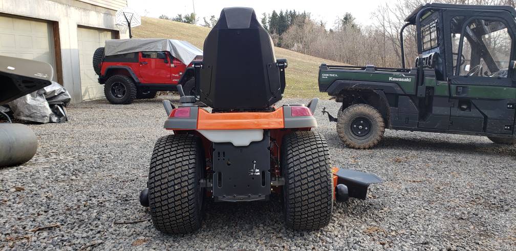

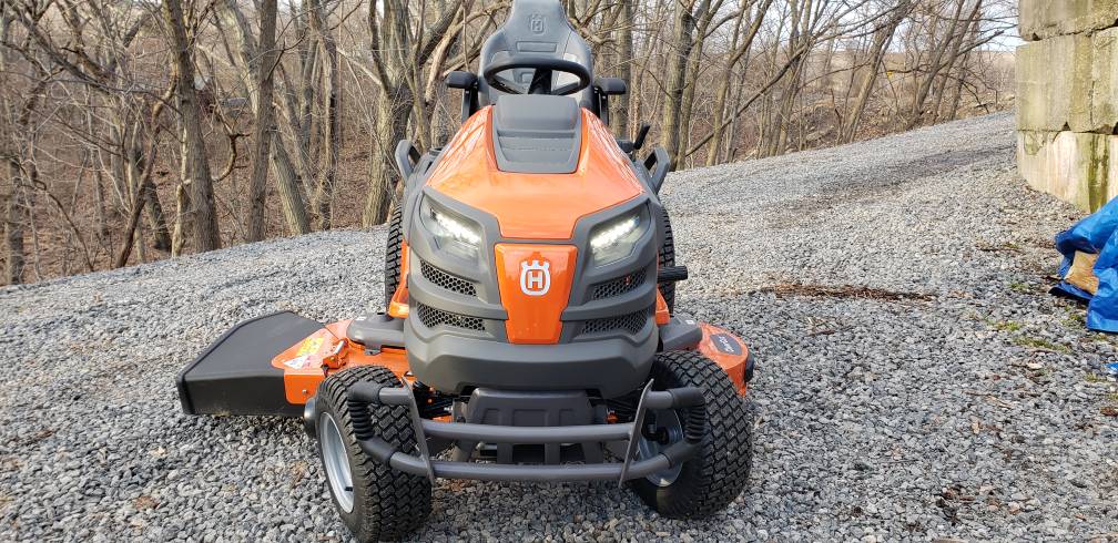

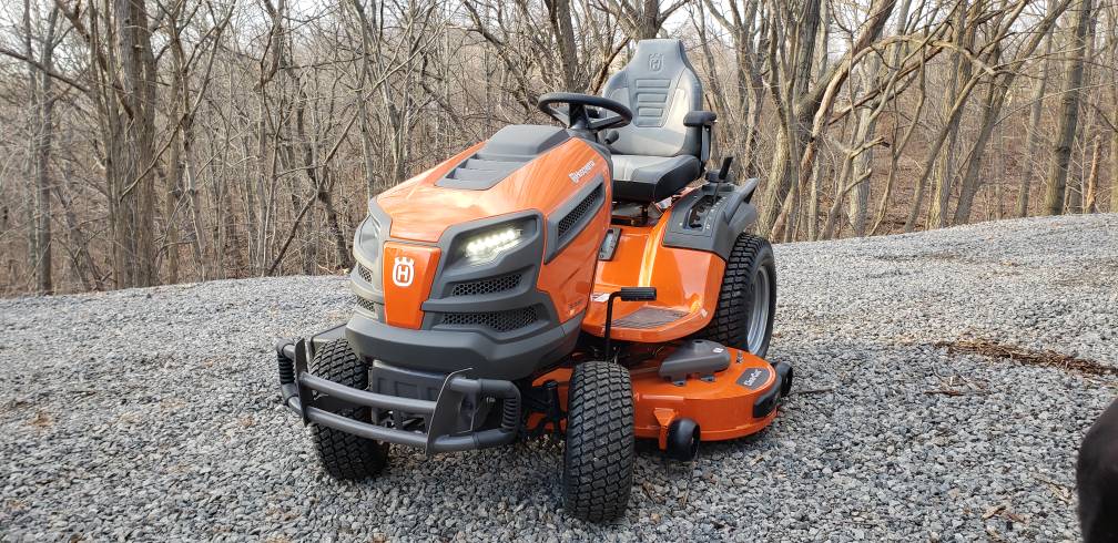

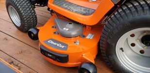

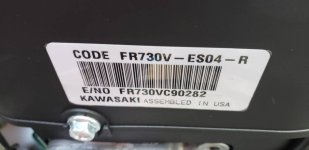

Reviving this thread... I sold the Cab Cadet XT3 GSX and found a leftover 2018 Husqvarna TS354DX with Kawasaki engine and Tuff Torq K66 with electric locking differential. I called the dealer and told him to put the 50 lb weights and the chains on it.
I'm glad to be done with that Cub Cadet, that was a sad letdown. The transmission was just horrible and I couldn't live with it.
Note that the Husqvarna dealer told me that if I waited a year, there is rumor that Husqvarna is going to release a new line of the garden tractor with a Yamaha sourced engine rather than the Kawasaki engines in spring 2020.
That will be interesting, no doubt. It would be even better if they tossed a K72 transmission with a locking differential behind it and kicked it out the door for around $4700 give or take a couple hundred. I would be first in line!
   / Cub Cadet XT3 GSX or Husqvarna TS354XD?
#13

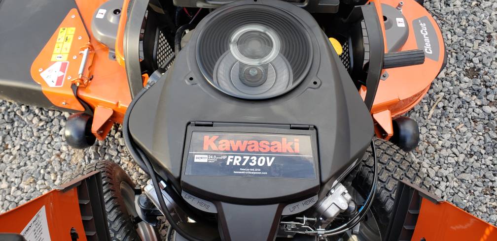

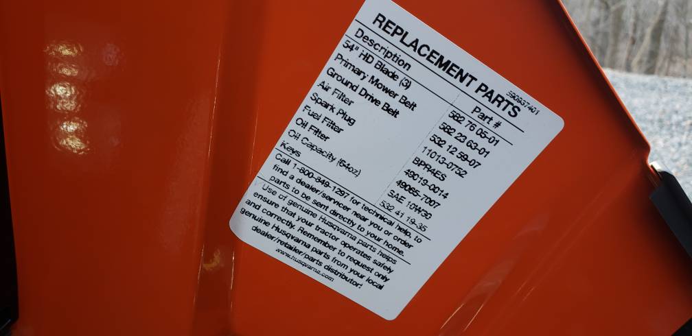

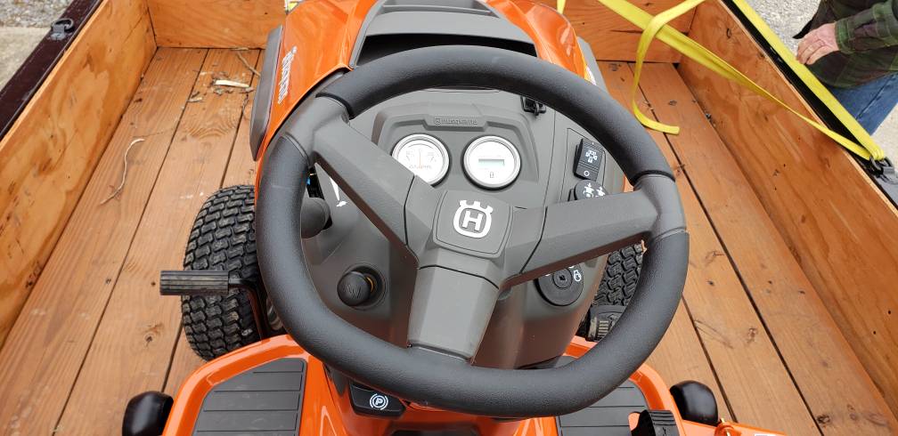

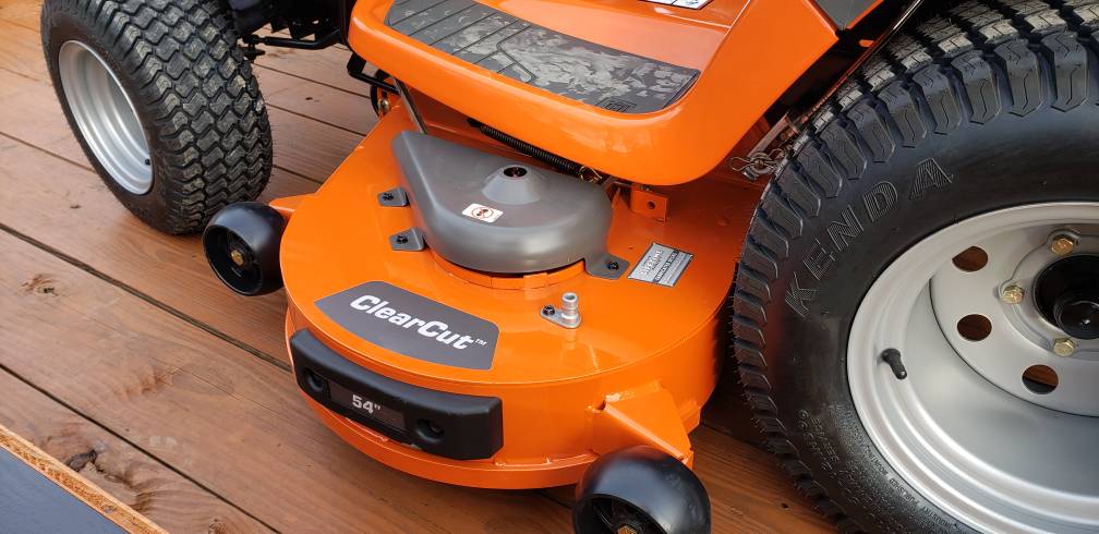

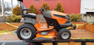

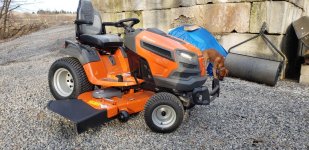

It's a done deal. Cub Cadet gone, Husqvarna in it's place. $3992 out the door with tax. Let's hope that I just bought myself happiness that I never found in that miserable experience with the Cub Cadet XT3 GSX.
Please, please dear Lord.... Let the Tuff Torq K66 and Kawasaki engine be my huckleberry.....20190311_171432.jpeg20190311_171510.jpeg20190311_175832.jpeg20190311_181546.jpeg20190311_181557.jpeg20190311_181605.jpeg20190311_181616.jpeg20190311_181645.jpeg20190311_181734.jpeg20190311_181658.jpeg20190311_181712.jpeg20190311_181742.jpeg
