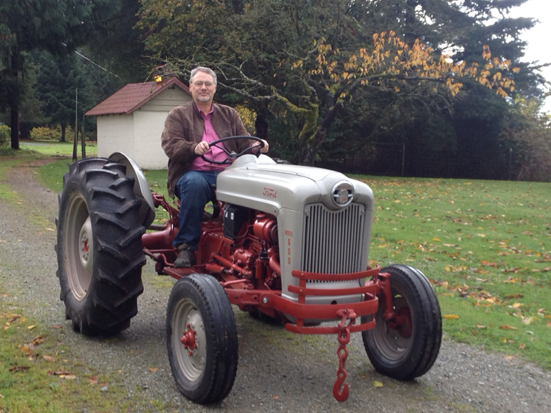

Thanks GA! One was planned, the other in response to the farm which came when I got married last year. I also got a really cool tool too.
   / Cub Cadet/Yanmar SX3100 slipping out of 4WD unexpectantly
#19
Wow...that's a classic tractor and very cool!. Thanks for posting the photo. Also belated congratulations on your marriages, the one to your wife and now the farm...way cool!
