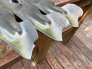

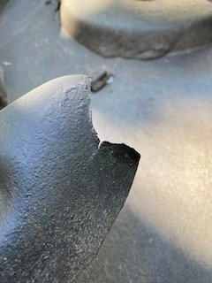

Here are some pics of the blade tips. Some of them have actual tears in them. In the hand they feel light and thin. Much less substantial than the blade on my 12 year $100 push mower. Utter garbage. At first I thought I might work on them with the grinder and a file but they are toast.
The bad part is that I'm not sure if I can find replacements. The standard Cub Cadet blades are going to be the same junk. I don't want or need the mulching blades. I may buy the sand blades if I can find them. The 'S' shaped spindle shaft is integral to the spindle so no option to change that out without changing the spindle.
The odd thing is that the fabricated deck (verses stamped) is in perfect condition after 50 hours. No rust. No dents or dings. No significant debris accumulation. Strange that they'd make a deck so beefy and durable and then put sorry blades on it.

I agree with you 100% . Me? I would look back at like decks with the old style star blades, replace the spindles and be done with this.
   / Cub Cadet ZT-2 54" blade question. #13
I know it doesn't help you....but I own just about every kind of metalworking tool known man.
I'd either be modifying the spindle to accept standard blades.....or I'd buy whatever blades I wanted and be modifying them to fit the s-shape
   / Cub Cadet ZT-2 54" blade question. #14
I had the blade mount bushing modified on my zd1211 to fit the older size zd mower blades. Aftermarket blades were not, and likely still not available in the new size for my application.
I would much rather go to the trouble of changing the blade mount than dealing with a poor selection of blade types.

Update: I bought a set of Cub Cadet sand blades. I got a set of their “extreme” blades which look like a mild version of a gator blade. Both sets of blades feel pretty light and pretty cheap. But they are not cheap to buy.
I put the sand blades on yesterday and mowed yesterday afternoon and this morning. They are supposed to be more durable. That seems doubtful. But they are also low lift and in fact the ‘flaps’ are angled downward.
They seem to cut as well as the standard blades but they put significantly less dirt and dust in the air. For me that was a real problem with the standard high lift blades. Of course as a result they don’t throw the cuttings as far and tend to wind row in deeper grass. I can live with that trade-off.
I doubt I’ll mount the extreme blades until the sand blades wear out. I bet they won’t last any longer than the OE standard blades so I will probably be replacing blades every 50 hours at $100 a pop. Not happy about that at all.
I will replace these spindles at the earliest sign of trouble and replace them with ones with a star shaped shaft so I can get cheaper and probably better aftermarket blades.
I have expressed my disappointment with Cub Cadet and included this problem in my reviews for what that is worth. Not much.
