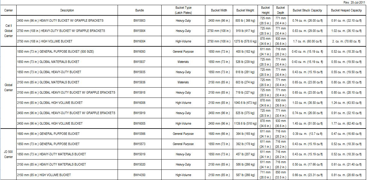

I agree ^^^^^ it seems to me people are too dependent on the internet to make decisions. A typical 6' bucket is about a half yard capacity and add a few more scoops for clean up.

Yup. that is how I figured it. I came up with about 25

for reference, here's the chart,
1/2 yd is a pretty good estimate
