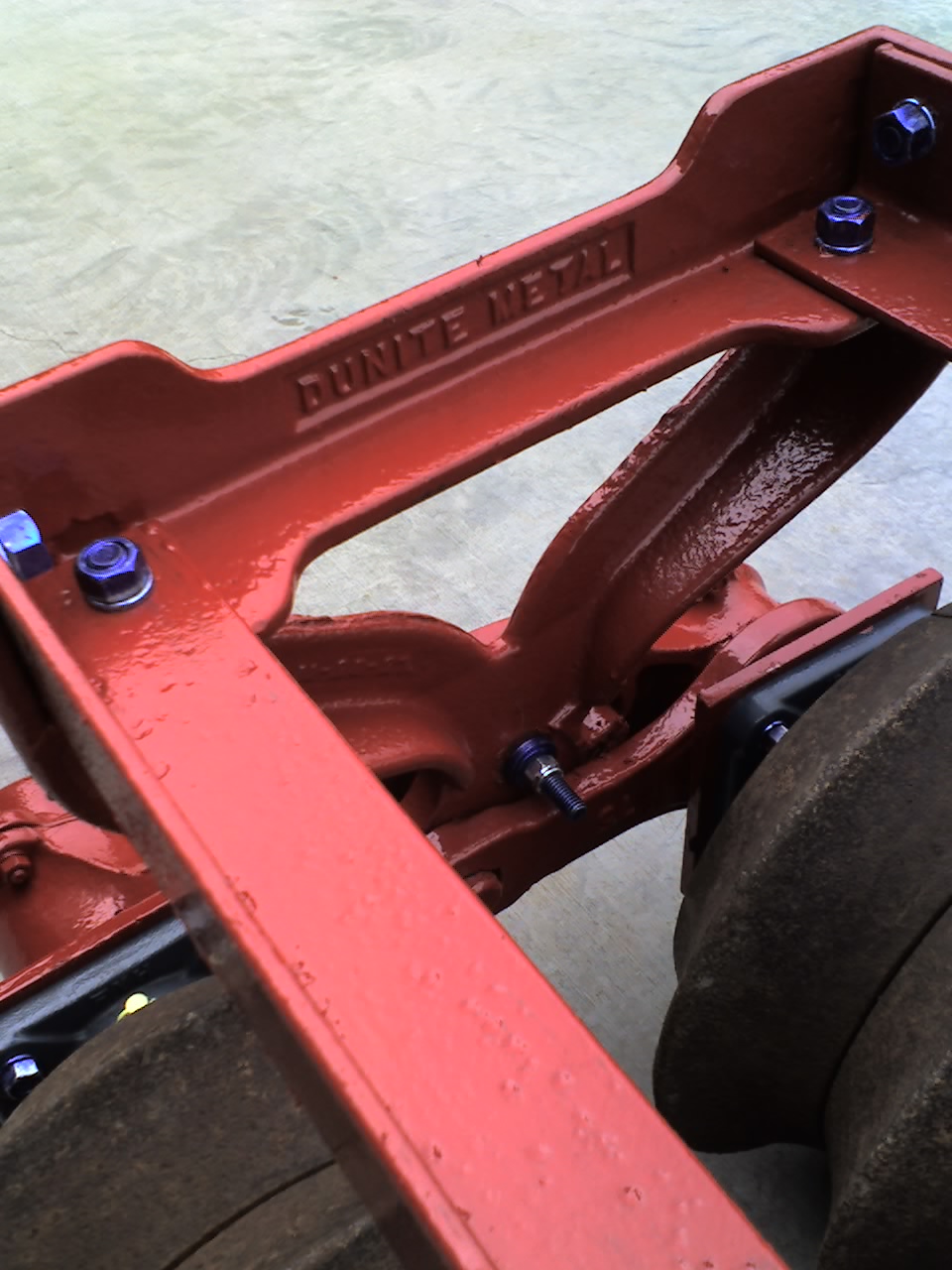

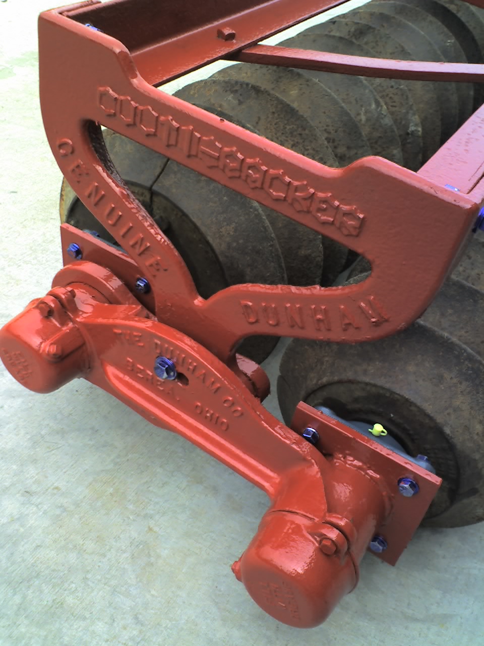

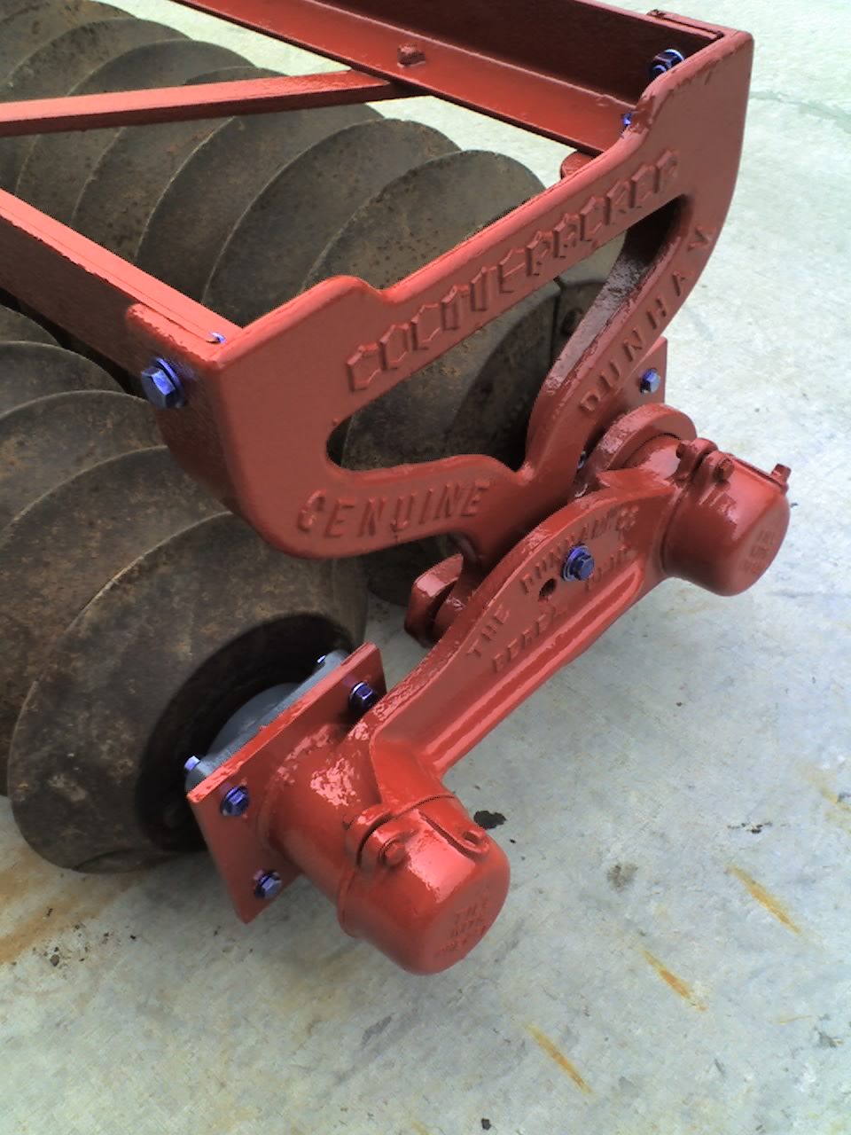

I restored one that appears to be just like yours a couple of years ago. Here's the link to where I did it http://www.tractorbynet.com/forums/...ulti-packer.html?highlight=dunham+cultipacker
I cut two pieces of railroad track to fit in the 'basket' on top to add weight. I use one of my forktrucks to move it with the added weight. I think without the weight it only weighed just over 1000 pounds. Here are a few pictures to see if it matches yours.
I added a regular trailer hitch to the front of it with a 2" ball. Since the restore I've probably used it 60 hours or more. It works fantastic and I no longer even use my pulverizer/gill. If the area is really rough, I just plow the area, till it with my 7' rototiller, and then run the cultipacker over it; pulling it either with my RTV1100 or Suzuki King Quad 700. I then cover the area with grass seed, fertilizer and straw. By the time it rains enough for the seed to come up the ridges left by the cultipacker have 'melted' flat and covered the seed perfectly and I'm left with a nice smooth lawn.

Very nice. It turned out great. Thanks for the info. I plan on making this one new again too.

Hey, nice find! I spent quite a bit of time bringing mine back up to 'better than new' with new bearings and hardened axles and it has worked great. I figure that if it lasted 80 years sitting outside with nothing more than wood bearings in grease it ought to last the rest of my life with better axles, real bearings that can be greased and being stored inside. I just used mine again last week. With the regular 2" trailer hitch I put on mine I can pull it with my ATV or my RTV. Since both of those weigh less than any tractor I have as well as having low pressure tires, it works very well for a finished grade. Good luck!!
