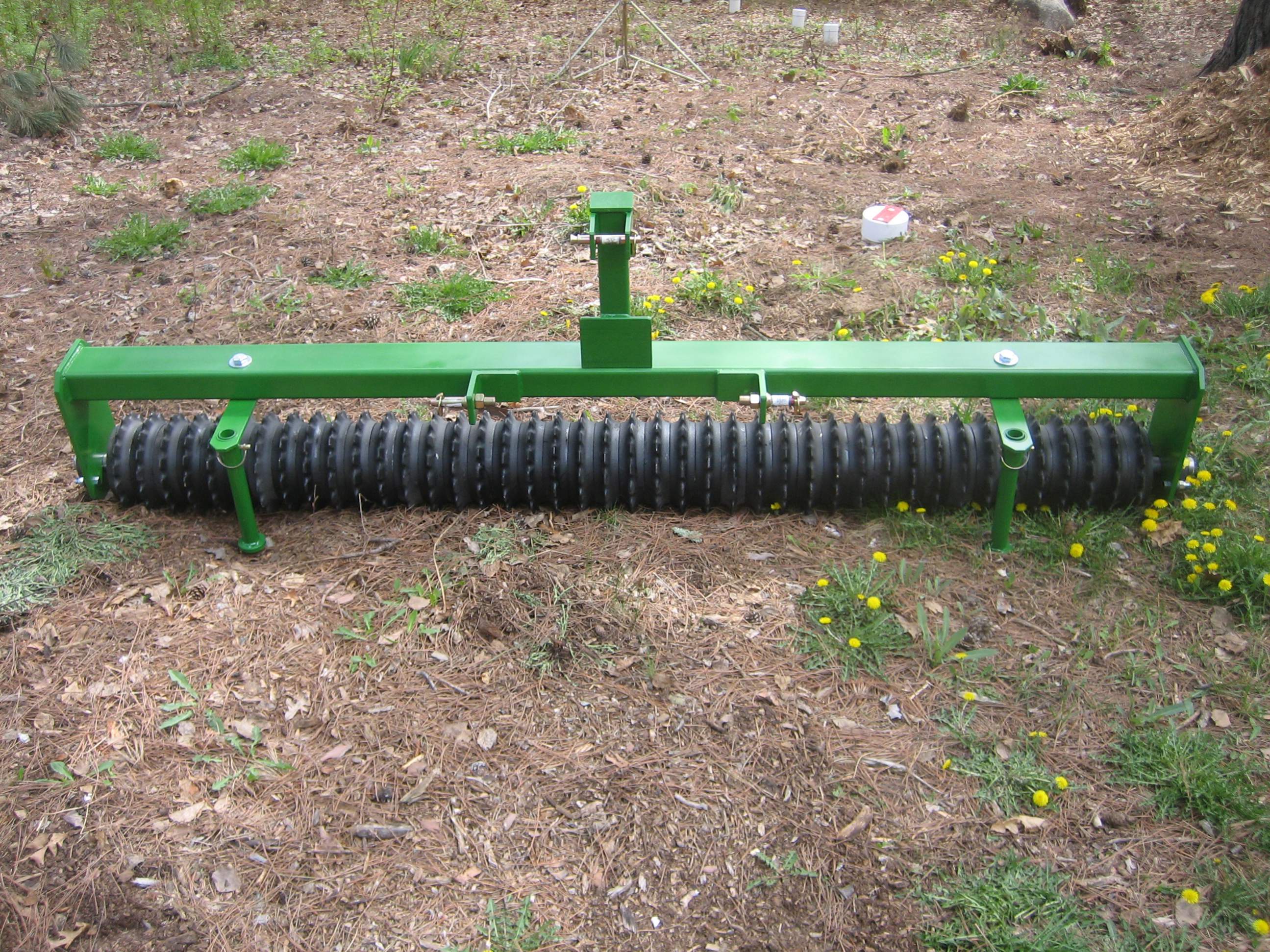

I never used a cultipacker, but even if there is a 2 or 3" gap in the center, after going over the same lawn a few times that should make the ridge disappear. I would put a bearing in the center. But that's just me.
   / Cultipacker design question. #12
I have always assumed that they are designed without a center support because they need to flex a little bit to conform to the ground contour? What do you all think?
Oldstuff
The center shaft of a cultipacker is generally smaller in diameter that the holes in the rollers to allow the rollers to adjust to uneven ground contour. That's why some cultipackers make a god-awful loud racket when in use. I wear ear protection when using my 10-footer.
   / Cultipacker design question. #13
2" diameter axle should be ok up to 7-8 ft. . Just be careful if mounted on three point hitch traveling down the bumpy road. That is where you will bend the shaft, not in the field. Ken Sweet

It's going to be a lift type, hydraulically lifted on 15" tires, when transported, if that makes a difference.

If the packer rollers are off the ground, drive slow on rough terrain. Ken Sweet

Thanks for the advice. I suppose it would be wise to add a center bearing. I am using 4 bolt flange bearings on the ends. I need to search for the narrowest center bearing I can find. I even thought about using a bronze bushing, but dont know much about them.
   / Cultipacker design question. #17
I worked for a golf course and turf equipment manufacturer.
We had equipment at about 1 1/2 tons with a 5 ton pay load that that used a 7'6" axle of 2" diameter.
They key is to use a tougher steel. Not just 1018 cold rolled.

My old 10'er had a center bearing. If you look a the old 'bearings' they were essentially 4 or 5" of wood with a hole drilled in it. That wood must have lasted 50 years. Nice long support area compared to the weight borne on the tip of a bearing ball. When I cut it in half and made two food plot 5'ers I made new 'bearings' using pipe and polypropylene w/ a zerk fitting.
   / Cultipacker design question. #19
I made this one 1 3/4 shaft, transport with tractor pull with atv
   / Cultipacker design question. #20
Hey spo! They say "imitation is the sincerest form of flattery". Thanks for the big helping of flattery with your design. LOL Just having a little fun with ya.
