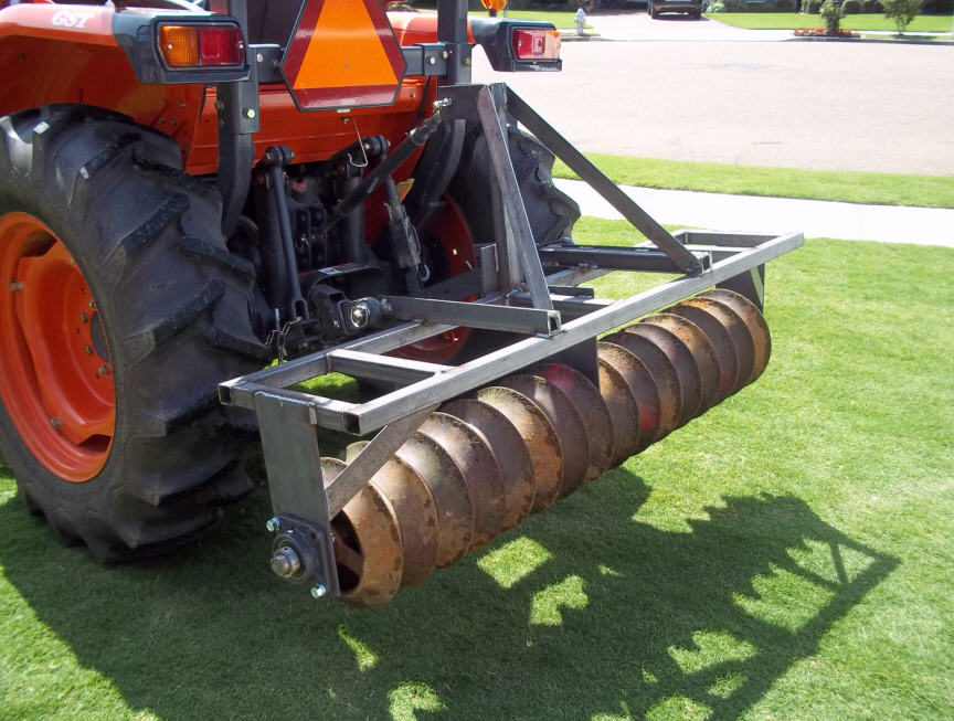

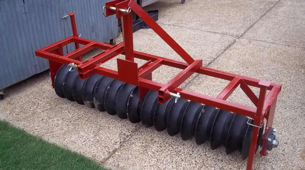

Not much else can be said for a cultipacker-but I agree-- I used drags and disc and BY far the cultipacker works great. For larger seed- I till and cultipack them in the softer dirt. For small seeds (clover) cultipack dirt first- seed and then cultipack again. I have found that it really makes a difference. When planting white clover at $100+ for 50lbs bag I want the stuff to grow right... I bought some older wheels and made this one.
AndyG

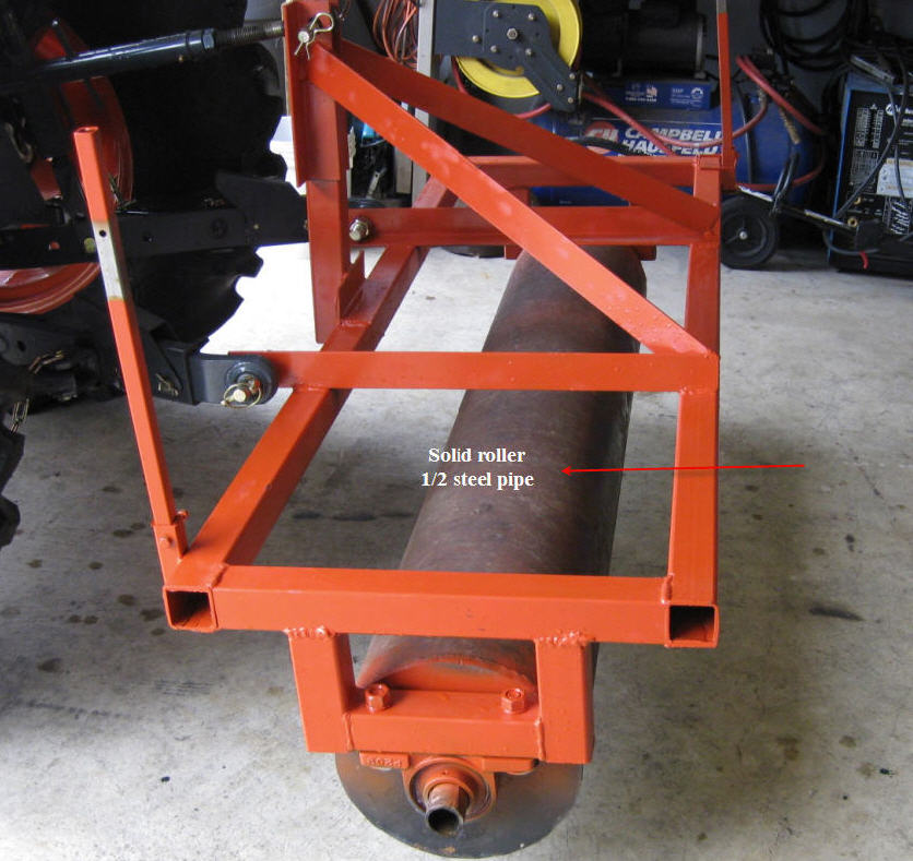

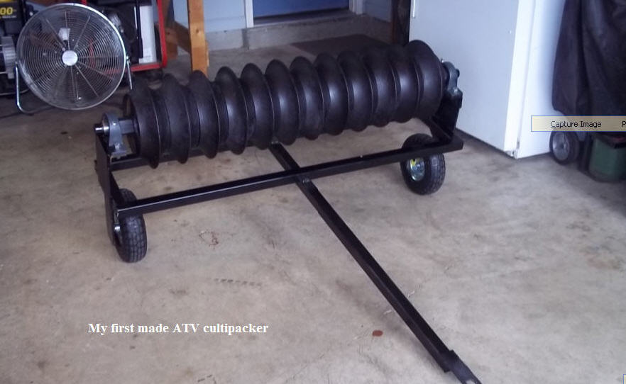

foggy, I made a single roller (below) and it did o.k- but the problem is that a single roller can hit high spots in the dirt and not press the seed down on the edges of the roller. A cheap multi tire one would do the same thing I bet? The packer I made has a single axle that is on bearings BUT the wheels also can spin on the axle. The wheels can also float up and down 1/2 inch or so on the axle allowing them to move up and down to conform to the field as you pull it.- I ended up buying enough wheels to make 2 packers and selling one to offset my cost on the 3pt one I kept. I might regret selling the ATV pull one?::confused:
