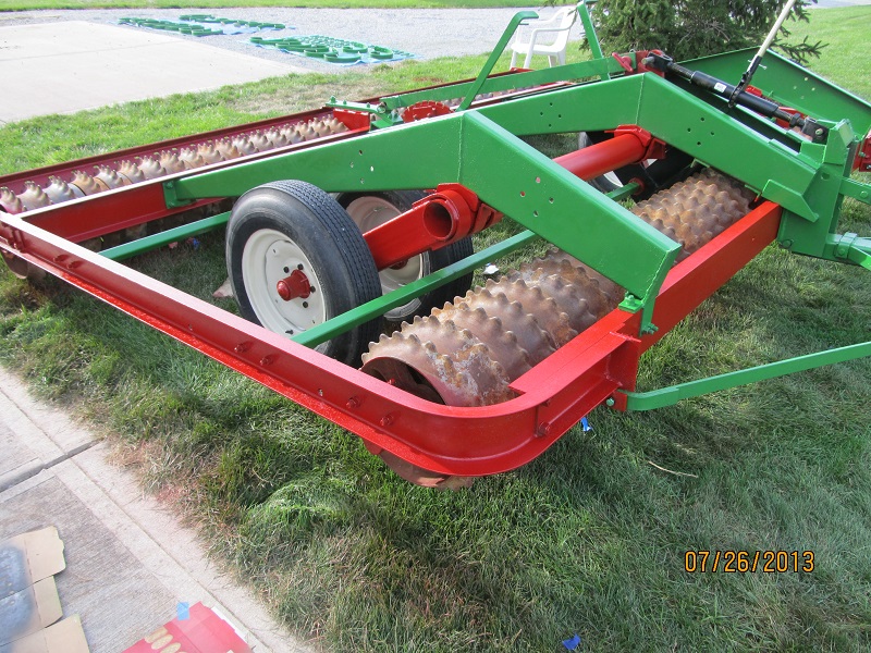

You can rototill the clumps out. I did it on two acres yesterday. Just go two or three times over it in 1st gear @540 and turn it to powder. Use a tiller with the flap all the way down but allowed to float. It will leave soft dirt on the surface. It will bury everything and I do it on about 20 acres a year.
The spike harrow next will take the "loft" or air out of the tilled soil. Then pack it. If tire tracks still show you could use a rock rake or, I use a cultimulcher with the tines just scraping the ground. You don't have one so a roller and some sort of scraper or leveler will have you do. The ground will be flat when done.

Here's a picture of a cultimulcher and an area I did with it. Then roll a Brillion seeder over it and flat as a pancake with no lumps. In the second photo the cultivators are not on because I was painting it.
