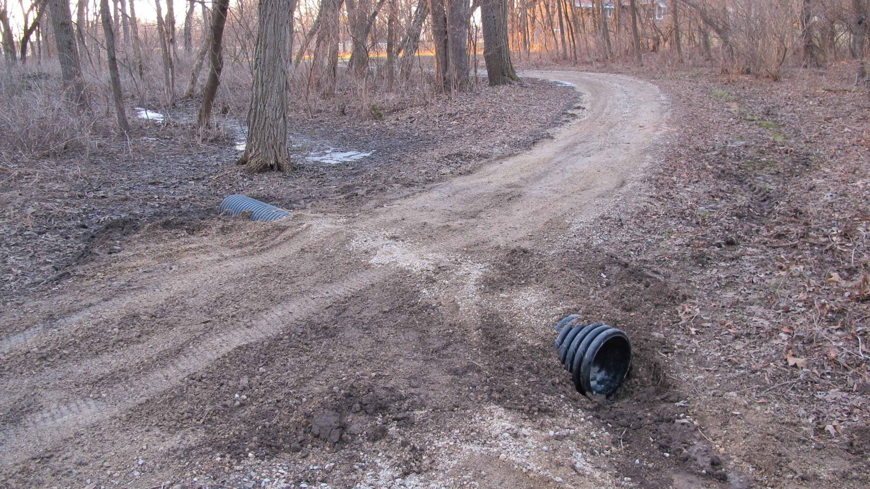

I have a 12" culvert, HDPE Dual wall H25 rating. I need to get more gravel over it. Right now there is only about 1/2 inch of gravel over the top. I am wondering if my RAM diesel and 12' x 6' gravel trailer could go over it to spread more. I don't have a way to turn around and I am not going to back up that far. My next alternative is to shovel it into the end loader and take it one bucket at a time.
I'd appreciate any advice from you construction experts.

I just installed it today. There is still a bit of frost in the ground too. I put the gravel I dug out around it. I'm going to pack it down best I can.

Gravel is not good packing material. This is very debatable, but I don't like gravel around a culvert. I'd rather have good clean dirt. It will fill the corrugations better and hold the culvert's shape better.
Being newly installed, I'd be reluctant to drive over it with a heavy load. 1/2" of loose gravel isn't going to protect the plastic culvert from pushing down the top.
Not sure what type gravel you are using?
   / culvert question
This trail is only used for my ATV's and tractors. I only need to drive the truck and dumping trailer to spread the gravel. 3/4". There will never be any heavy trucks on it.
