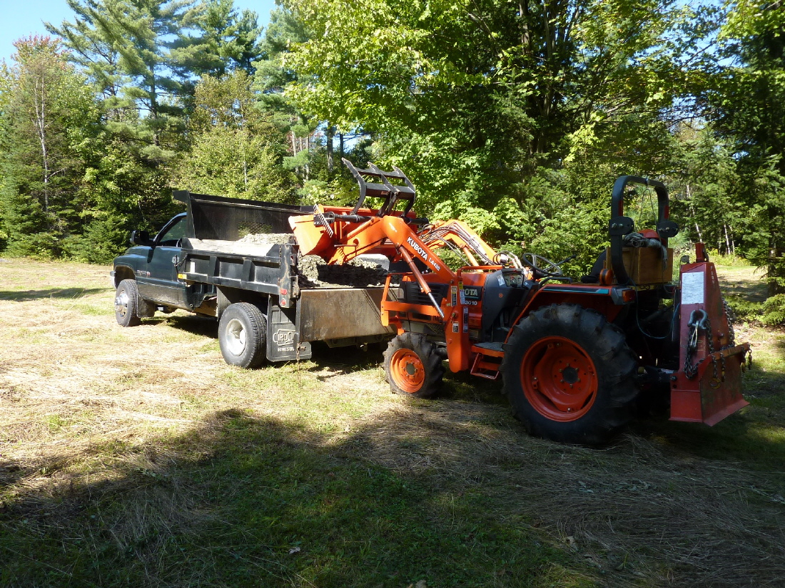

It has been dug ou a few inches wider than the culvert. I'll be driving my RAM and a dump trailer with about 2 yds of gravel. I won't be doing this for at least a month or more until it dries out around here. I guess I'll bring in some gravel with the loader for the first round and then drive over it and hope for the best.

Are you sure you have to shovel it into the bucket. If you have a 5' bucket you can do this.

I can't put wood down since I will be spreading the gravel as I go over the culvert.
I can get one or two bucket loads with the loader but after that I have to shovel. The trailer bed is 12 feet long.
I thought about closing the gate and dumping the load to the rear a bit but I'd have a mess when I open the gate. I think it would be hard to control since when it goes, it goes.

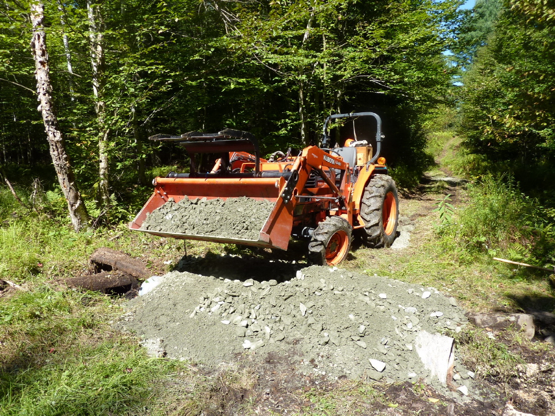

I just installed it today. There is still a bit of frost in the ground too. I put the gravel I dug out around it. I'm going to pack it down best I can.
It looks good to go - adding some more gravel to take out the dips from settling is a good idea, but it looks solid. 12" is a rugged size.
If it was me, I wouldn't hesitate to drive your pickup and gravel trailer over it.
I've watched 11 yard dump trucks drive over my 16" corrugated plastic culvert without problems - 6"-7" of gravel. Culverts are designed tough!
