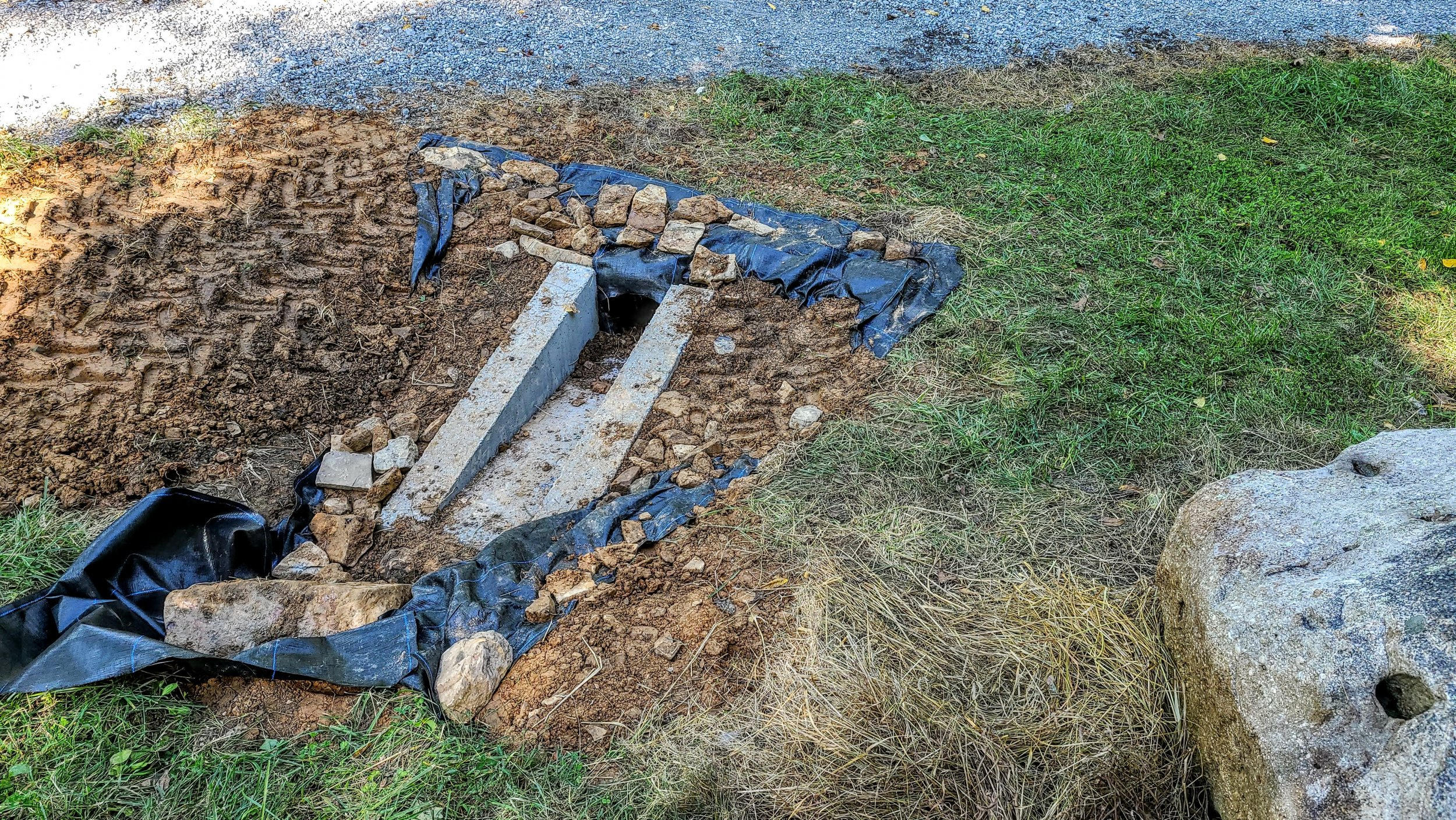

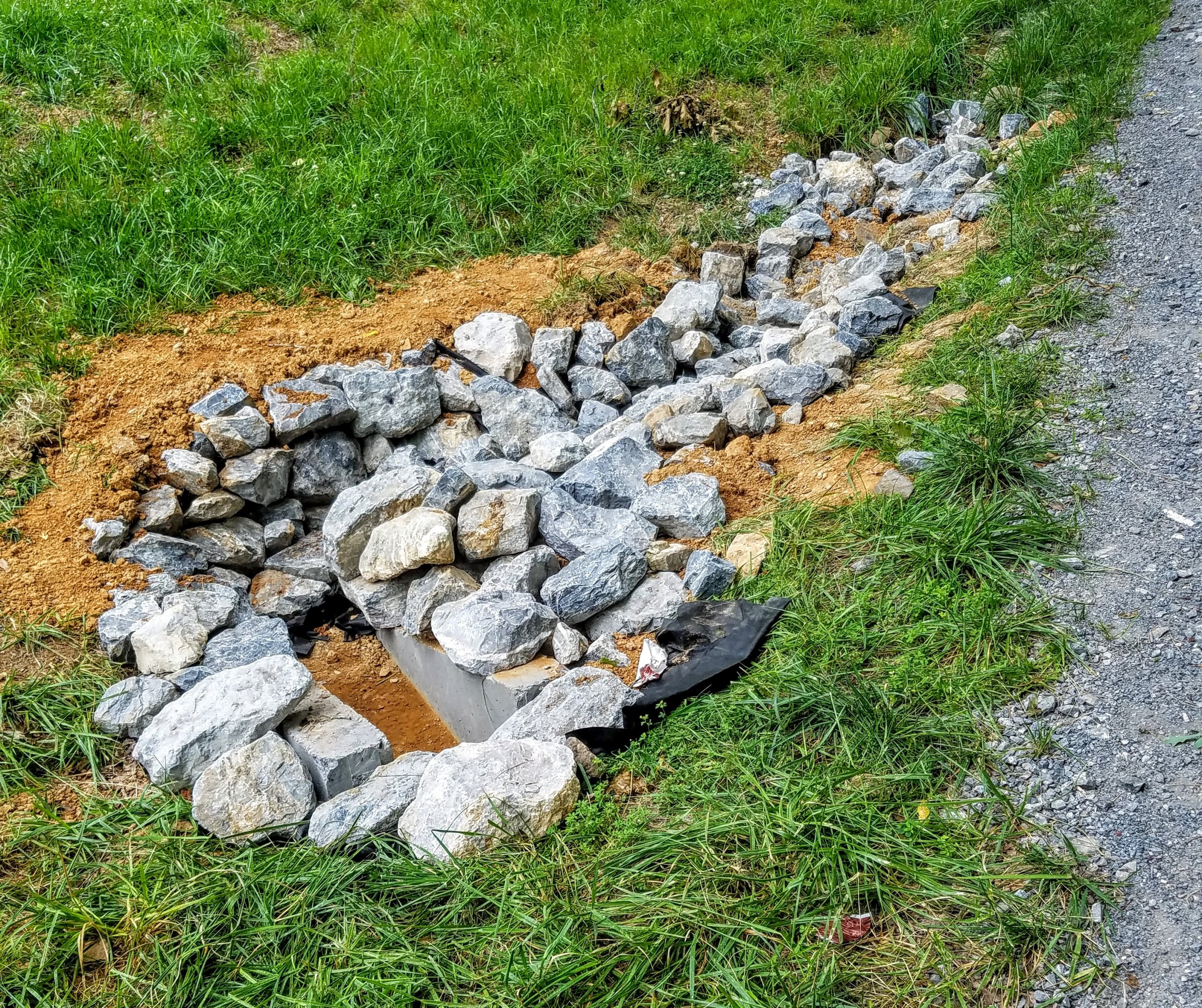

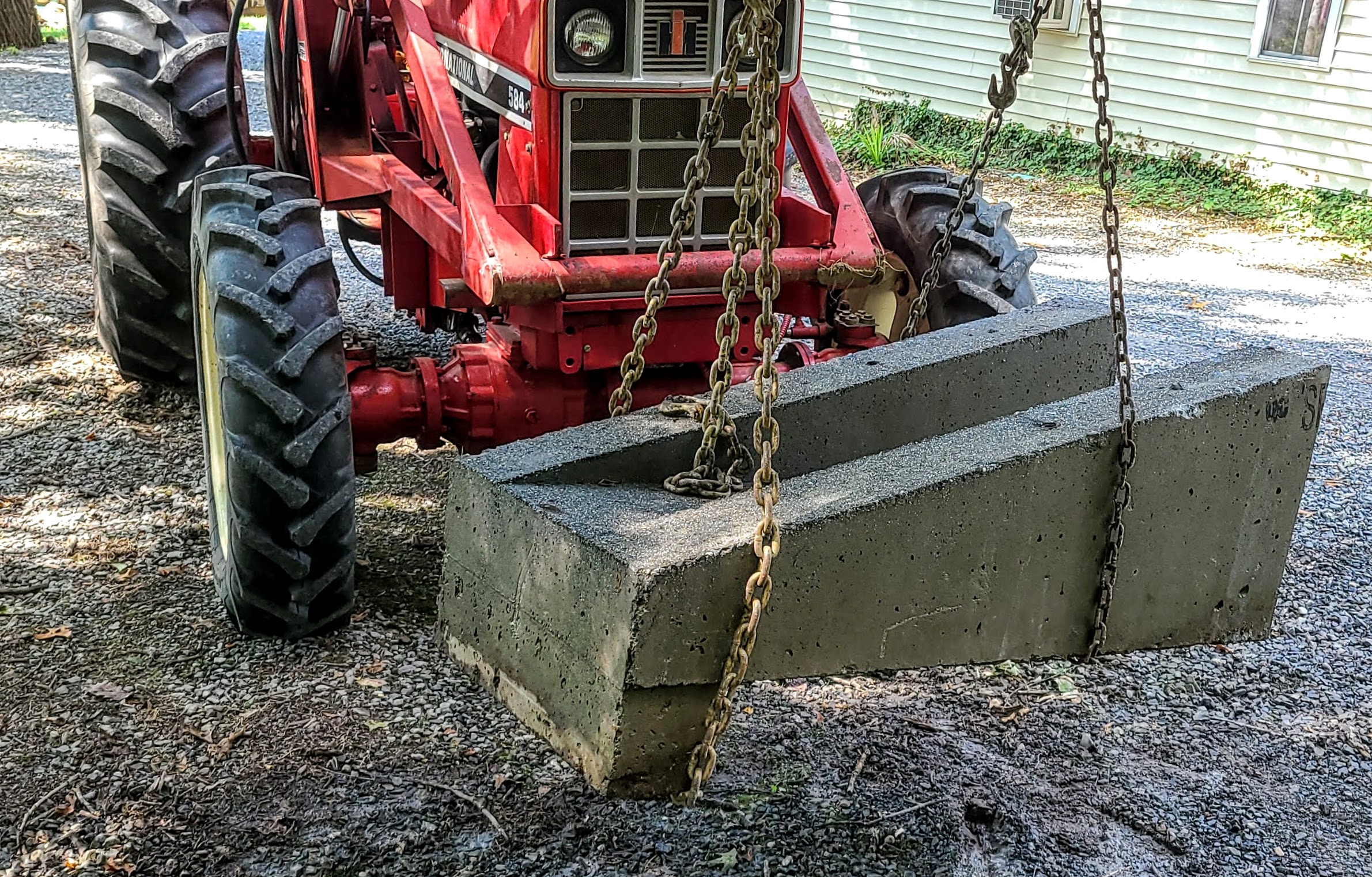

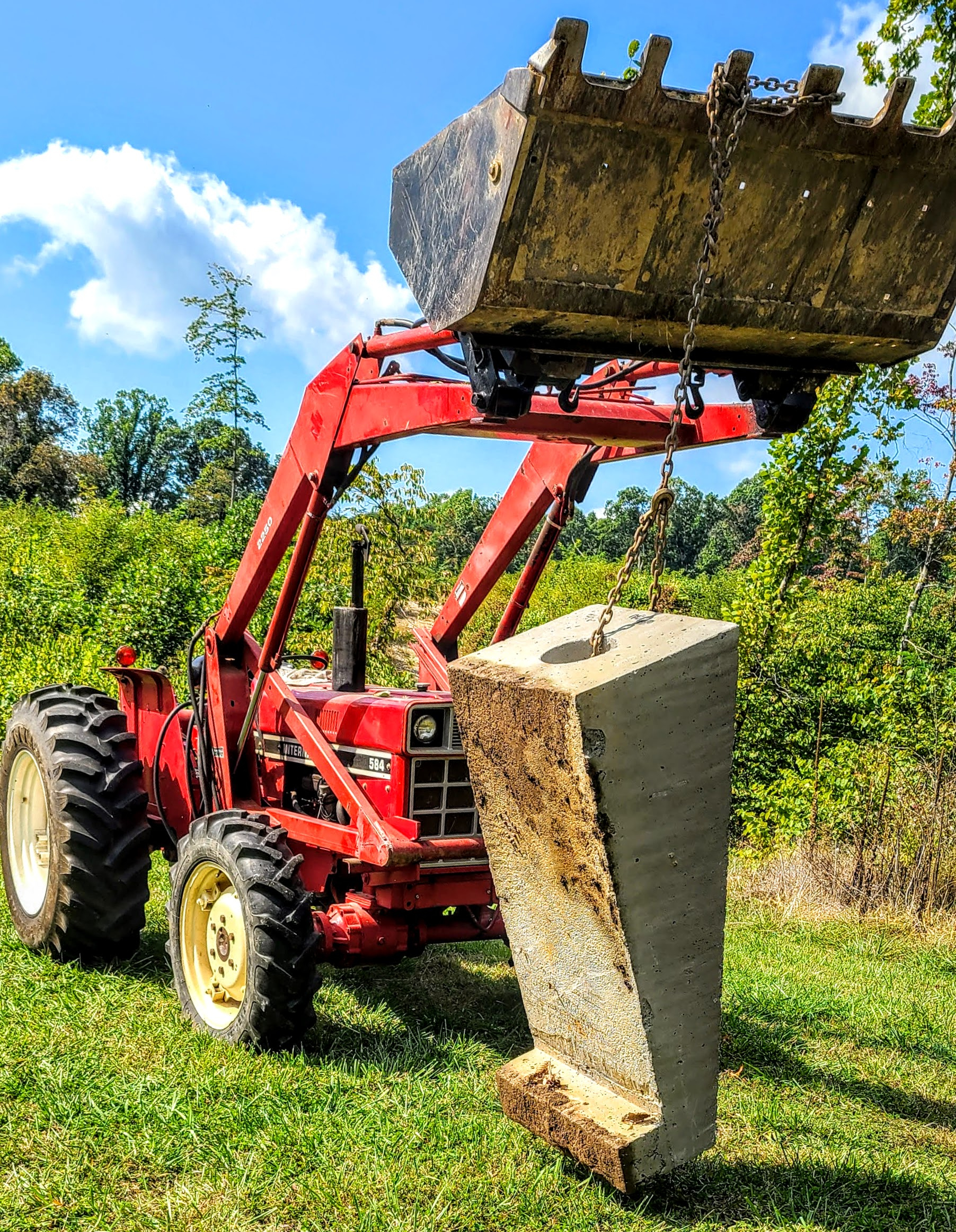

Here the headwall is being placed against the culvert pipe.

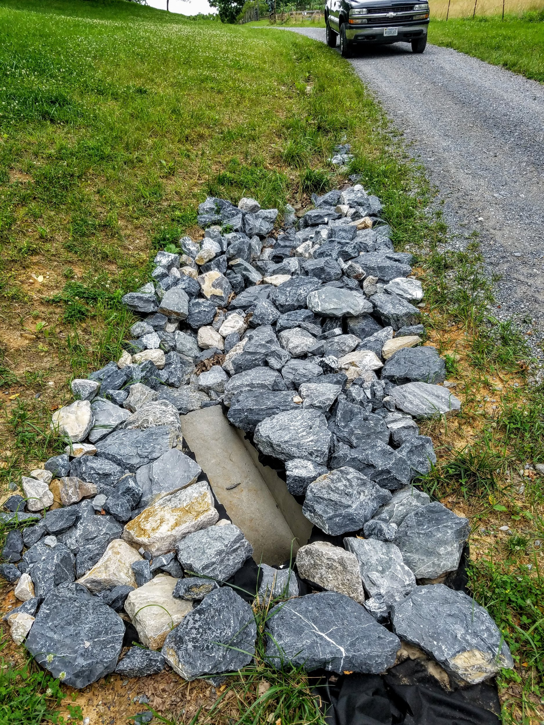

I used the largest rip-rap that could be purchased,,
These pics may be of multiple installs, I started doing these back in 2018,, like I said, there is one more to do.
My culverts used to get clogged with leaves each fall,, not any more,,
The culvert entrances stay spotlessly clean.
   / Culvert repair/extension: Concrete to HDPE #12

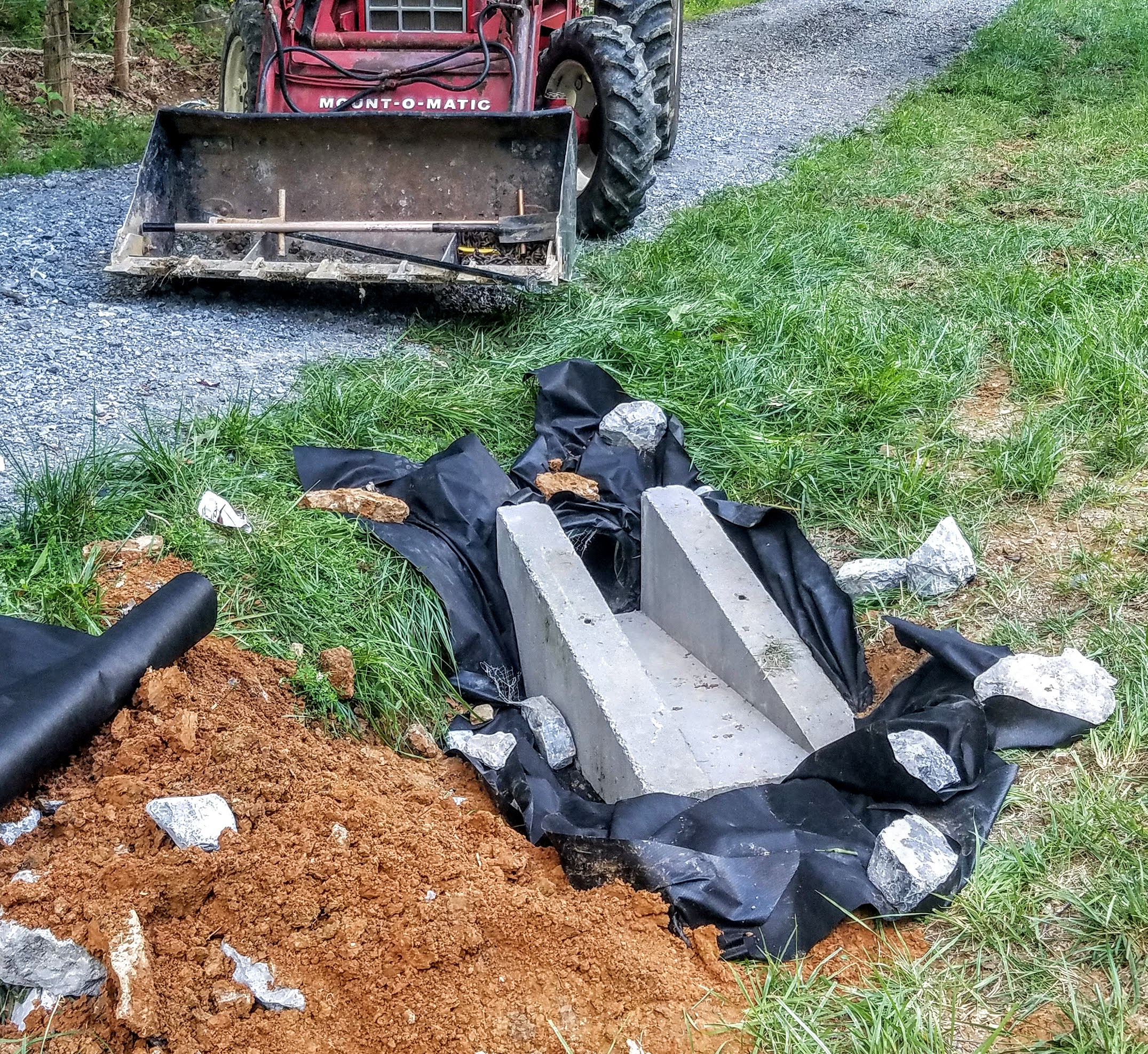

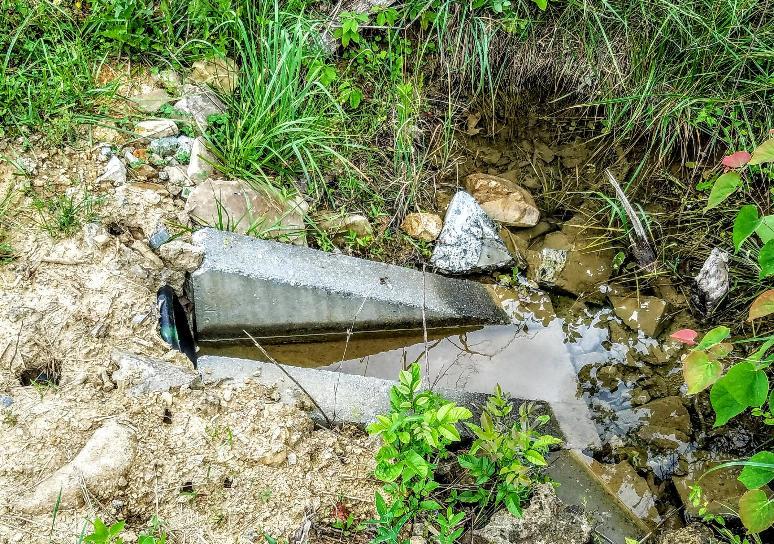

Picture number 3 is the first one I did,,
I had not learned to slope the headwall,,
I may pull that one out, and re-install it,,

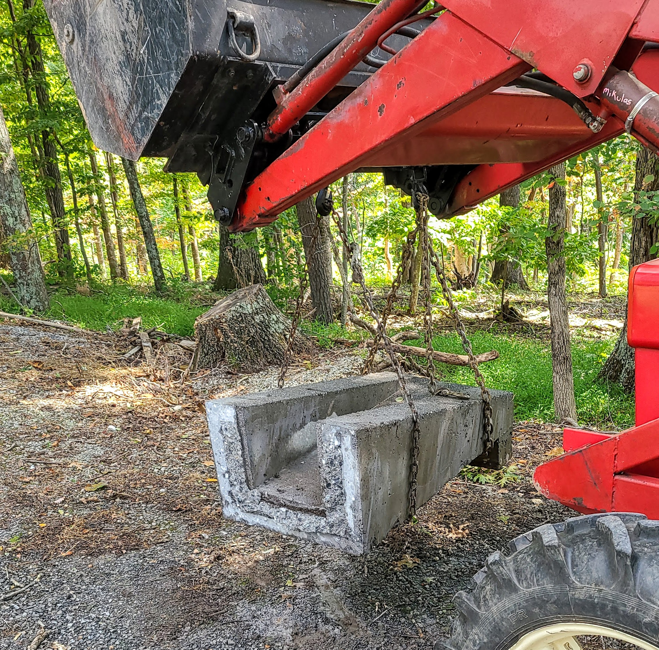

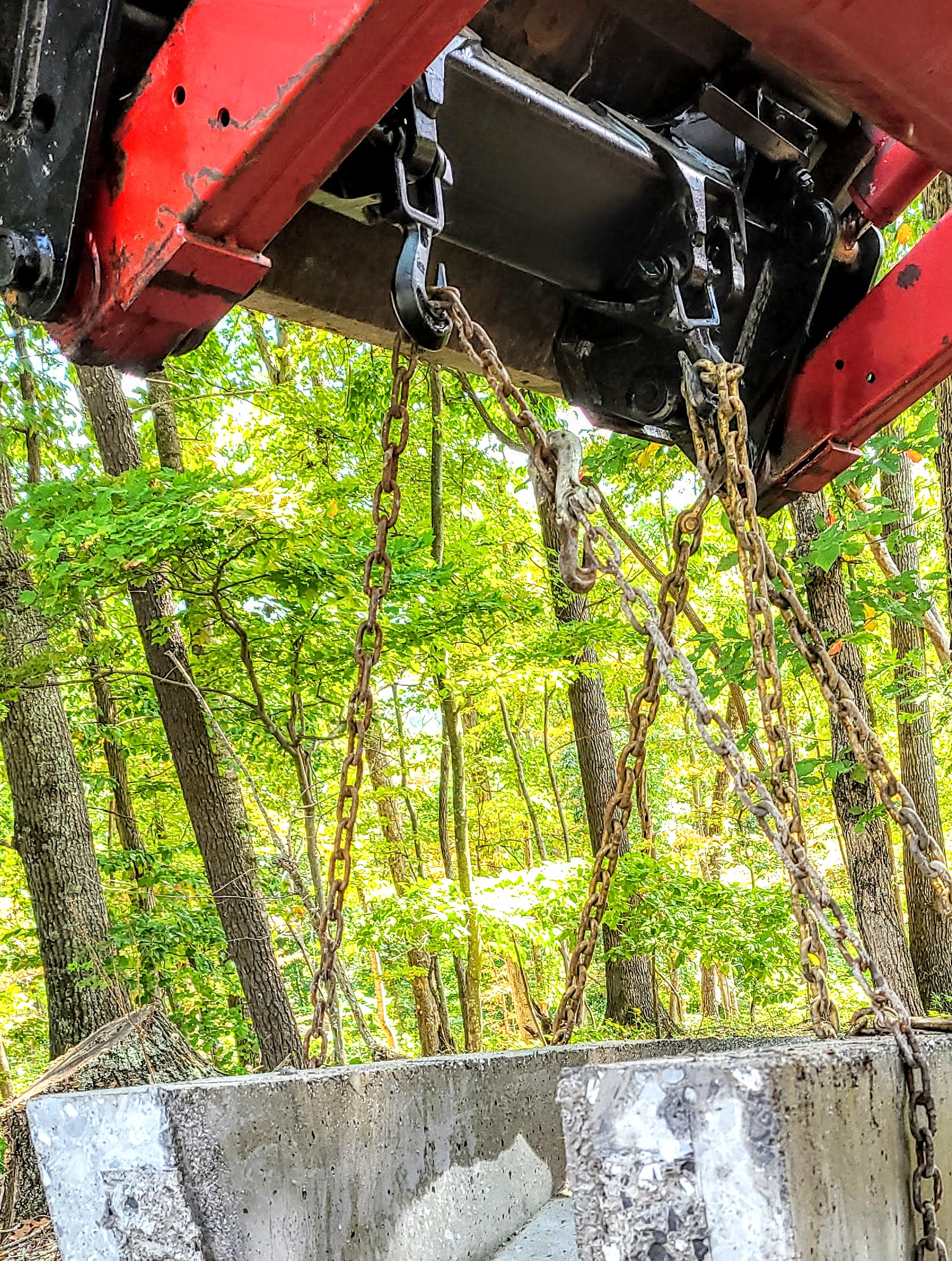

Those headwalls weigh about 2,500 pounds each,, I hauled all of them on one trailer load.
They sure make a culvert entrance (or exit) bullet-proof.

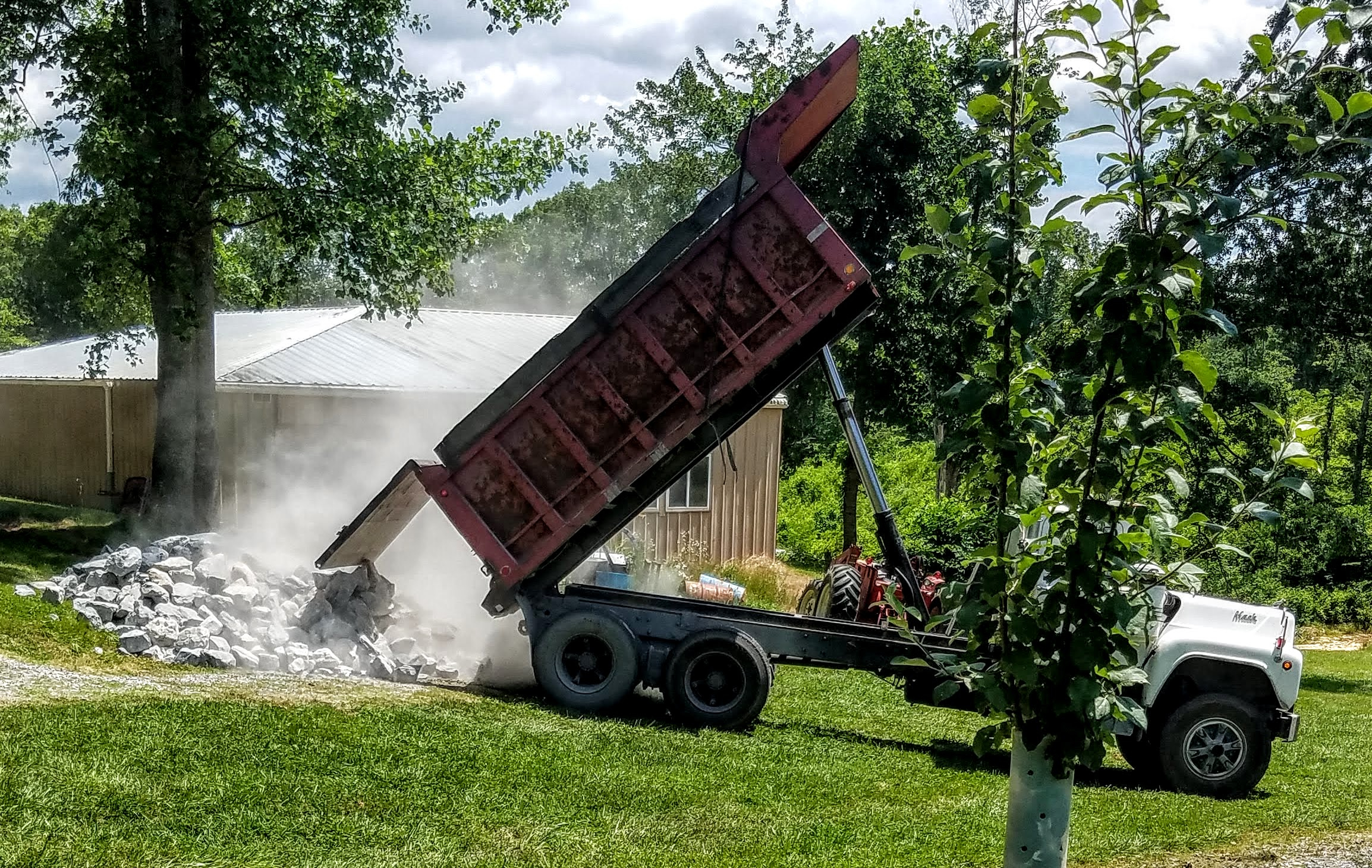

When I had the rip-rap delivered, the driver told me to stay back over 100 feet,,
the rocks are so big, that they come out of the truck,
hit each other, and throw BIG shards of rock EVERYWHERE!!
He warned me when I was ordering the rip-rap, some of the pieces would be as big as a car tire.
I was warned not to order it, unless I had a machine to move the rocks.
In the end, the tractor transported the rocks,
but, I placed EVERY one of the rocks final location by hand.
THAT killed my boredom!! :ROFLMAO:

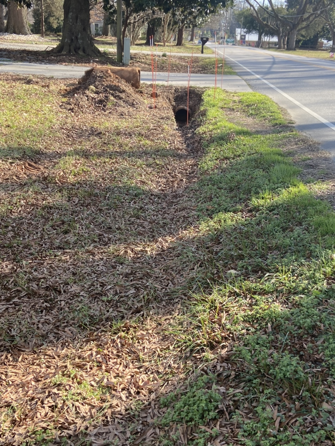

Which way does it slope? Looks more like it just holds water. Would DOT/ county repair it since it’s in the ROW? My old county would give you the pipe at least.
Oddly enough, the state has a culvert/ditch repair request system. As you might imagine, being a government entity, nothing ever came of the request that I submitted.

IMO,, you need a "headwall" more than a piece of culvert,,,
View attachment 729213View attachment 729214View attachment 729215View attachment 729216View attachment 729217View attachment 729218
I have done four of these on my driveway, I got one more to do,,
My neighbor asked why I was doing them,,
I told him,,, "Boredom!!"
