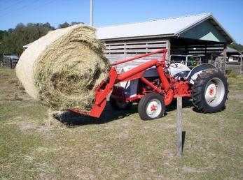

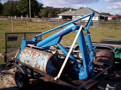

Farm is right. My 660 has a 722 loader on it, and I found a 2nd 711 loader at a junk dealer over thanksgiving holiday. That's what the 850 aquisition was for.
Soundguy
Here's a pic of the 660 with 722 loader.. and then another pic of the 'waiting' 711 loader...
