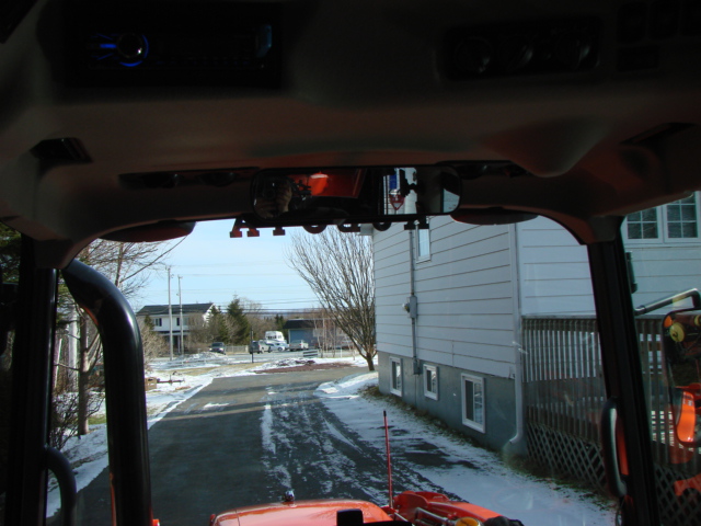

Paul, do you have any pictures of the rear view mirror you installed?

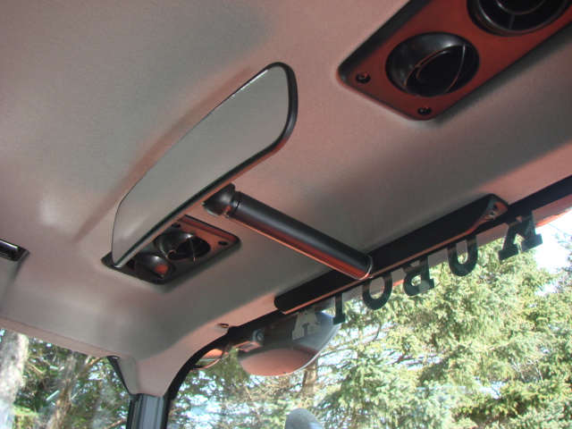

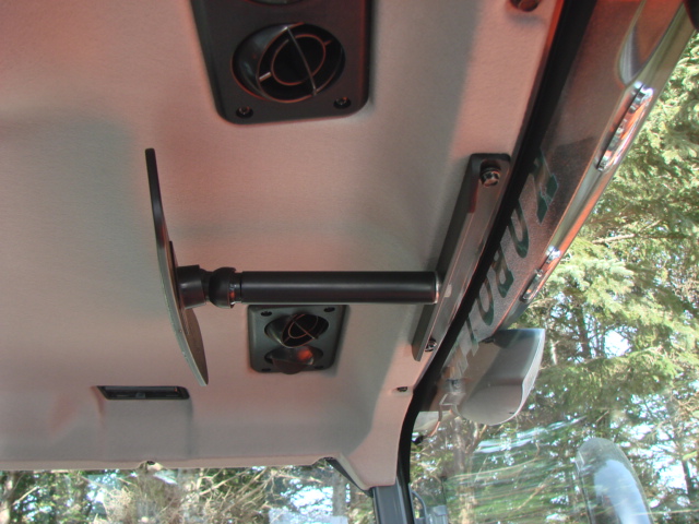

Here you go sir. It's a curved mirror so I get a good wide angle with it. I used the two front head liner bolts to mount the aluminum bracket I made to mount it on and it's up out of the way and causes no blind spots.
I bought the mirror at a surplus store and the name of it was "deer view mirror". I did do some mods to get it to work but they were easy to do. If you decide to go this way I'll remove the mirror and post more detailed photo's. You'll notice that it's mounted away from the windshield. I did it this way so It would not hinder the workings of the heater registers. I did a quick search for you and came up with this link. hope this helps you or someone else out.

That is actually perfect, thanks for taking the time to show me how you did it. There is no need to take it down. I am going to check my cab and see if the bolts are in the same place and if so I am going to build up a similar setup. I appreciate you locating the mirror you used as well, that saves me a search.
