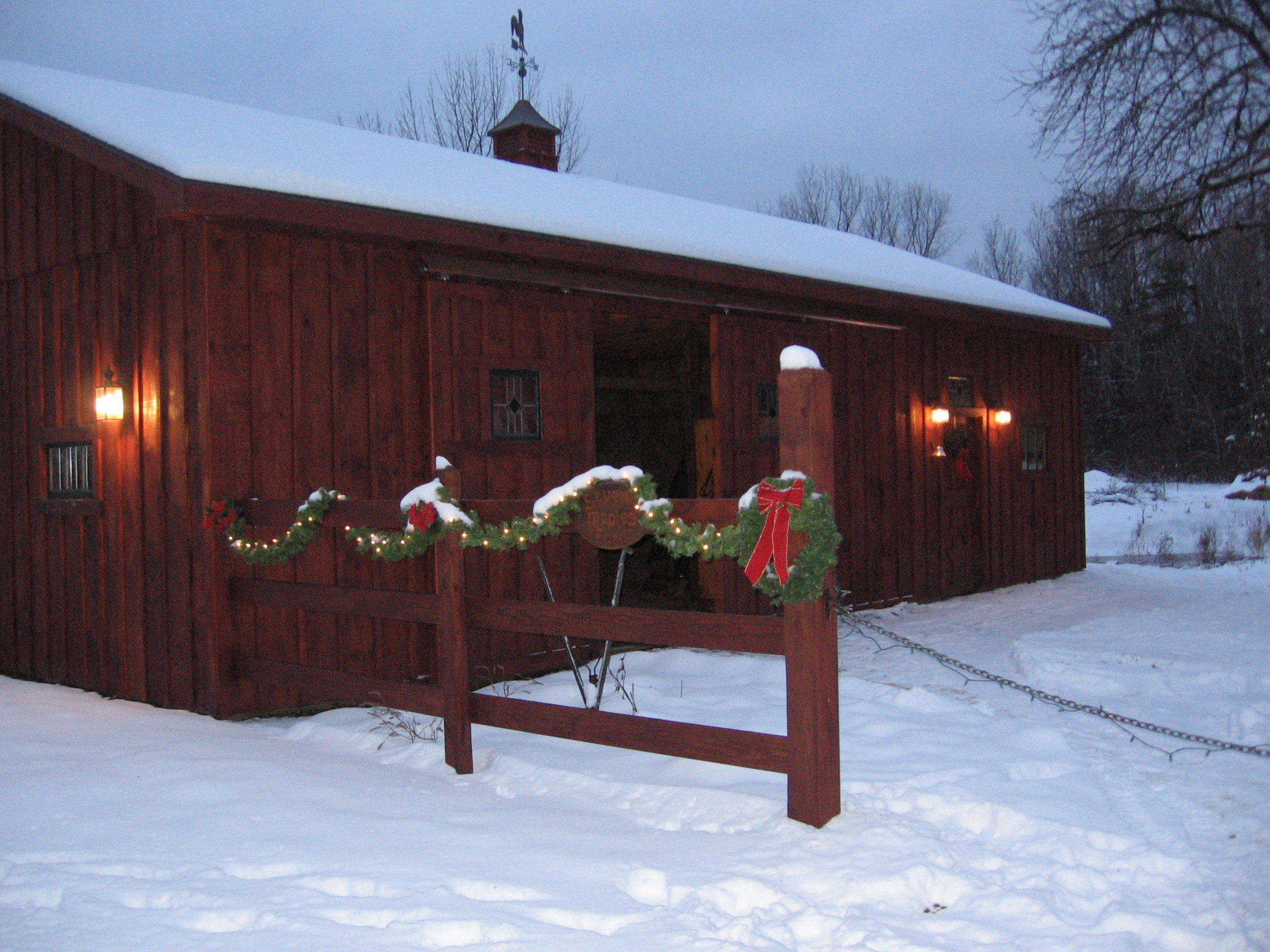

I have a 42" square cupola on top of my tractor barn. Whenever a windblown rain comes through I get water coming in through the cupola vents. The cupola was installed over the roof trusses so working on the inside of it is difficult. Any ideas?
Here is an older picture...

Since it's a wind driven leak, and it looks like it's part of your venting system, you might have to live with it. Changing the angle of the louvers would help, but it would be a huge undertaking. Blocking off the vents will stop the air flow.
I would caulk and paint the interior to make it water tight and let it be.
If that's not an option and you absolutely have to stop the water from coming in, then I'd seal off the vents and come up with another vent system.

As a band-aide you could suspend a drip pan from the trusses directly under the copula. I would suspect most copulas leak during a driven rain (many modern roof vents do as well). It sure is beautiful though. Copper roof?

How tight is the wire screen behind the louvers? If you need to you could put a fine mesh screen on the inside of the vents and that will keep the big drops of water from coming thru. Then you could put a small piece of metal on the bottom of the screen to move the water back out thru the vent. It won't stop all the water but it should stop a lot of it.

When my dad had this problem, he made a tin box that he put behind the wind driven side. He put a small drain in the bottom and a small hose he ran from the drain to the outside bottom of the cupola and onto the roof. It solved his problem.

The cupola roof is copper. I had it built by an Amish cupola maker. I used some chemical concotions to help speed up the aging procees and turn it green.
There is a fine mesh screen on the inside tight against the louvers to stop bugs/birds. I was going to reinforce it with some heavier duty screening but haven't gotten around to it. When water comes in it lies on the 2nd story floor. For now I have put some left over metal roofing on the floor to catch the rain water. I thought about a drip pan. I was thinking of suspending a small plastic kids wading pool below the cupola and drain the water with a hose out through the soffit.

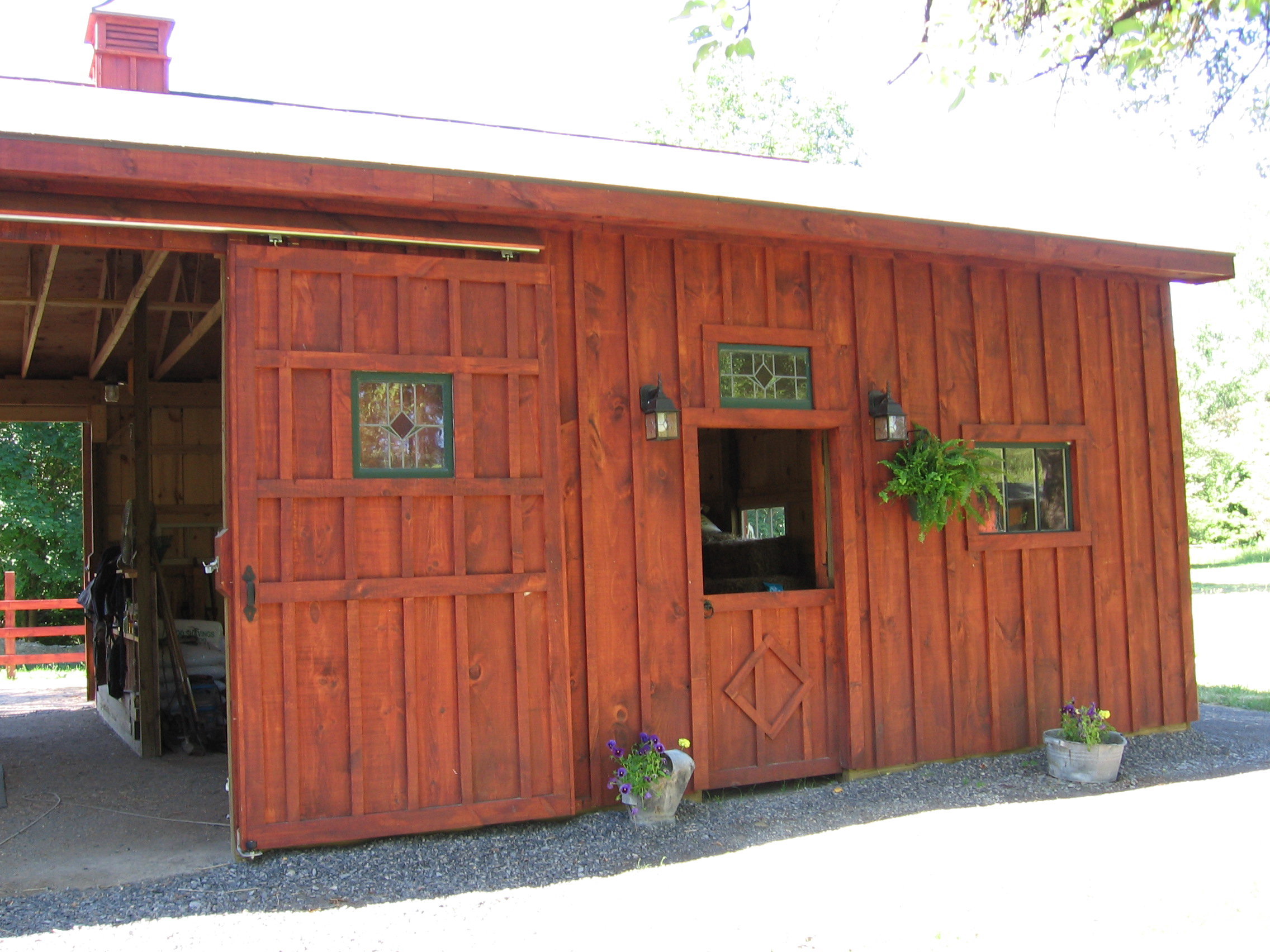

Thanks for the kind words. Before we had the barn built I looked at local builder's ads and pictures on the internet. We showed the pictures of barns we liked to an Amish barn builder and he made the plans.
Barn is 24'x48' with an 8' overhang. Wood is eastern white pine. I had it stained with a cedar colored stain. 1st floor walls are 10'. Sliding doors (on both ends so I can drive the tractor straight through and for cross ventilation) are 10'. Roof trusses were used and the 2nd floor has knee walls. Plenty of headroom on the 2nd floor. In order to make it simpler the dormers were built between the trusses and a small plywood walkway between the same trusses gives me access to the dormer windows.
The one thing that didn't turn out as expected was the stairs to the 2nd floor. Since the barn is only 24' wide they couldn't start in the corner and run straight up without getting in the way of the doorway. Builder made the steps turn after going 1/3 of the way. I didn't want to cut the floor joists (which were part of the rafter system). I can't carry anything too big up the steps but I do have doors on the 2nd floor. You can see the steps in the upper right corner of the door opening in this picture...
Everyone here said "build it bigger than you think you'll need". They were right. I'm really happy with it but I should have made it a little bigger. It's filling up quickly. But it has been really useful. It's on a piece of acreage we bought 2 years ago but are not moving to for another 2 years. After I move there I'll put in some windows on the 1st floor. Since we're not there I didn't want to anyone looking in even though it is almost 1,000' from the street.
I'll try to take some pictures this weekend. Let me know if there are any specific features you want to see.
