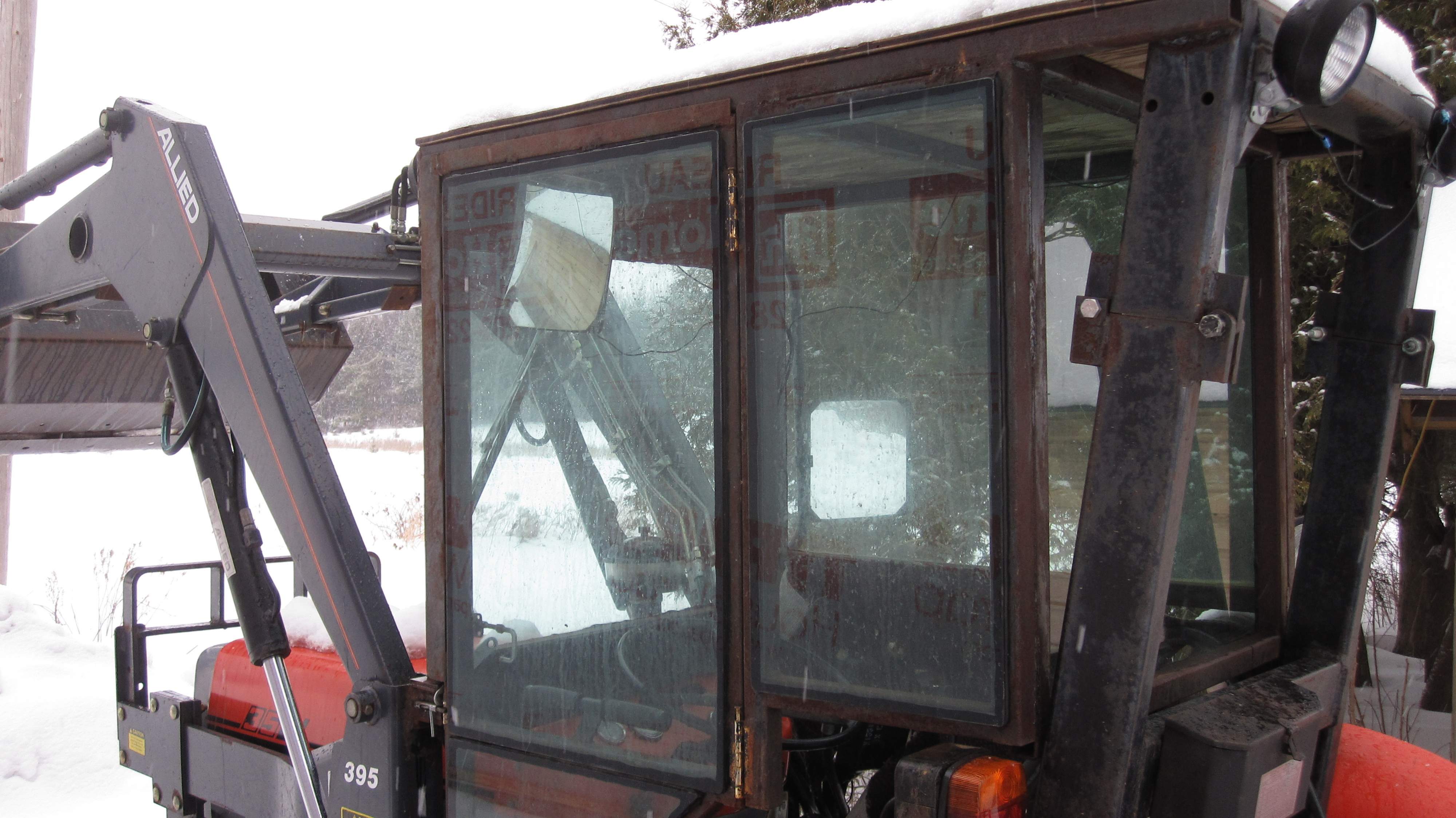

My neck was getting so sore from owling around backwards while moving snow that something had to give. I arrived at the junkyard just when the crew was preparing to "kill" a school bus. The owner offered me the mirrors for $50.
What I took home consisted of two banks of two mirrors, a flat and a concave in each set, and the sturdy frames with which they were mounted, along with four clearance lights, also mounted on the mirrors.
One mounted on the right to aid backing up, and a convex mirror found itself screwed to the roof of the cab. There's all kids of headroom in there, so why not?

All I need to do is back the tractor up along its track and avoid some rubbernecking when cleaning up out at the road. The right-hand mirror would do it, except for the blind spot. The interior mirror's convex, and should let me check the blind spot frequently. The door's on the left, complicating an exterior mirror installation on that side.
Reversing the controls wouldn't work. I use the loader most of the time.

The mirrors work very well. I was able to do a half-hour of snow removal this morning without any painful neck movement. Vibration on the exterior mirror was not a problem at the speeds I operate while plowing with the loader.
The point of this thread is basically that junked school buses are a great source of mirrors and hardware for their installation on tractor cabs, and the things are hardly scarce.
