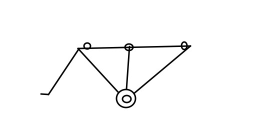

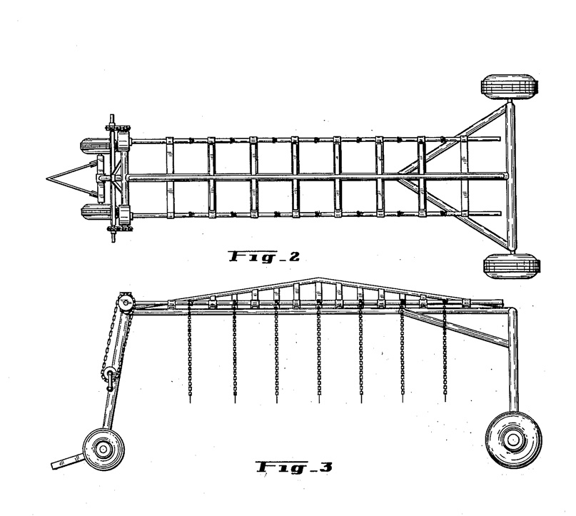

   / Curious How They Use to do This? #6
In the late 1950's and 1960's we moved them from field to field with an implement carrier, like this one from a 1963 patent application:
You pulled the carrier into the field over the implement with a pickup, lifted the implement with the chains, then drove off to the next field

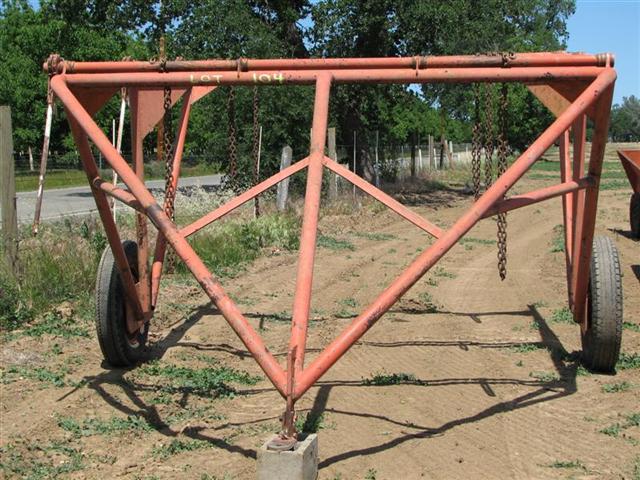

   / Curious How They Use to do This? #8
Never saw one like that. In the SW, they were mostly this design.
Side view. Three winches on top, usually made from a differential, and crank and chain at operator level.
Every rural intersection had a pile of tires for cats and discs to cross the road. Shoulders were all wide enough for equipment to use and stay off pavement.
