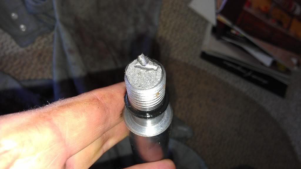

update - removed the cylinder and the rod pulled right out....You can see where it broke
   / Curl Bucket Cylinder over extended on VTEK? #12
Well alrighty, your on the way. :thumbsup:

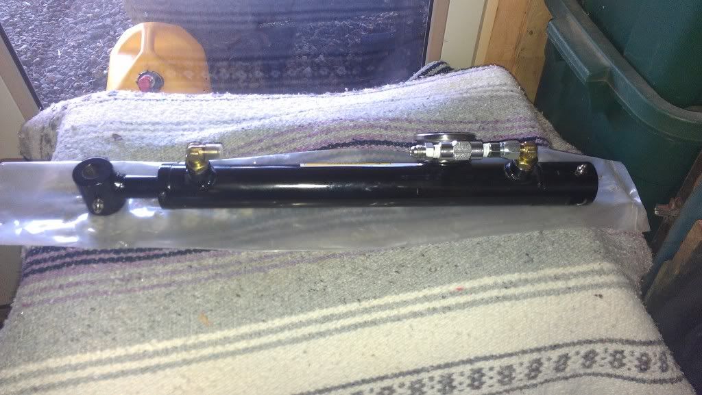

I have to say....I called VN1 Tractor on Monday, ordered and had shipped same day. Received on Wednesday via Fedex ground. I then brought the new cylinder to a hydraulics shop to see if they could match it up and to get a T so I can add a temporary pressure gauge to test the system.
They said it looked like a quality cylinder but custom made due to the size of the end cap welded on and zerk fittings already installed...for what that is worth. In any event - they remeasured the rod and case and its a metric cylinder (no surprise there :) - OD of the cylinder is 50mm and the rod is 25mm. the pin is 3/4". Hope that helps if anyone else needs the info.

I posted this over in the Hydraulics section as well....but any idea why when I installed a pressure guage into the system that I received a ~2100 psi reading with the curl bcuket all the way down and only 600 psi max when all the way up?
   / Curl Bucket Cylinder over extended on VTEK? #18
I wonder if there is an adjustment on the curl spool valve to either set the center or the over travel is all I can think, it is a 1 stick yes and not 2?
The other thing that comes to mind visually is the gage is in the extend port so maybe there is something in that end of the cyl that hasn't sealed yet or maybe putting the gage in the pressure "in" port on the joystick control would give better measurements?
#19
In a stroke of genius caused by my own stupidity....I started thinking....that shouldn't I measure the pressure on both sides of the cylinder????
When I moved the guage to the other cylinder port...whammo - 2100 psi. the 600 psi must be the back presssure the cylinder see's when on the return side.
   / Curl Bucket Cylinder over extended on VTEK? #20
I don't understand why you would have 600# back pressure unless the 3 point is someway loaded. If your 3 point is unloaded your back pressure should be close to zilch, nada. Maybe a few pounds, but not much.
