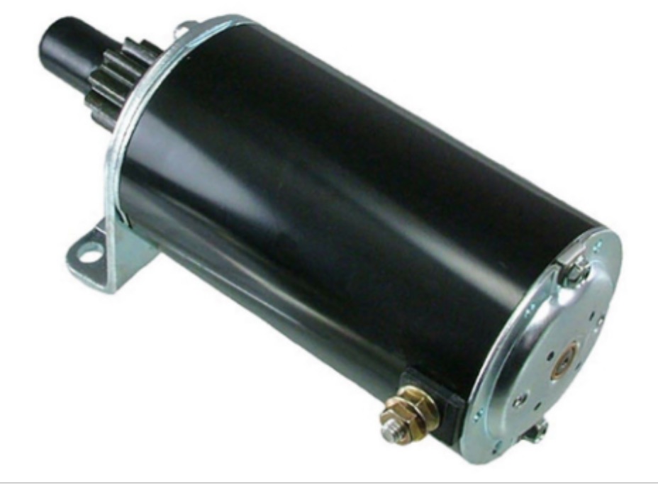

Read what rScotty has to say....
This should be you starter solenoid.....
(image unceremoniously ripped from GOOGLE IMAGES)
Putting 12 volt (+ from battery) to small screw terminal should energize solenoid and close main contacts (large screw terminals)to put power to starter .... People have been known to short across the two main terminals to get starter to spin, this bypasses every safety feature and safe procedure know to small engine work.....
One main termial of solenoid it should go to stud on starter, the other main terminal should go back to positive (+) post on battery....

Right. I'm thinking as Dale is that this starter has a remote solenoid rather than a piggybacked one.
Does this look like your starter?
If so, if it is any good, then touching the positive cable to that single exposed terminal should make it turn regardless. If it doesn't you need to replace it - or at least open it up and figure out what's wrong inside. Sometimes it is simple.
Oh... and very rarely, it can happen that the starter has stopped in exactly the wrong position, and if you bang on it and can turn it just a smidge it will work again. Worth a try if you get it out. You can test it on the bench - but hold it down - by hooking battery negative to the case and touching positive to the terminal.
I see that starter on Ebay for $80.
rScotty
