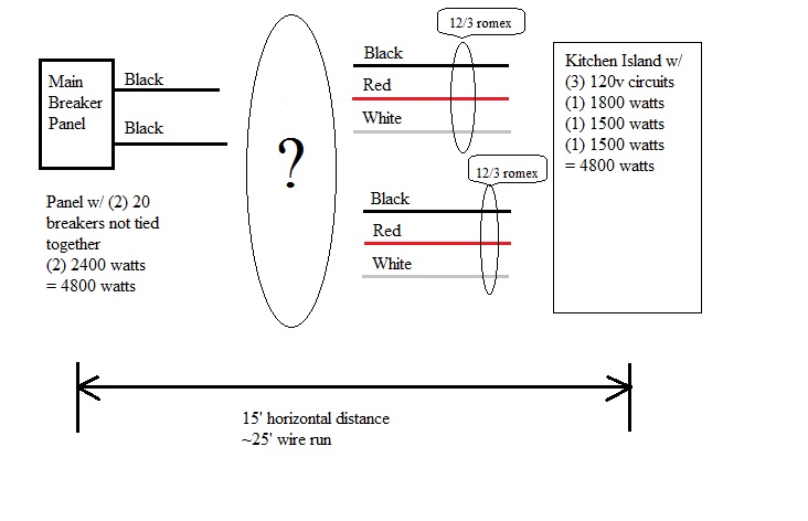

Here's the diagram
: One of the 120v 20a breakers will be removed and replaced with a 240v 20a breaker and one of the 12/3 romex will be extended to the breaker panel. That will handle the dishwasher and the 120v water heater. The other 120v 20a breaker
And I agree, it all needs to be checked by an independent inspector.
I probably need to re-read, and missing it. But why are you replacing with a 240 breaker, if both loads are 120?
Each leg of breaker is 120, serving same purpose as tie handle.
   / Current on a 12 gauge wire #138
Ok, this is because sharing neutral.
Reading up, code changed in 2008 to require a tie between the 2 circuits. Probably a good idea. I am not sure if I have shared a neutral in a long time. Most of the stuff I do is single point, or wiring a garage that would have panel or a sub panel.
I had not heard of using a 2 pole breaker, but I guess it is the same idea. Given so, no need to be scared of a string.
If you lose the neutral, you could potentialy have 240.
Myself, small subpanels have gotten very cheap. But the problem is a homeowner may not understand these. Circuit trips in sub panel, and they con't know it is there, everything fine in main. I have heard of this happening. Good labels help.
It does have me thinking, if I have any work out there, that has shared neutral.
12/14-3 is alot more common than 4 conductor. I suspect lots of places have, you pull 12-3, one for lights, one for power. Alot of them do not have tied handles. But it is a good idea.
