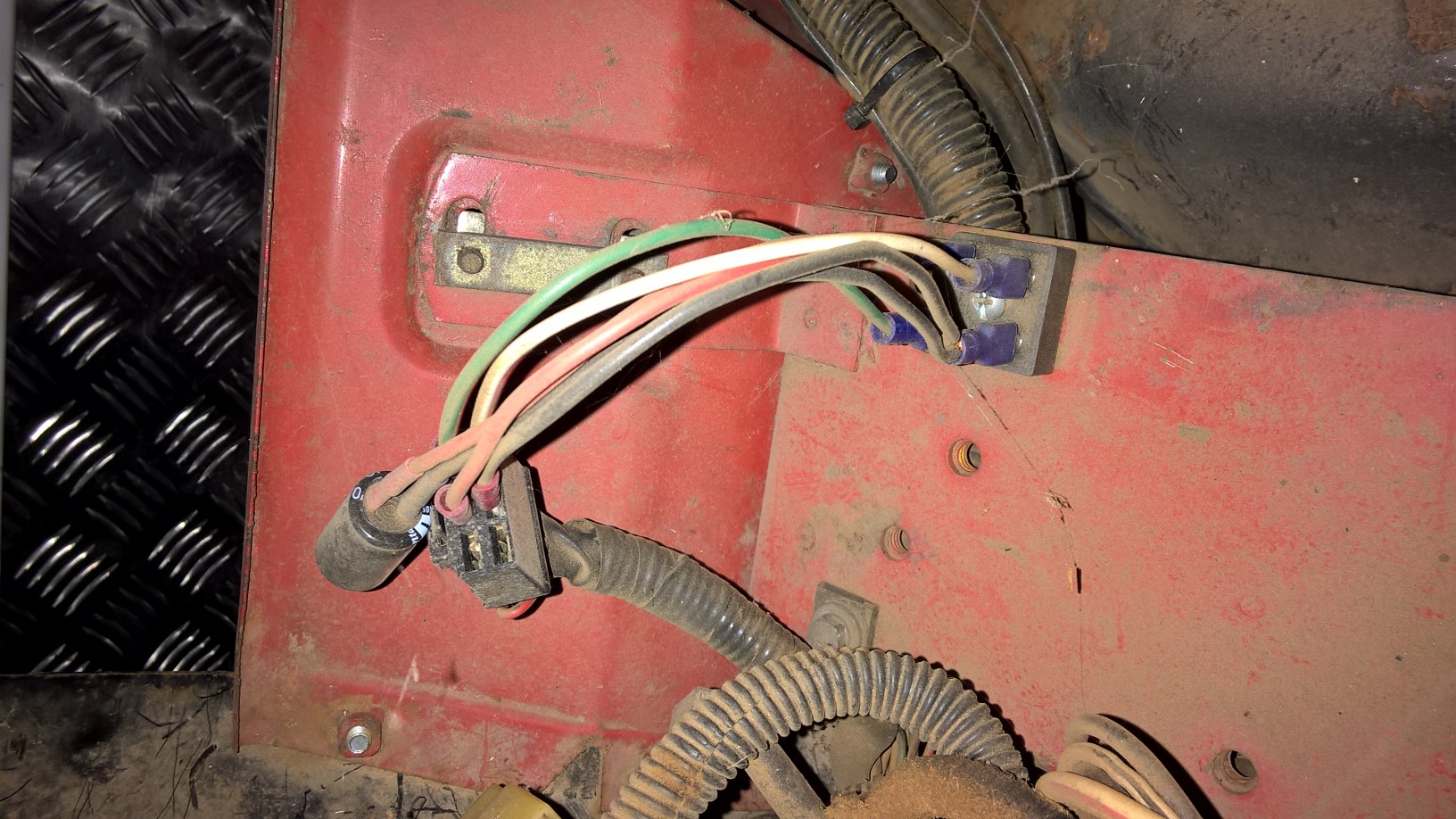

The reg California is talking about is used on many Yanmar tractors too including my YM14 which didn't have one when I bought it. I looked at buying one but needed something quick so made my own using a bridge rectifier and a capacitor for the interim, which has now been 7 or 8 years..... You could use any of the combination of regs they have as long as it has the 2 ac in terminals and a B+ out which really is all that is needed.

had a look at uk suppliers this morning, all sourcing parts from the states, stupid prices and lead times, so it looks like its time to get the soldering iron out, one home made rectifier comming up

here's my shade tree mechanic reg, works beautifully :thumbsup: WP_20160404_21_12_11_Pro.jpg

well, less than £5 worth of components and 1 diy regulator built, after getting a price of £149-00 from one supplier for the same regulator sold in the states for $35-00, and telling them where to go, decision was made

One of these VS-26MB5A. - VISHAY - Bridge Rectifier Diode, Single, 5 V, 25 A, Module, 1.11 V, 4 Pins | element14 Australia and one of these 47uF 25V 15C Radial Electrolytic Capacitor 16x26 | eBay and a bit of wiring and you're all done. Simples eh? Oh and here's how it's wired. The capacitor goes across the DC output (polarity concious) Google Image Result for https://upload.wikimedia.org/wikipedia/commons/thumb/f/f5/Diode_bridge_alt_2.svg/2px-Diode_bridge_alt_2.svg.png And all for the princely sum of $10.
