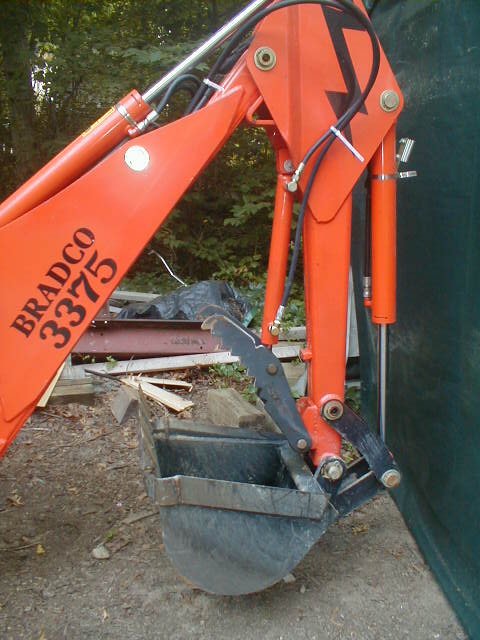

Hello Nasdagsam looks like everyone needs a hydraulic thumb i used the columbus cylinder in the link from surplus center and cut off both ends and milled up some new ones and welded them on because of the same problem you ara haveing take a look at picture i also purchased a mv3 midget sectional control valve removed one of the valves and milled up a foot control for the thumb works great!!!!!!! Good luck with your project!!!!!!!!!
Michael

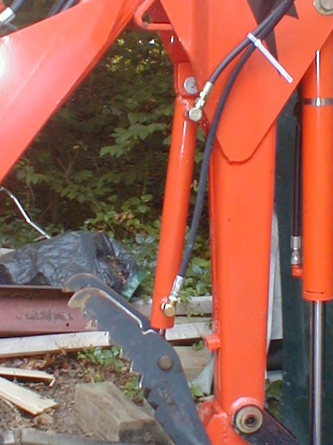

   / custom built hydraulic cylinder? #13
A close up

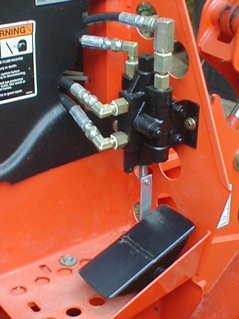

   / custom built hydraulic cylinder? #14
Valve and foot pedal

Michael )</font>Michael, Nice job. I like the foot pedal. I can see where that would be a great advantage over the lever. We are sending the cylinder we have out this monday to do exactly what you did. I also see you put a stopper on the stick to keep the thumb from curling back and locking up. I like the way you did it.
Thanks for the pictures
