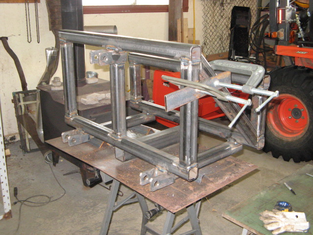

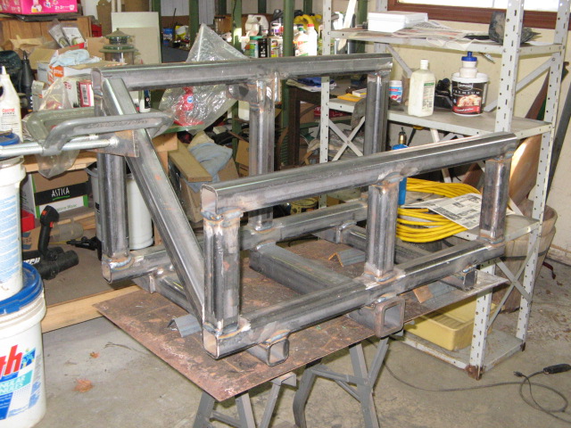

Here are a few pictures of my counterweight build
2x2 .250 wall tubing
I figure it will weight about 100 lbs when complete and will have a 300lbs block of concrete
It will be a multi purpose counter weight with a removable concrete block.

a friend of mine who builds a lot of prototype farm equipment uses plastic water tanks, and that way the weight is easily removable and or fillable.
looks like a good build
   / custom counterweight
Thanks. The water tank idea is a good one but I didn't want to worry about it freezing in the winter.
sorry for the sparse details, I didn't have much time last night to post between putting the kids to bed.
Like I said this will be a multipurpose counterweight with hooks to carry chains in the woods and one hook on the back to skid out logs. It will also have a vise in case I need to sharpen the chain saw. And I will put pins on it to hold the two ball mounts I use, one with a ball and one with no ball mounted for my wood hauling trailer.
I will also put a bracket on the back top post so I can put smaller branches into it and they will be held off the ground for cutting. I cut anything over 1.5" dia into firewood lengths. this idea came from those comercially available log holder stands.

the chainsaw rides in the bucket with the tool box, gas can, oil jug and peavey.
so far I figure about 120$ in steel and about 15 - 20 hours but I'm no pro I take my time and I haven't been able to work a full day on it yet, just a few hours at a time here and there.
I could have probably been able to use 3/16 wall tubing to save on costs but hey, Its a counterweight it needs to be heavy and I'm not really worried about bending it.

I made a few mistakes on the first build. The center post on the back section blocks the view of the hitch ball to line up the trailer when hooking it up so I have cut it out and need to add two posts that are spread out. It has legs now but the receiver is a little to high off the ground now with the legs so I have to add a new receiver down lower.
I'm still quite far away from paint and a finished project. I like to use my projects a little before painting then so that mistakes are easier to correct. I will try and post some pictures of my progress.
