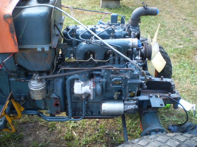

Has anyone reading this painted their tractor before? I know sanding down to bare metal and using primer etc will get the best results, but most of the paint is still pretty good (but faded), and I am not looking for a showroom finish. The Kubota spray paint is very expensive ($11.50 a can) and so I am looking for a cost effective solution. Thoguht I would run to my local paint store today to see what I find. I was also wondering about painting the engine, do you need special high temp paint for that? Not sure how hot the deisel engines get.

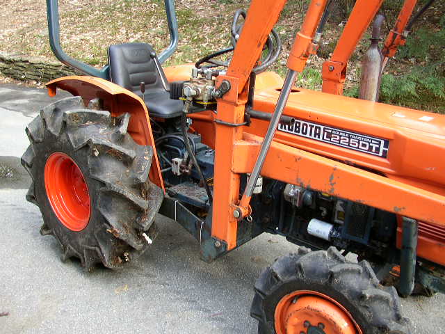

If you must abandon the external system, the way people really tap into the internal hydraulics is not by cutting the tubing. There is a hydraulic block - on my L225 it was under the seat on the right side. (see pic below) If you follow the high-pressure pipe from the bottom of your pump it goes to a rectangular block with 4 bolts holding a cover on it. On the parts diagrams the cover is part 064 on the Hydraulics 2 page. The cover can be replaced with a block with connections for running high-pressure hoses out to the loader valve and back.

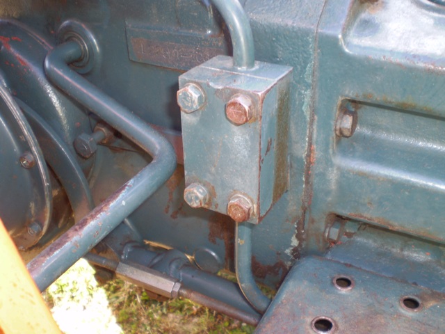

That is some great advice about not cutting intot he hydraulic line if you don't need to. I was there this weekend and followed the pipe to a block which I assume is what you were referring to. I took a picture and will tray contacting Ronnie and see what he can come up with for me.
I still think I am going to go this way though, I am not confident the orginial design is still viable with end of the crankshaft being in tough shape. If I can go the connecting block route, it seems that I would still be able to fall back to the orginial if I wasn't happy with the performance. And the cost savings seems substantial.
I didn't see any picture that you were referring to, maybe it got lost in cyberspace? I have attached one here that I would guess is simialr to what you were talking about.

Yes, that's the block.
I see the link got cross-wired. (I probably had two browser windows going and mixed them up - old dig, new trick, etc.) Here's what I hope is a better link. In the 10th post there's info on the part number and price for the block for a L345. The stock cap on the L225 looks different - Ronnie may be able to steer you to the right part. If not, a machine shop could make one using your cap as a template. The cap now connects the two ports together - it just needs to separate them to route the oil out to a valve and back.

The block on my L225 is visible in this pic
