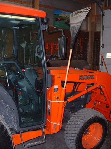

Did you ever put a shovel into your fel bucket and drive to the ole' dirt pile and dig right in for a full scoop and not realizing until you dump the dirt that you forgot to take the shovel out of the bucket /forums/images/graemlins/blush.gif /forums/images/graemlins/crazy.gif Well here's a handy little add-on the puts that shovel or rake in the right spot /forums/images/graemlins/grin.gif.

I made the holder out of 2" PVC pipe with a cap glued on the one end. The cap has a 3/8" hole drilled in to let any water escape. It is attached to the fel arm using 2 large zippy ties like you would find on your home central air system. On my cab model tractor, I tilted the holder forward abit so the tools would not hit my mirror. Here's another photo.

Take that baby out Salmon fishing. /forums/images/graemlins/smile.gif
   / Custom rake and shovel holder #4
Re: Custom rake and shovel holder
That's a good little item, but just remember not to go in the woods with it, or you'll be replacing handles on a regualr basis. I could break that off in a heartbeat out here in my woods where I'm constantly clearing something! John

Nice, useful atachment. I am especially impressed wth the attention to detail; i.e. matching paint.

Let's not even get into the subject of loosing chains /forums/images/graemlins/mad.gif. I'll be making some kind of storage box for them also. Just don't have the time right now. For about $3 I thought my shovel - rake holder was rather inexpensive and very useful for spring cleanup.

why not u shaped brackets on top of FEL bucket with bungee straps and small shallow ammo box for chains. Just my 2 cents worth.

I'm thinking something like the ammo box setup, but I may have to have more than 1 box. A 3/8 x 20 ft. chain takes up about 1 box.

I found some heavy guage plastic (1/4") 30 round 25 mm ammo boxes that open on the top & bottom. They are about 4"X14"X14" for 6 bucks. Have not tried to put the chain in them yet to see if it fits. I will U bolt them to the FEL bucket or the ROPS. Will send photos if the chain fits. I will let you know. The surpluss joint has about a 100 of these left.

I have seen others on tractor forums who made holders out of steel, say 4" X 5". I think thats what I will do. But I may make up several PVC tubes (I paint them Kubota orange of course:) just to zip tie on for temp jobs.

You can't beat PVC for this application. It's inexpensive, lightweight and paintable. It makes a permanent setup. I had them on my other Kubota for years.
