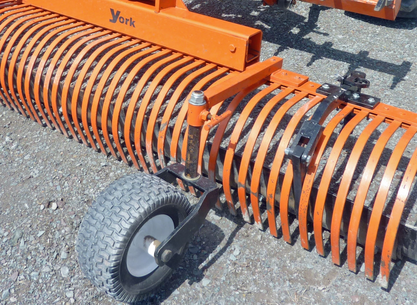

The York rake has a bracket bolted to the frame on one end and a short sleeve welded to the other. A threaded T handle screws into the sleeve and allows for height adjustment of the wheel yoke.
There's a big difference between $1,200 and the York $3K to $4K for something not used a lot. Everything is going to be better if it's double or triple the price.
