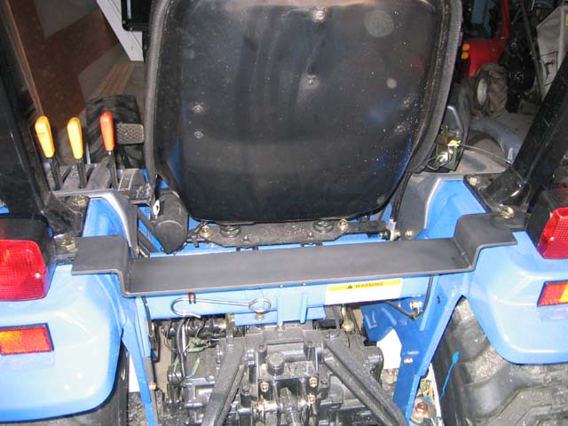

Here is the picture of the bracked I bent out of 2" wide steel. I had to cut notches on both ends to clear the rear lights. I could have used 1" but I had the 2" stuff available. I also figured the wider steel would make a more solid base for the box since the box will not be centered on the base plate.
The other problem I had was that I have a rear auxilary light on the tractor and I wanted the tool box to fit behind the seats but not to hit the light.
I solved the problem by getting a Craftsman truck box designed for the back end of a Dodge truck. It is about 8" deep, 16" wide and 18" tall.
The attached picture is the base plate being test fitted using the rear to ROPS bolt holes as my point of attachements.

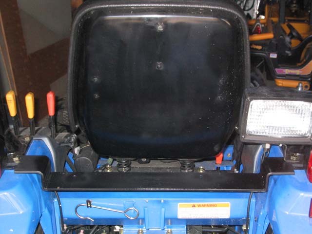

Here is a picture of the base plate, with the Aux Light mounted on its original bracked. The whole assembly is bolted in place using the original ROPS bolts and the original holes. I obviously drilled a couple holes in the base plate to line up with the ROPS holes, but I wanted to make the bracket so that that it did not add any new holes to the tractor.

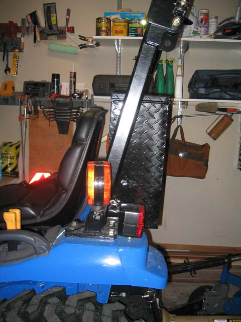

By the way, here is a side view of the box, so you can see how it fits over the 3pt and nicely inside the ROPS bars. Even with the 3pt all the way up, there is plenty of clearance.
There is also a top link clip that is still accessable under the box so I did not lose that functionality when I installed the box. Had I lowered in about 3" instead of 1.5" I think I might not have been able to connect the top link to the clip when it is not used.

Dos_Perros . . . I figured out a while ago, while playing with cars that putting holes where they don't belong ususally leads to lower resale value, cracks developing, or the eventual rust problem that the hole creates.
By looking at the problem for a while, and deciding what I really wanted to accomplish, the ROPS bolt holes really became the logical point to connect everything to.
My goals were a large box, no new holes, structurally solid with no bouncing, and still maintaining the original functionality of the top link clip and the original tool box while not creating a situation where I had to remount the rear Auxilary Light.
I believe I was pretty successful in accomplishing all those goals.
I had a lower priority goal that was not accomplished. I wanted a place to mount a shovel, digging fork, etc. I had hoped that there would be sufficient room to clamp them to the sides of the box somehow, but that does not seem possible from any of the angles I see. Mounting to the left side would prevent the box from opening. There is no clearance to mount to the back because there is not enough room behind the seat. I may end up with a shotgun style rack mounted to the ROPS bar to carry shovels, etc. But that is a project for another day!
