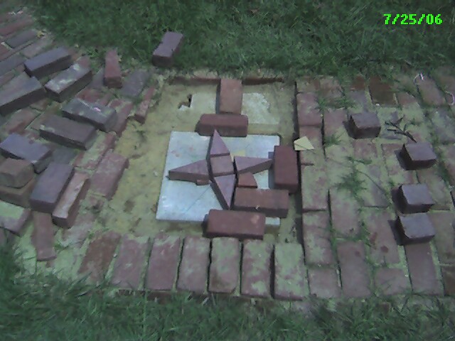

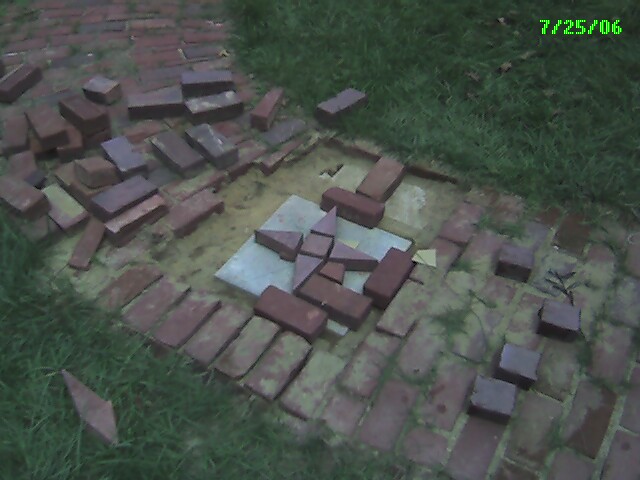

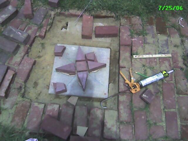

Here are some pics of using a tile saw to trim bricks to a compass rose - yep, its accurate to true north, declination adjusted. Glued to a 18x18 concrete paver. It marks the location of a septic cleanout - just pull the surrounding bricks out, lift up the paver, and easy access

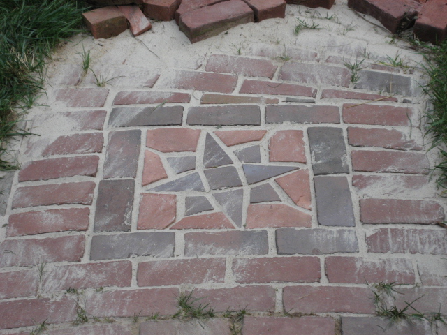

Finished pics, brushed sand into joints to match existing walk
