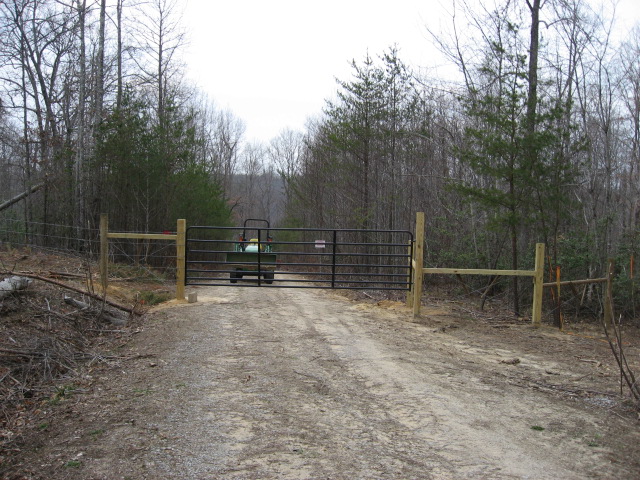

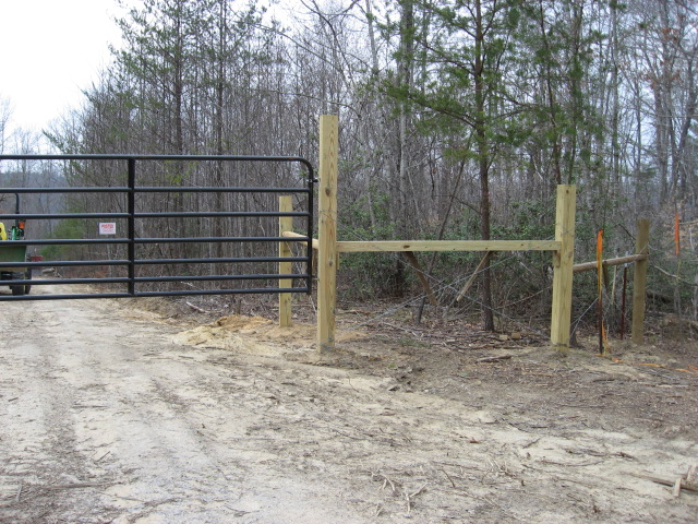

We finally got a farm gate put up on the road. I'm trying to keep out uninvited traffic (i.e. 4 wheelers, partiers, etc.) to minimize potential liability lawsuits. The gate is a little over a foot off the ground at the lowest spot to make room for gravel.
As you can see from the pictures, the road drops off steeply on the right side. I need to raise the road on the right side about a foot.

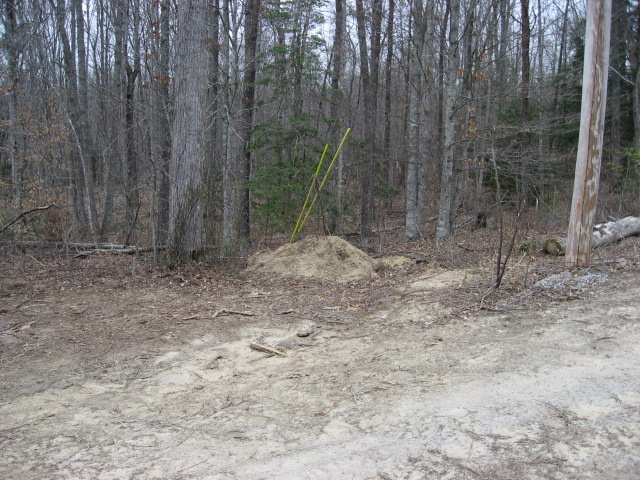

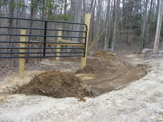

There were a couple of existing piles of dirt by the road that I made use of.

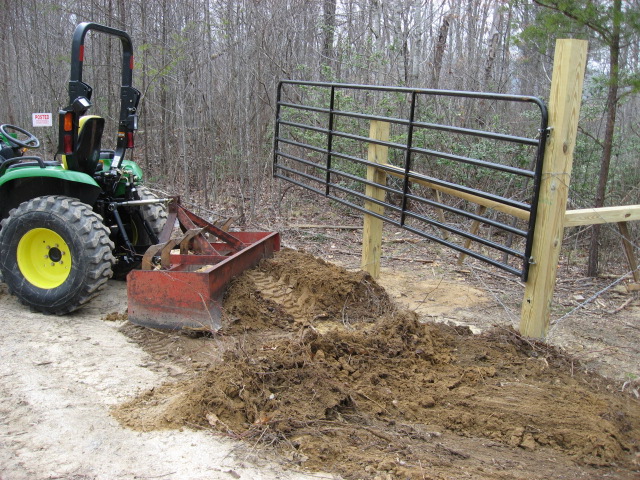

I started out by dragging these piles to the gate.

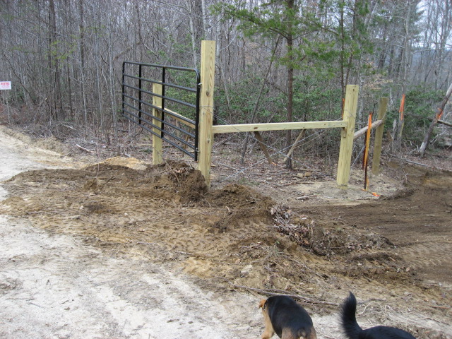

When the existing piles of dirt ran out, I worked on creating a swale to run water down the hill on the right side of the road. I dragged to the gate the dirt from the swale area.

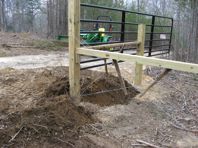

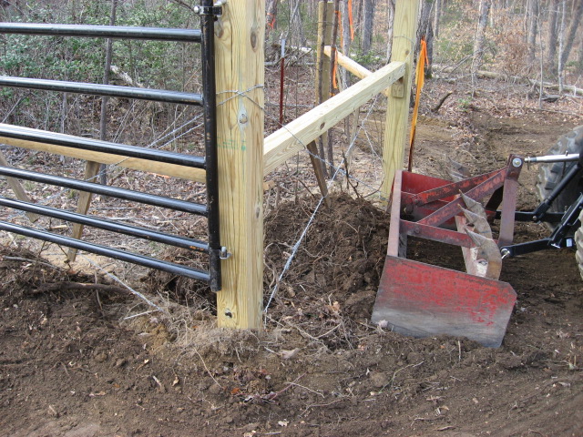

Once I dragged the dirt to the gate, I backed the box blade using it like a bulldozer to push the dirt to the back side of the gate/fence.

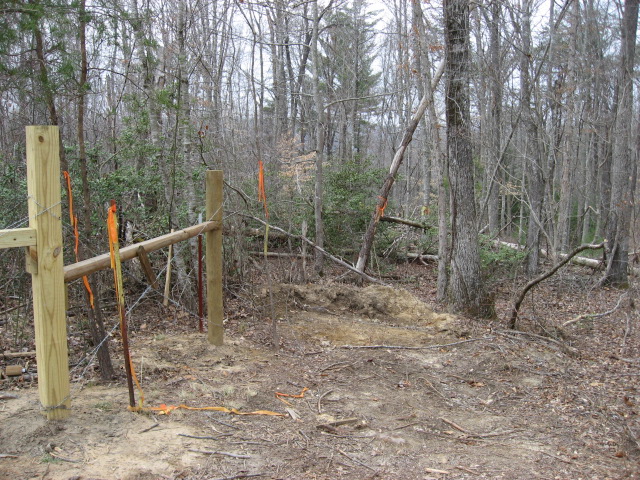

I had to use a pitch fork and shovel to level the dirt on the back side of the gate/fence. I can't get over there with the tractor. Now that I have the tractor, I'm amazed at how long it takes to manually move the smallest amount of dirt by hand.

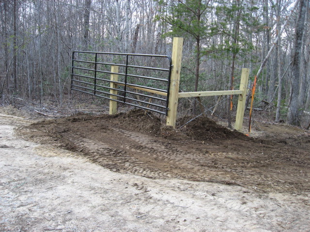

This picture shows approximately how high I raised the road level.
