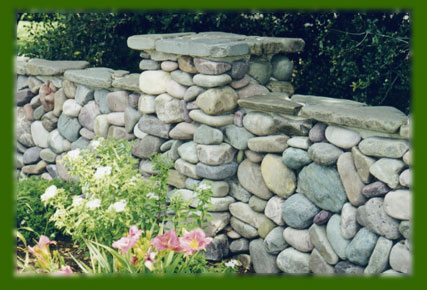

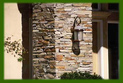

Thanks for the advice and the tips - it will be useful ..... although the way I want to go is a little different than what you did if I'm reading correctly .... at least in terms of the stone.
The front of our house was done similar to what you described - fairly large pieces of stone which were chiseled (?) to have a fairly flat but irregular surface. The thickness (from the side that faces out to inside that is attached to the wall) is probably 2" or 3". The stones vary in size from slightly under 1 sq. ft. to probably around 2 sq. ft. I just don't particularly care for that look.
I'd prefer rounded river rock or a dry stacked ledge stone look:
