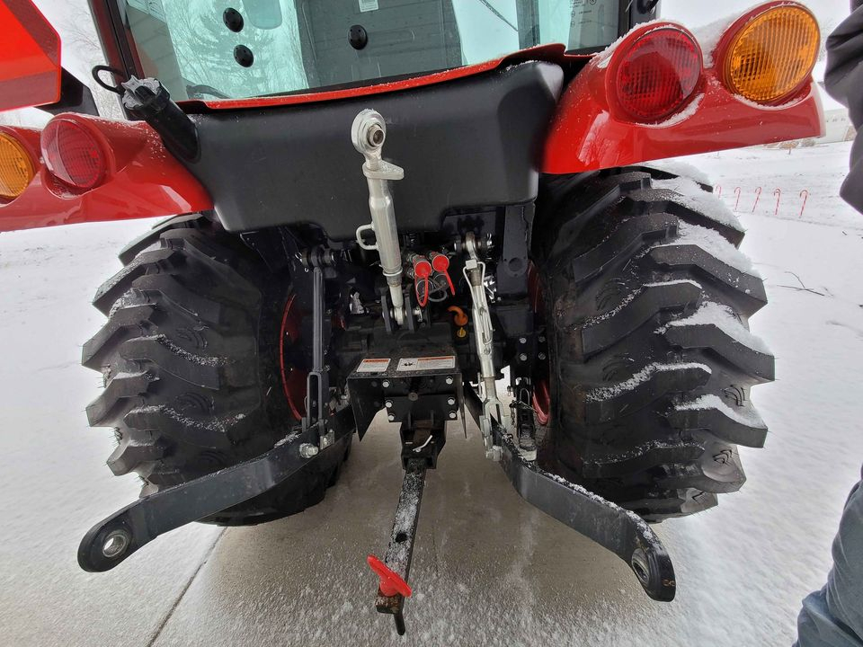

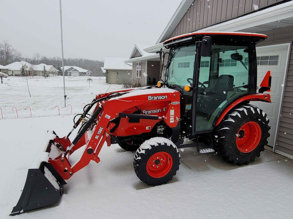

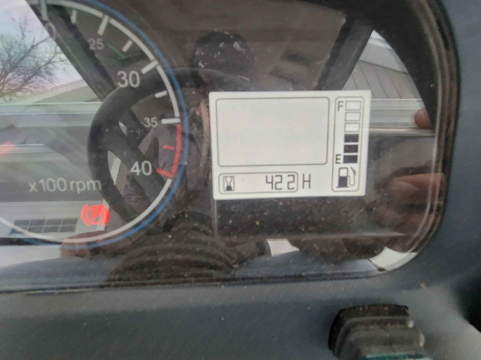

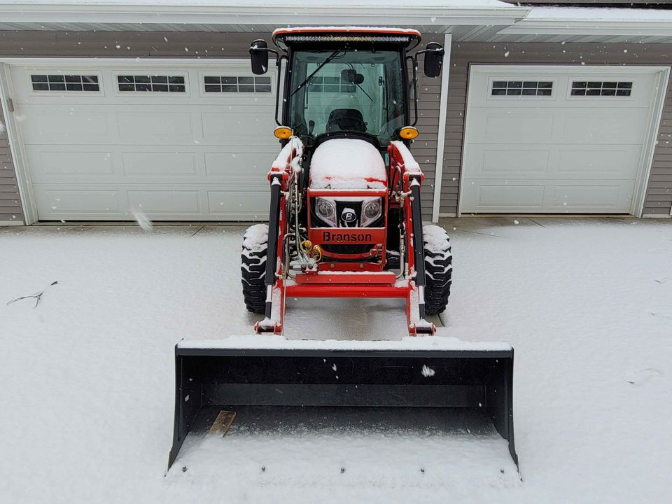

I ended up buying a 1 year old Branson 4215 with 45 hours on it. It has the 3rd hydraulic remote function, engine block heater, CAB with air, heat & radio, 4 cylinder engine, 62" bucket with a cutting edge, loaded rear tires for $31,000 delivered to my door. The loader is rated for more than 2,000#
