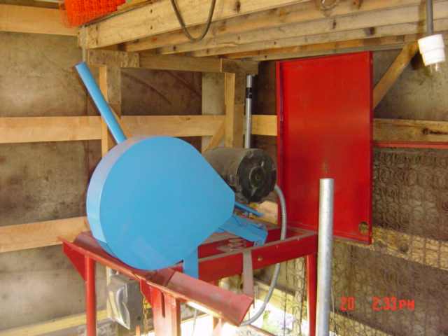

Years ago I built this 18-inch, 7 1/2 horse power chop saw. I don't remember breaking any blades with it. But I worked in a Fab shop that had one just like it. When the blades would break, if the chunks hit you in the chest, it would almost knock you down! :eek:

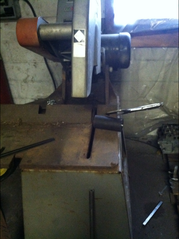

I bought a similar saw at an auction for $160. Mine is a 20" with a 10hp motor. These big saws make a little 12" portable saw look like children's toys. I need to rework the table. Whoever build it put the stop which is a 5" piece of angle iron upside down. image-3454060587.jpg
