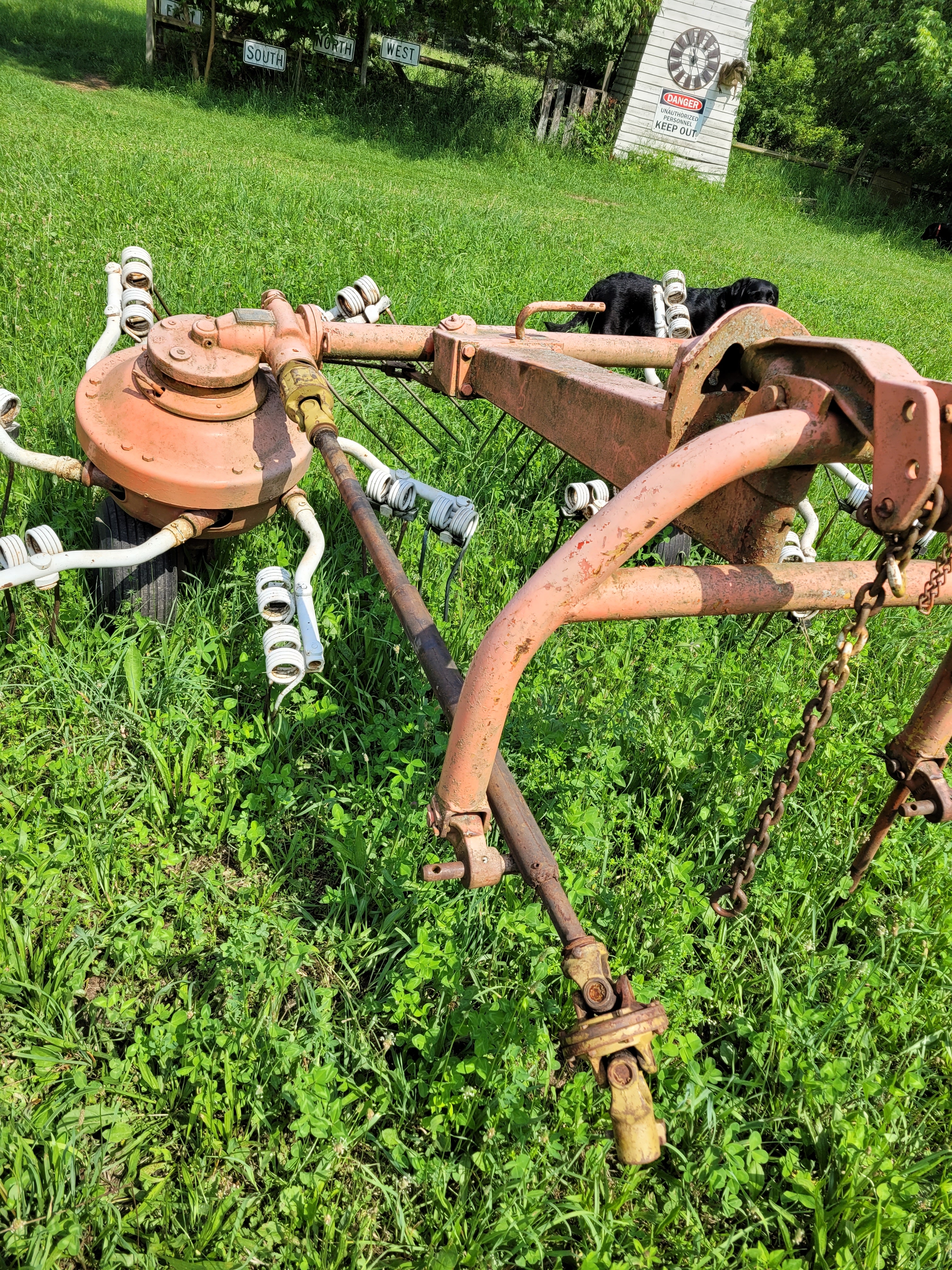

BTW: Here is an example of a non-zero phased drive shaft found in many hay rakes where the axle stub is NOT aligned with the gearbox stub. An angle is installed on the intermediate drive shaft to compensate for the mis-aligned (non-colinear) mechanism. Other examples of non-zero phased shafts are in the steering system of FWD cars. This is needed because the steering column does not line up with the pinion of the steering gear. This condition exists for crashworthiness reasons so a frontal impact does not punch the driver with the steering wheel during a collision.

Incorrect. It requires equal co-linear AND co-planar alignment of the input and output shafts, with the center of the intermediate shaft being over the hitch pin. This is for Non-C.V. jointed drive shafts.

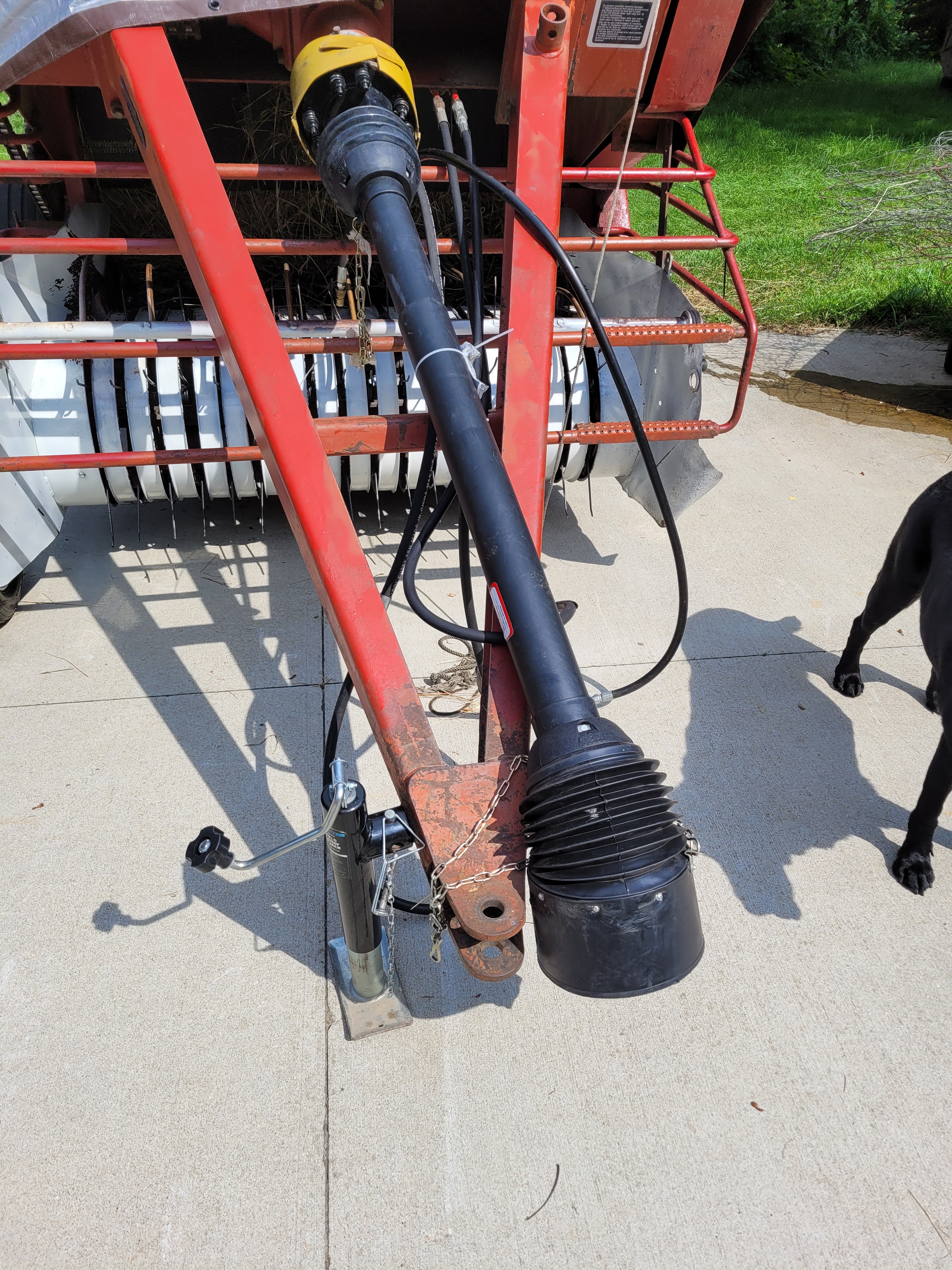

Here's another example of an incorrect installation on a Kuhn combo tedder / rake. The photo shows the driveshaft's C.V. joint now at the tractor end. The shaft has 6 spline 540 type couplings at both ends, so an unsuspecting user could install it backwards (C.V. joint at the implement gearbox). OK in tedder mode, but vibrates more than a pickle in a women's prison when raking.
The second photo shows a baler in a local MarketPlace sale with a gearbox shaft that appears to have been broken more than once. Yep, the guy used a standard shaft hooked up to a 4020 which easily won the contest.

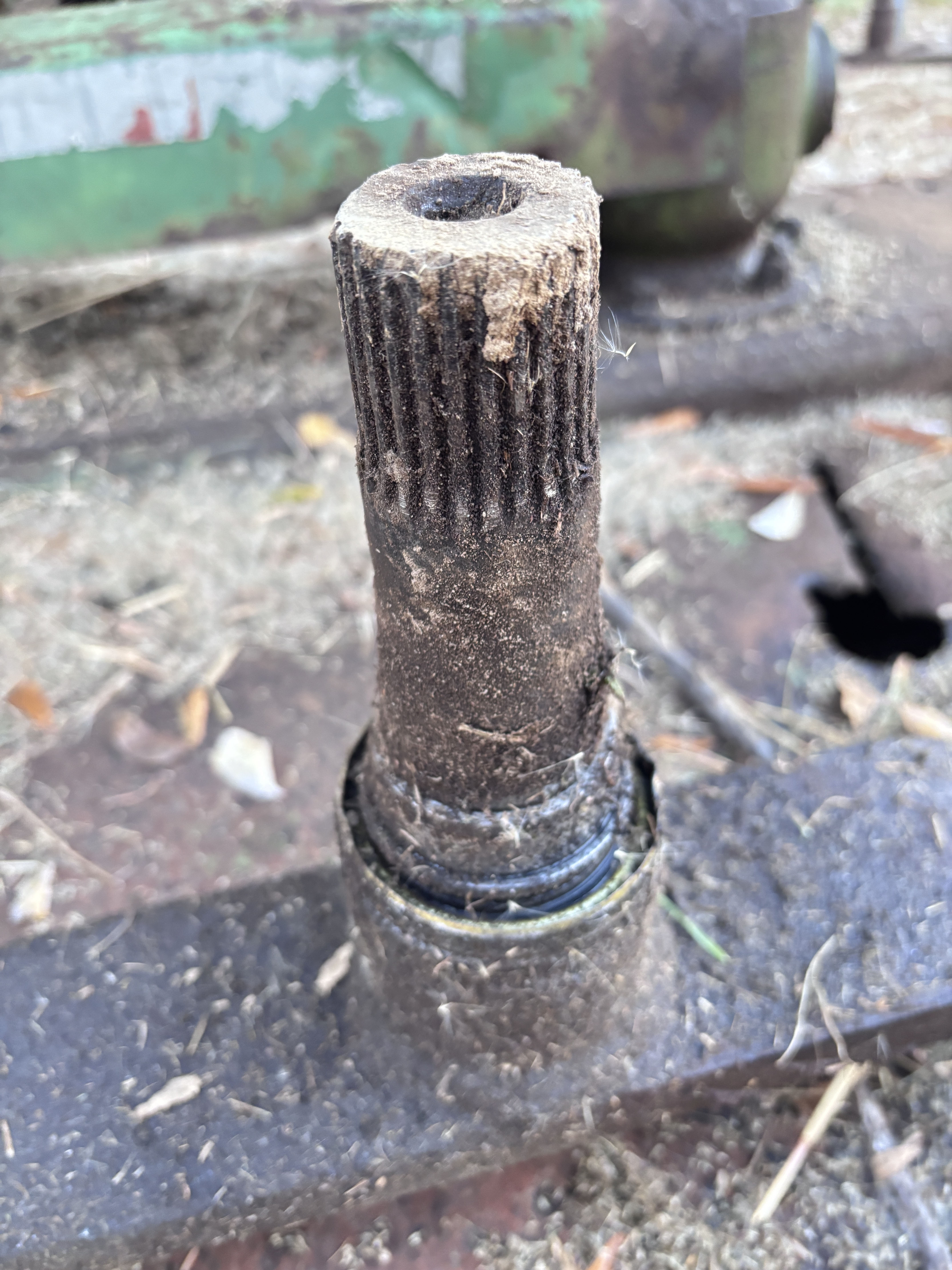

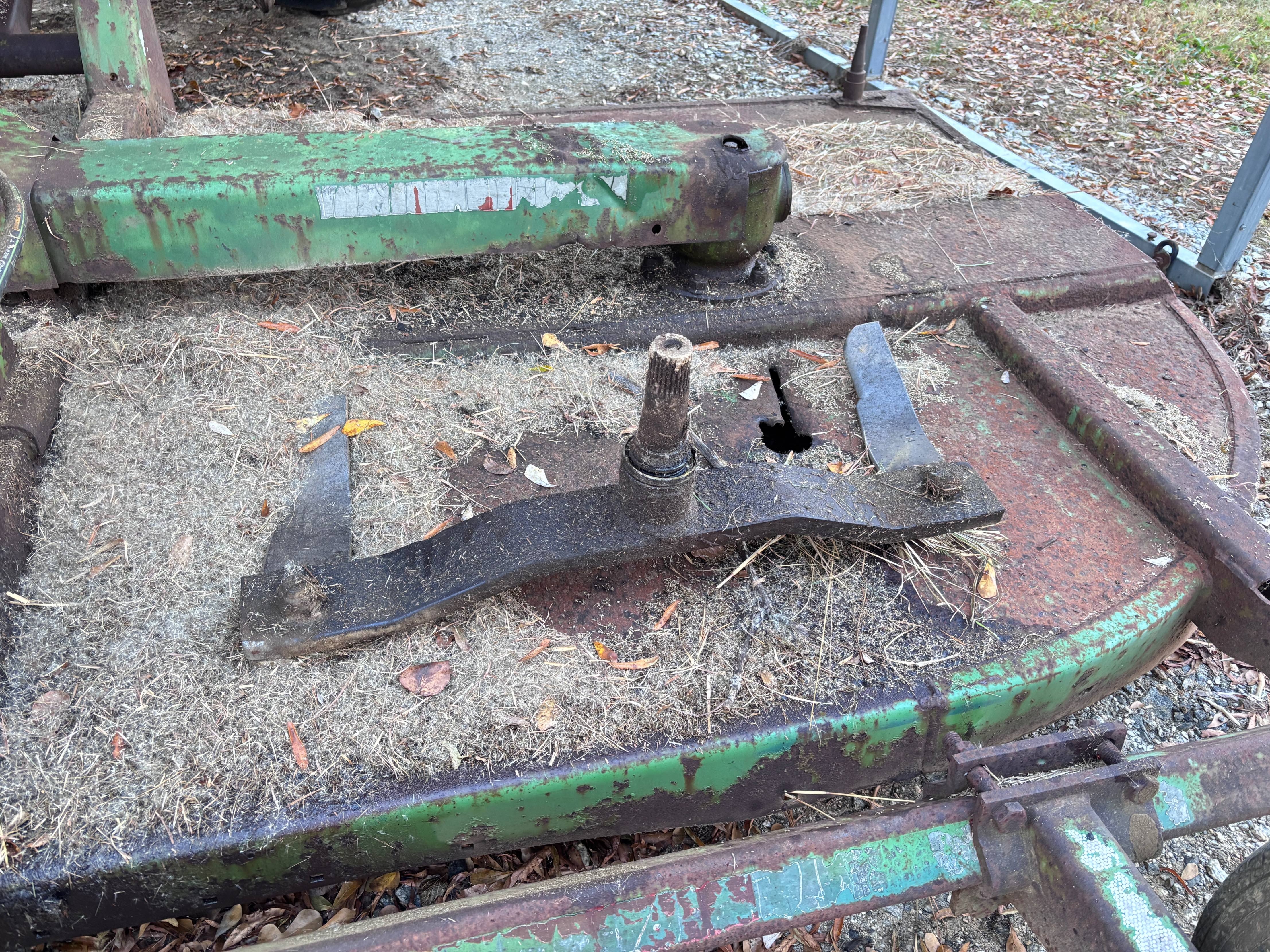

Well I finally got the pto shafts all setup, fixed a flat tire, sharpened blades, and was ready to go. I get 3 acres done and this happened…. I swear I never learn my lesson on buying cheap used equipment. Granted I know this isn’t the end of the world, but the whole reason I went to 10ft cutter is because I don’t have time it takes for the 5ft.
What would cause this spindle to fall out while cutting? And any idea on the chances that I don’t have catastrophic damage to the gearbox? This mower is too heavy for my loader to lift and tilt up. I might could put one wheel on my Deckover trailer and get up underneath there.
I suppose I should just pull the gearbox and see what it looks like.
Thoughts?

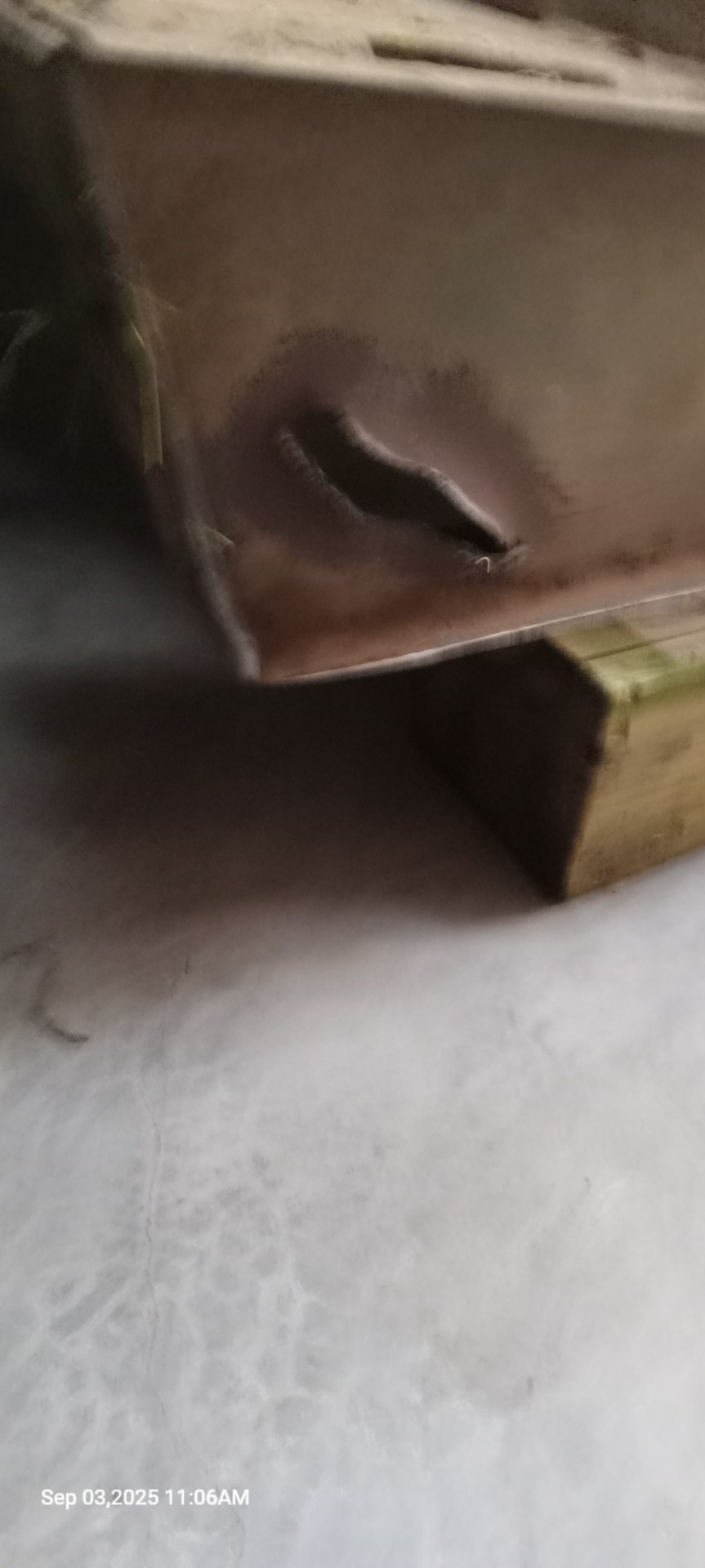

I mean when you buy so used that it looks like it's got rust holes in it yes it's a problem. I'm also hoping that the huge hole in the deck is from the blade flying off.
/ Cutter death trap
#55
Hole in deck is to access blade hardware. Someone did cut a line with a torch, no idea why.

Ok, it took me a bit to get oriented. So that is the shaft and blade that should be below the mower. It doesn't really look sheared to me, but cleaning up the shaft stub will tell you a lot.
Can you open the top or side of your gearbox before removing it? What holds everything together? Is there a missing bolt? Pin?
I realize there is dirt, muck, dust, etc, but was your shaft in oil or in grease?
I found the output shaft for the JD HX10 mower. You don't want to see the price, but it looks different from what you have.
That link is very helpful. Thank you. The shaft doesn’t look sheared. It seems to have just fallen out. I haven’t looked at it closely to see what held it in there, but I didn’t see a pin. The gearbox was filled with a combination of grease and oil due to leaking seals. Luckily I work for a gear shop and I can get something done cheaper than retail if needed. I’ll pop the cover and go ahead and also see if I can get the gear box off of there.
