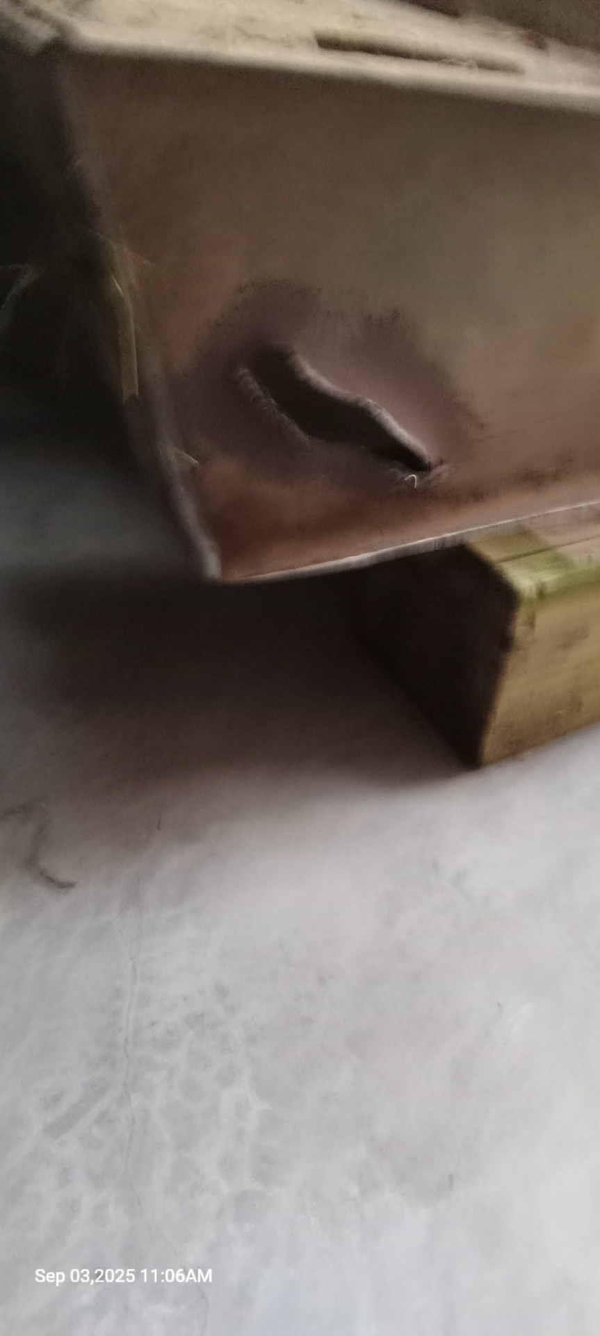

I looked at the shaft last night and it appears that there is a threaded hole going down into it as if it was held in by a bolt and it just came loose. This seems odd, but no pins on the sides of the shaft. I’ll see if I can get some pictures later today

Well I finally got around to taking the cover off. It looks like the shaft/spindle just loosened up in the gearbox. I found the bolt and washer at the bottom. The teeth are a little chipped. Looks like I can just replace the seals and bearings on the cutter spindle and I’ll be all set. The horizontal shaft bearings are a little loose so I’ll do those as well but… How do I get this horizontal shaft out of here. Bearings on each side of the gearbox but I don’t see a pin or snap ring that I need to remove in order to replace those bearings and get the shaft out..

Does the shaft go clear through on the left side of this pic?
If so a big hammer and a large brass punch, to drive it out of the pinion gear and on out.
/ Cutter death trap #67
That doesn't look as bad as I thought it might. Looks like you have a 1418 Rotary cutter. Here are a couple links for parts. One to John Deere and another after market. Looks like the nut came off the shaft end possible because of bearing failure? The bevel gear doesn't look terrible. Hopefully with some bearings, seals, and maybe a nut a retainer you can reassemble and be back in business. Check the other gearboxes though.
